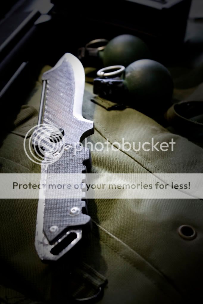

Here is a pic of what he says is "Almost Perfect" in matching the description (But he claims the one in the pic is photoshopped and fake). If you want to call him stupid, just let me know, I can take care of that! :D

What is that on the back of the knife - a potato peeler?

Check out the Fox Stealth CarbonTitan. It uses Ti and Carbon fiber to form the blade. He could have heard or seen this knife or something like it but is misreading or just has some of the facts wrong about it. Maybe he's mixing up characteristics of Carbon Fiber, Titanium, Ceramic and blending that with what he has seen in one of these highly specialized Military/EOD knives.

It sounds like what he is talking about is something from Warren Thomas. He makes carbon fiber laminated titanium blades with a carbide edge. That's my best guess.

here's a few pics of my old collection of WT. I still have the green one and am getting three other Wts.
