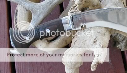

khuks have great handles, but just a tad too small for my hands for everyday use, however ive heard that the HI khuks can be obtained with a slightly larger handle??? the only one ive held/used belongs to a friend of mine, and its about 80 years old.
