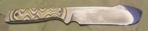

I like to do scales with the pommel exposed, a slight variation of the full tang.
example
