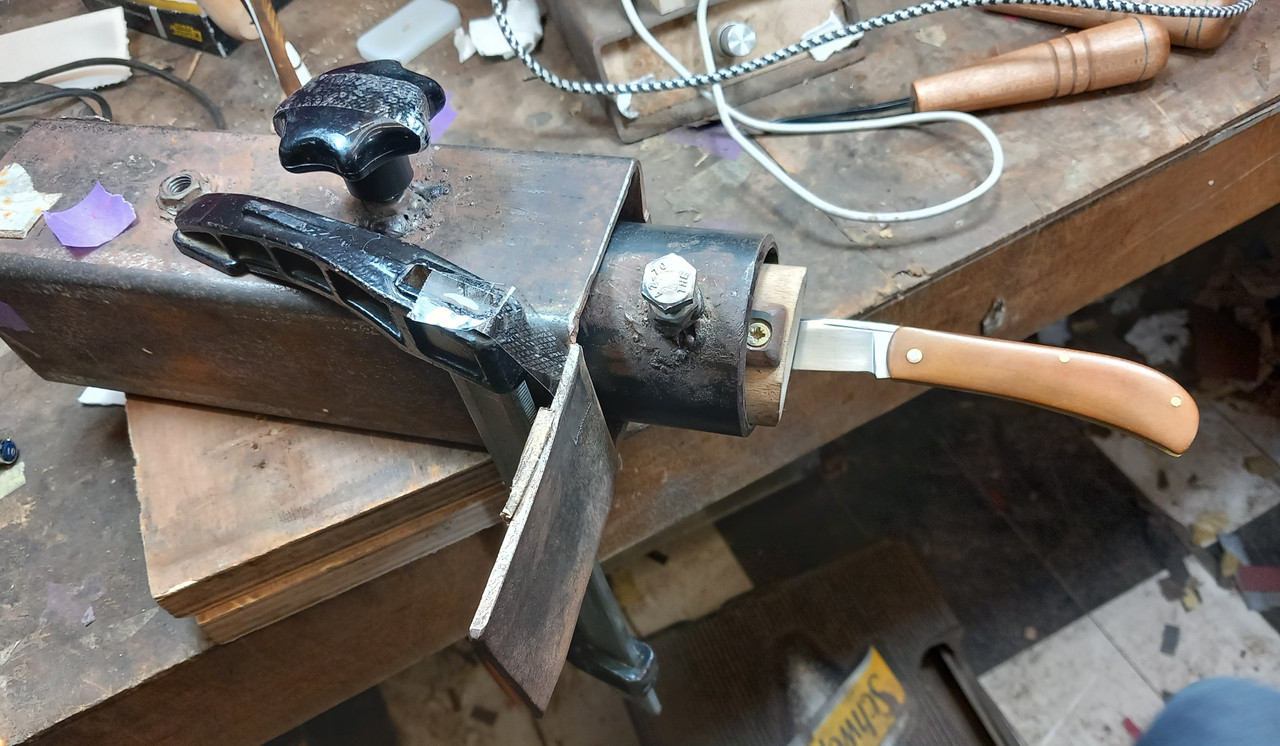

Hi, everyone. I'm wondering how people hold completed (peened together) knives for final handle finishing. I've seen those cool vises for fixed blades, but I don't think that would work well for a non-locking folding knife. I also imagine that for screwed together knives, you can finish the components separately and then assemble. Mounting a fully-assembled, contoured, knife so that you have full access to one side of the handle is pretty tricky. I don't really like my solution (metal bar + lots of tape), so I'd love to hear how other people do it. Thank you.

I've only made a few slipjoints and I used the fixture I made for fixed blades. It is not perfect but doable
