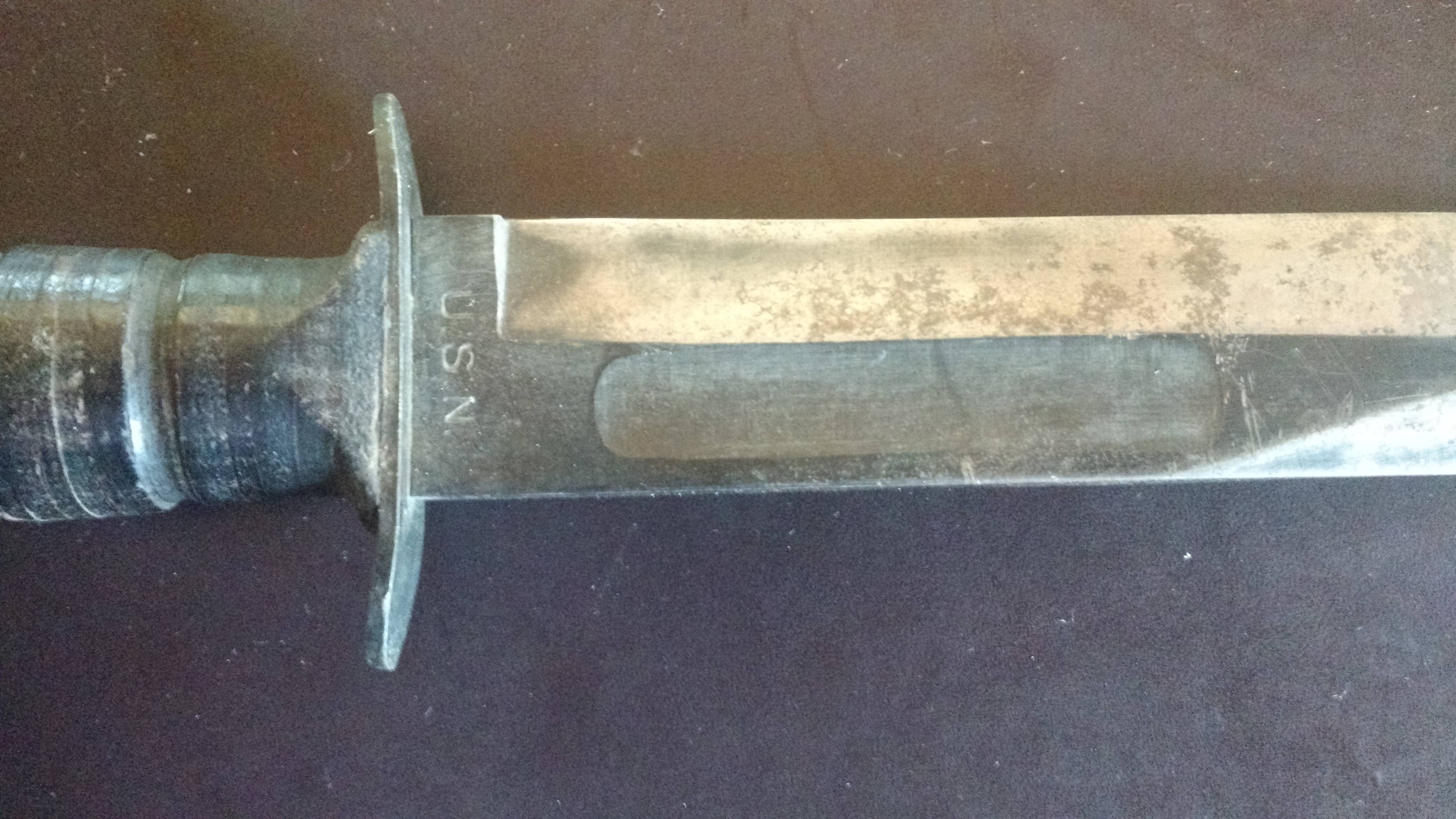

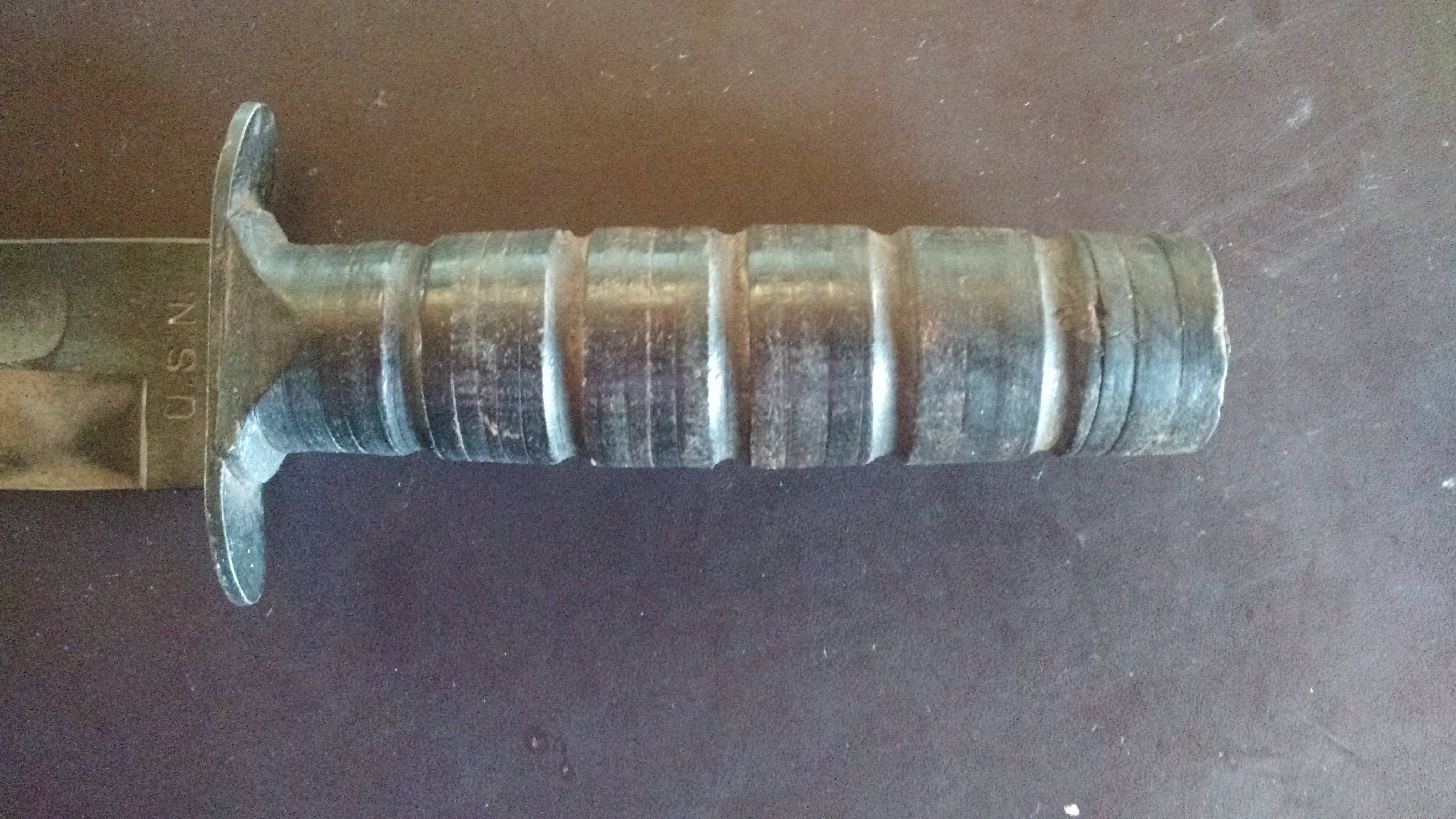

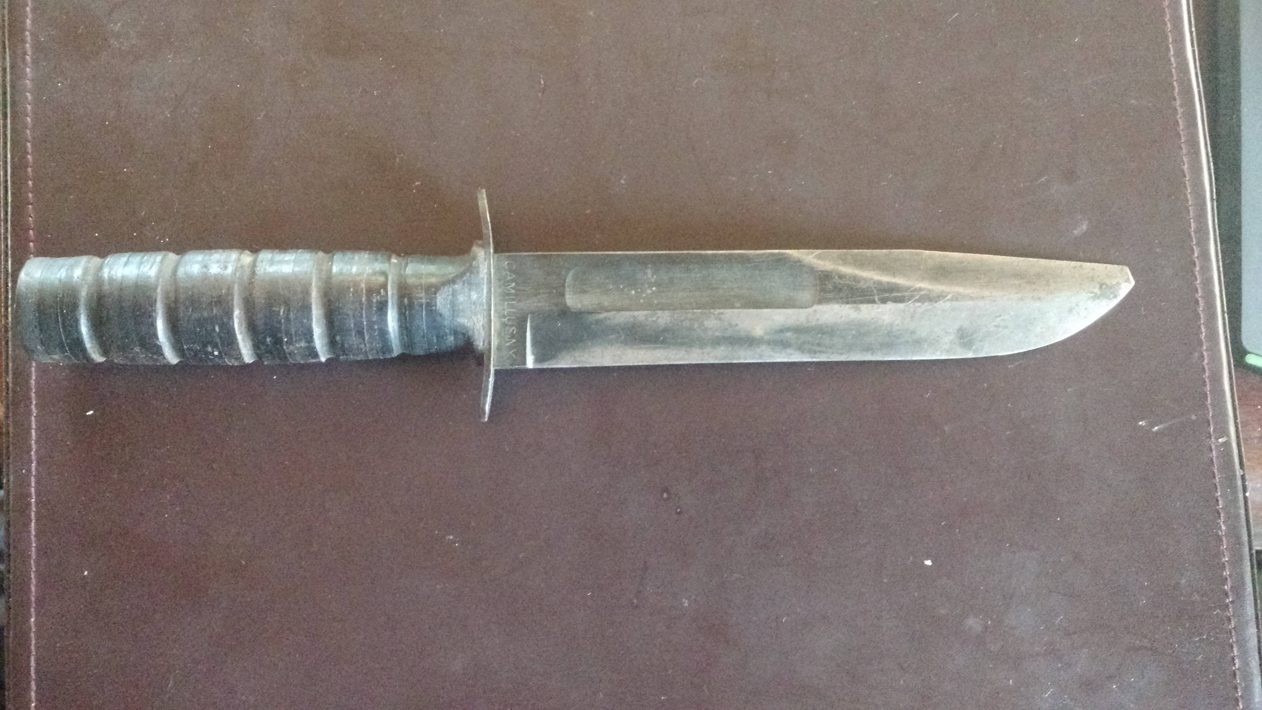

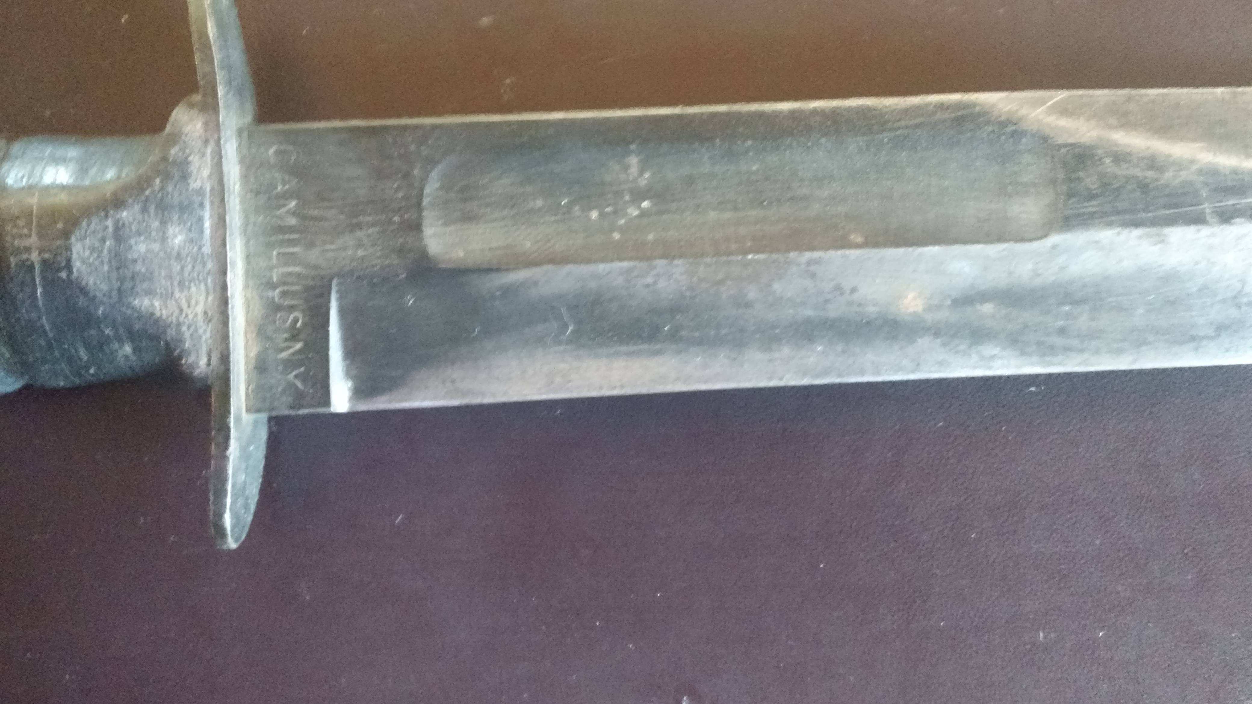

Can someone help me identify/date this knife? Most of the Ka Bars I have seen have different markings than this one. There is no stamp on the blade guard and it only has the U.S.N stamp on one side and the Camillus, NY mark on the other side. No MK2/Mark 2 stamp on it and no scabbard.
Also, would it be fairly easy to but a pommel on it somehow? Thanks.

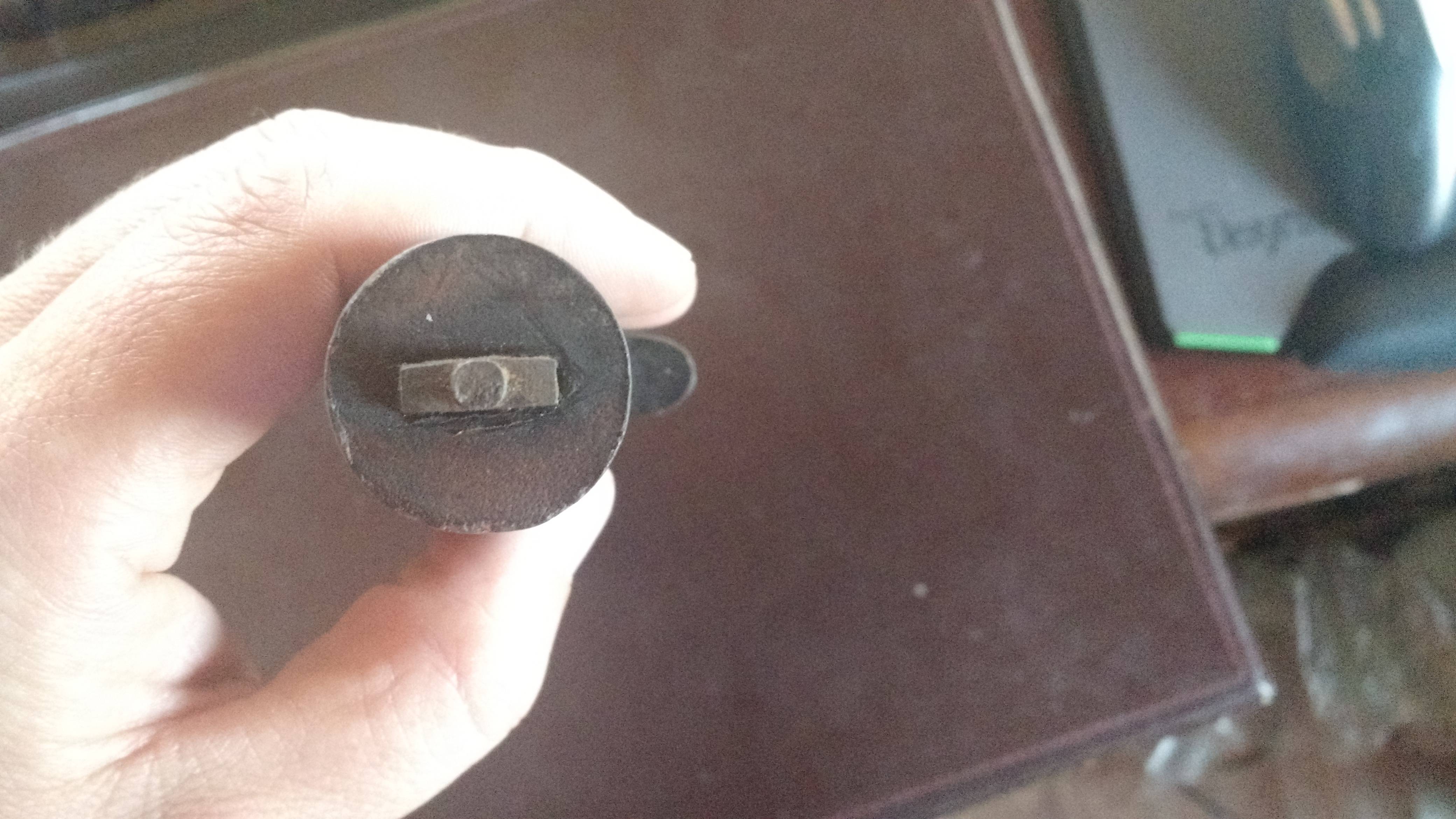

Looks like an example of one of Camillus's early MKII's. The image of the back end of the knife seems to show where the end of the tang was finished in a round stub. These were threaded and the pommel was counterbored to except an attachment nut. What you seem to have is why Camillus changed the attachment method to keeping the tang rectangular and cutting a slot in the pommel. They attached the pommel to the tang with a cross pin. This method was eventually adapted by the other contractors for this knife before the end of the War and ended up becoming part of the knifes official specification.
There would be a few ways to rebuild the knife. IMHO I'd remove the leather from the tang and add some steel to the end of it to get it to the original length, grind and file the weld down to the original dimensions. I doubt you'd have much luck finding an original pommel and nut for this knife, and given the tip damage I'd not be too inspired to pursue trying to put back in the original configuration. You might see that differently thou. You can sometimes find the right type of pommel on Ebay. Just be sure before you buy that it has the dimensions you want. Also with the dimensions you could make it from scratch if your inclined that way.

That's great, thank you for the information. So it is an early version KA-BAR 1217, possibly around 1940? I would like to put a pommel on it somehow for sure though, but like you said, it wouldn't make financial sense to spend a ton on it with the tip damage.
If one of the KA-BAR guys sees this and could send me what I needed that would be ideal. I'll also search ebay. Could I most likely put it on with basic hand tools I have?

Like sactroop said, these had pommels that screwed on and then backed up with a slot nut. These knives had 2 weaknesses - split nuts and pommels unscrewing or the tang breaking off right where yours did - at the last thread of the threaded part of the tang.
Thanks for the information. I didn't realize the tang was broken off. Would it even be possible to put a replacement pommel on it in this condition for someone who isn't an expert?

If I had that knife, being not exactly the sharpest knife in the drawer, I would
0- gently remove an inch or so of the washers
1- weld a small piece of 1/8" mild steel rod onto the broken tang (protecting the remaining washers from the welding arc),
2- cut out a new pommel out of 3/8" mild steel,
3- drill a 1/8" hole in the new pommel,
4- cut the rod that stuck out to about 1/8" proud
5- replace the washers and put the pommel on the tang,
6- clamp the blade in a vise (with some leather pieces to protect the blade)
7- peen the proud tang tight
8- grind the peened tang a bit to smooth it out.
You now have a refurbished "almost version 2" Camilus 1219C2 - The first change order by the Navy/Marine ordnance folks was eliminate the screw pommel/split nut and peen the pommel tight onto the round tang.
The other, less time consuming fix would be
0- order replacement pommel and pin from Kabar customer service
1- find a friend/relative/enemy to weld a small piece of 1/8" mild steel to the tang where the original pommel broke off
2- file the added piece to fit the slot of the replacement pommel
3- drill a hole in the added tang segment to match the pin hole in the replacement pommel
4- put the pommel on the modified tang and slide the pin into the pommel pin hole, and through your hole in the tang until it bottoms out
5- cut off any excess pin, peen it over gently and smooth it out
You now have a current Kabar 1217 pommel assembly on a WW2 Camillus 1219C2

I like these (what should I do with it) threads. It's interesting to see everyone's personal take on it. Zzy, gave you some good approaches to use. I never considered putting a peened pommel on a Camillus 1219C2 since they didn't do that originally, but then again you could. I'd recommend practicing the peening on some scrap before doing it on the knife. It's a little bit of an art getting good results by hand with that. KA-BAR can get a solid reliable connection with a blind pin using their equipment. If I was putting a knife back together I'd modify, (drill thru), the pommel and use a thru pin peened on both ends. It's both easier to do at home and get a solid connection that won't slip out over time.
