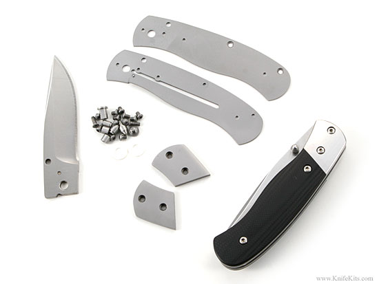

I'm curious about what goes into making a kit folder. What is left unfinished?
Do you simply assemble the knife, or do you have to make the parts yourself? Is there drilling, tapping, milling, grinding, or shaping involved? What's the difference between a kit and a modified production knife?
I might be able to help you with handle logistics. I simply don't know what goes into a folder kit.

From what I've gathered, final fitting and assemply on most basic folding kits. There are lots of folks who take it one step further and do a bit of embellishing, but the kits can be made in their most basic form into a functional knife.

Well thanks to this thread I just spent like 2 hours browsing www.knifekits.com. So many cool kits to choose from, looks like you could make yourself a really nice knife for $50-100.
The kits actually have a rated "difficulty level". From what I've seen, the level 1 kits you basically just assemble, level 2 you do the finishing of the handles, and they seem to go up from there. (having to drill and tap or bend the lockbar, etc.

I've finished quite a few over the past few years.
Even the simple framelock kits can be embellished to great extent.
If you buy the kit as is with the scales predrilled it is incredibly easy to assemble , but it will look very ordinary , the whole knife is beadblasted a dull grey.
With a few hours , some tools and various grits of paper and some imagination you can make it look pretty darn decent.

I built one of the DDR-3 Kits a while back. I was on Shimya in the aleutian islands. I had only basic hand tools and I got the kit with pre cut and drilled wood scales.
I was able to assemble the kit in my dorm room and finished the scales with a dremel tool. It came out OK but looked very plain and needed polishing.
I gave it to my dad for xmas and I am going to try and get it back now that I have quality tools to work with. I want to do it over again and polish it up real nice and change the scales.
Over all I would say the kit can be anywhere from average to spectacular depending on what level of work and time you expend on it. It is a solid knife when done. If you want to embelish it make sure you get the optional back spine.

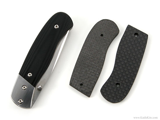

Any experience with the DDR2-MB kit?
I'm thinkin about picking one up and some CF scales, maybe a cool looking thumbstud, attempt some file work on the backspacer/spine and I could have an amazing knife that I built myself for under $100.
I've never done ANYTHING like this before, but I am fairly mechanically inclined. How difficult is it to do things like filework, polishing the blade/backspacer/CF scales?
Is it as simple as some fine sandpaper and then polishing compound + dremel?
Seeing as they're already profiled and drilled, hand tools are all you need.
Laminates work easily with files and sandpaper. Be sure to use a quality respirator and/or work under a flood of water. CF dust is really bad for you.
A hand-rubbed finish on the metal parts wouldn't be too difficult. There is a lot of info about that type of finish in Shop Talk.
