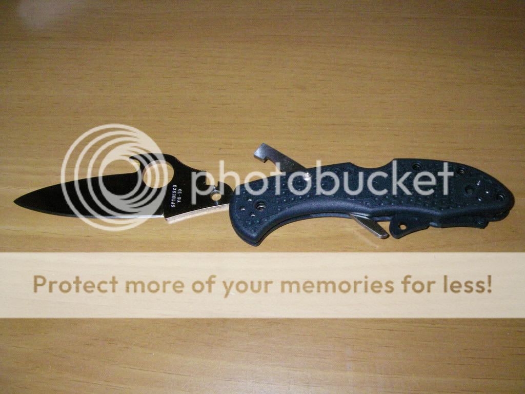

Here's a pic of my lockback Delica. I had it apart already, so I figured it would be easy to take a pic for ya ;)
I also heard the other guy say "lockbacks are the least reliable." I don't believe that. If you look at my picture, you can see how the lock contacts the tang. It kinda "hooks" into it. As you push on the edge (as if you were cutting something; the opposite of spine-tapping), the force vectors seem like they will be going 90º against the lock, and maybe where the "hook" is "hooking" into the tang. While cutting, it looks like the only way for this to break would be for the lock's bolt to break off. Pretty tough, from what I've seen.

great pic of the delica, cheers...thats what i thought a lockback mech looked like. (are they also call "notchbacks by any chance?)

Lockback - You see in the pic :)

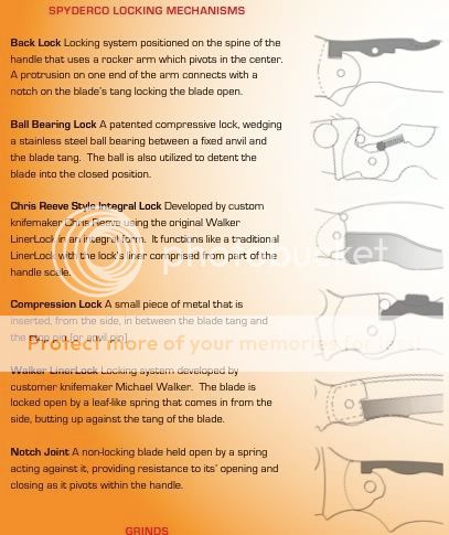

Edit: This is from Spyderco's catalog. Seems like the "notch lock" is similar to the lockback, except it doesn't "hook" into the tang. (Edit again: Why! That's a slipjoint lol; it isn't exactly even a "lock.")
fewer parts than a lockback.

thanks for the catalog picture! I just flipped thru my spyderco catalog an saw that, cant believe i missed it before....:o
