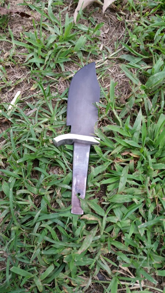

That's what I would have preferred, but the tang was cut to 3.25 inches and a full want is now out of the picture. I am thinking if I do a stag handle, I will drill it out and backfill with epoxy to set it. But I am now limited to what I can do for a handle since it was cut for a hidden tang. I will put up a picture when I get home from work

I know it's. Or the best picture for reference but the tang is smaller than I would have wanted for it. But I love the blade and want to make something useful out of it just not sure where to go with it now.

Ok i was confused, I thought you meant the antler wasn't long enough. That knife looks cool! A file guide haslots of uses but a big one is squaring up the shoulders to get a nice press fit with the guard but looks like you've got the guard fitted already. Wow you took on quite a project. Woodcraft will have the longer bits.
I did but I like a challenge. If I can't make blades yet, I'll at least do all that I can. Will stabilized wood be strong enough when using the knife? What would your first choice of material be for a handle. I have some other threads up for advice but haven't gotten any hits yet. Thanks for your help so far
My first choice would be koa, but it's expensive. I just love how it looks. Have you looked at the wood suppliers in the exchange? They have sales and a good selection of stuff. Just look at a bunch of the pictures of bowies and see what you prefer.

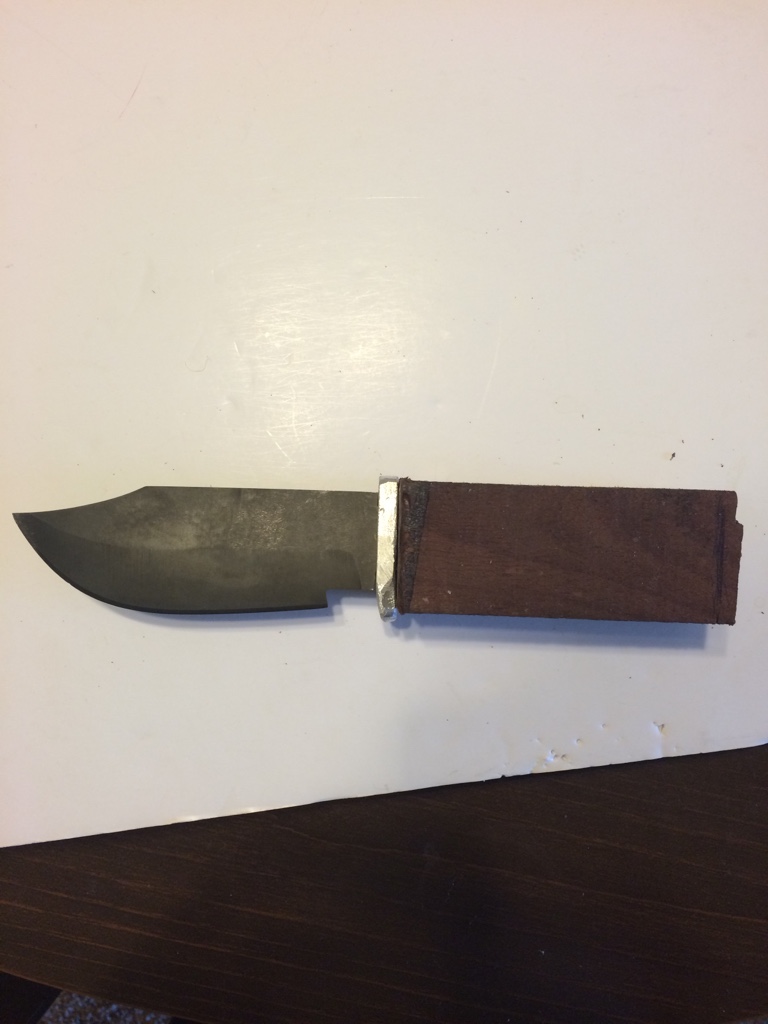

Here is what I have so far. Snug fit cut through. And the guard is fitted and shaped. Now all I have to do Is epoxy and pin it then shape the handle......by hand with files

Did you mark an outline of the tang and hole location on the outside of the handle? You may have, just makung sure so you can precisely spot the hole for the pin.
Nick Wheeler has a really good video on this. I'll find it...
https://youtu.be/Km-A8ozFTLU
That helped a lot. Gave me some good guidance. Hand tools just make it challenging.
Now that I have these tips I started over and am making the pattern a doing it right
