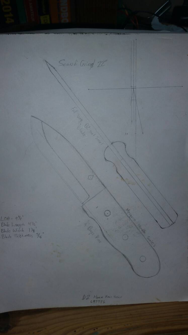

Hello all. Ive been reading this forum for about a year after my brother turned my attention here when i got tired of having a new broken knife every couple of months and decided to turn my attention to making my own. I know that my use of a knife in many, if not most cases, classifies as abuse. I also know its never gonna change. Thats a cliched "is what it is situation". But the way i see it, if i'm abusing 20-40 walmart knife, then i am not hurting anyones feelings... if I bought a good knife, such as a WAS, or a Fiddleback knife, I would be disrespect the the designer and maker in my abuse. However, if I design and make the knife.... well thats the purpose.... For me to abuse the crap out of it, and be able to make another when I break it; then at some point when I have a bullet proof setup, maybe start selling them.
I have a design based off of several knives I have owned and/or played with. Its about 9" long, 1 1/4" wide, and 3/16" thick, full tang, with Live Oak scales. The problem is that I think I want to use either O1 or 1095 steel, but I dont actually know. Is there a better steel for a tuff as nails, but easy for a beginner to make, knife?
I have a full woodshop, with a few metal working tools available to me, including scroll saws, belt sanders, side grinders, angle grinders drills drill press, ect. Will a scroll saw cut the curves in the steel before it is heat treated? If not, what is my best option to cut it?
For a 3/16" finished thickness, what thickness ruff stock do I need?
As far as heat treat, I was planning on a charcoal forge with a hairdryer and pvc for a blower, magnet for finding critical temp, and vegetable oil for quenching.... reason being that is all I could probably convince swmbo to allow me to live through paying for on the first one. Is that hot enough for O1 or 1095 steel?

1095 and O-1 both require a better HT than you can do with a simple charcoal forge. It would be a far better idea to get the HT done by a more skilled maker or a professional HT provider. Texas is full of people who can do it for you. Cost is about $10 for a carbon steel blade.
Post your drawings and ideas. Having some experienced eyes look them over can help avoid any problems later on ... especially if it will be a rough use knife.

If you want to do your own heat treating go with 1084. You will get better performance from it than other steels unless you send it out. If you send it out it doesn't matter so much.

Depending on what you mean by "rough use", 1084 SHOULD suit your needs decently. Heat treat is of course a major component of "toughness", but geometry, profile, and general design will also play a factor.
If you give is a better idea of what your idea of "use and abuse" is, as well as post some pics of your designs/drawing, you will likely get some more refined and specific suggestion.
I'm a carpenter, mechanic, avid outdoorsman and life on a ranch. My knife gets used for skinning, cutting, carving, chopping, batoning, etc. It get used as a pry bar, an hammer, pretty much everything but a screwdriver.
What I am wanting to make is a bushcraft style knife with a scandi grind, 4 and a half inch blade, 3/16" x1 1/4" full tang, three brass pins to hold the live oak handle scales on....
I'd post a picture of my drawing, but I don't know how to do that from my phone.

The easiest way to post a pic via your phone is with the Tapatalk app. Aside from that, I believe you can go though the standard process of inserting a picture via your phone's web browser as if you were on a regular computer.
I couldn't figure out how to do it the browser, so I finally put this app on.
