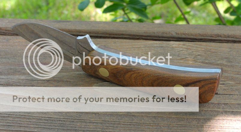

I've assembled (I don't say "made") over a half dozen knives this way. It is fun and you can be proud of the finished product. It takes me 6-10 hours to do one. I use a Sears 4" belt sander for my shaping, then do a lot of hand sanding. You can use files and wood rasps too. I don't have the patience to do all hand sanding and have to use the belt sander.
My most recent one:
My most recent one:
That looks great and very similar to what I imagined this process was like in my head. When I say "blank" I guess I was referring to a "skeleton" knife. Forgive me if I'm using the wrong terms - like I said this is sort of my entry into actually wanting to tinker with/assemble a knife. Do those Corby bolts just sand right down as well?

My most recent one:
That looks like the one I'm going to start soon... is it the Oregon skinner?
