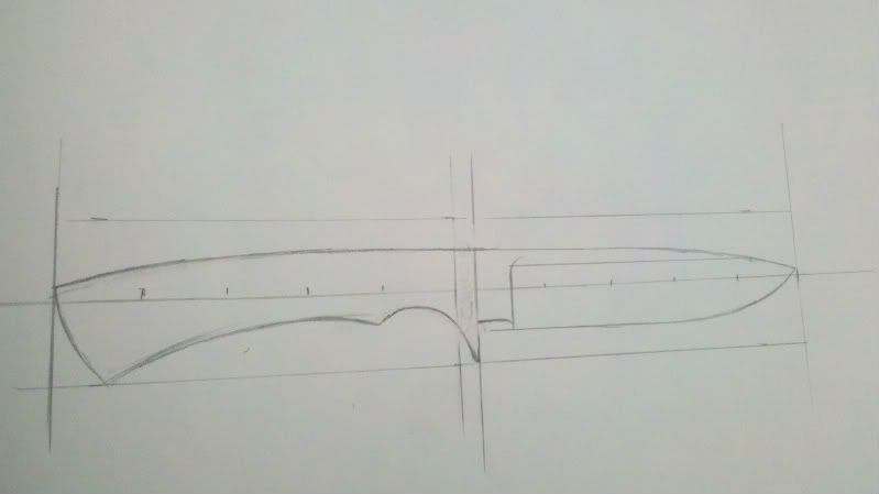

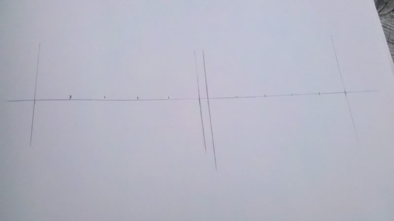

Ok so as i said earlier, i did a small, not so good tutorial. To do this i start with a clean piece of paper, draw a center line then i think of the overall dimensions i want the knife to end up as.

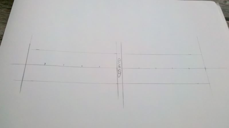

Ok after determining how long i want this to be, i determine a width...In this case it all fits in a probably 1.75 inch field.
Then i draw in my rough shapes...blade, handle and guard. Once you get the curvature you want, you can tweak the design with an eraser.

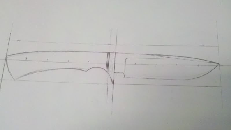

I start cutting my designs in a little bit. Clean up the lines, add where i want the bevels to lay, add width to the cutting edge, etc.
Finally i decide where i want the pins to lay and the final shapes. After all of this i make a photocopy of the original so the master copy stays put in one of my drawing books.
Like i said, it is nothing fancy but it might help some of you get the design aspects worked out a little faster.
Thanks for looking
Mike D.
