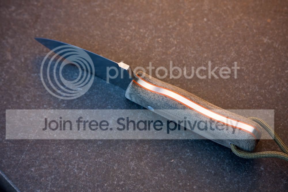

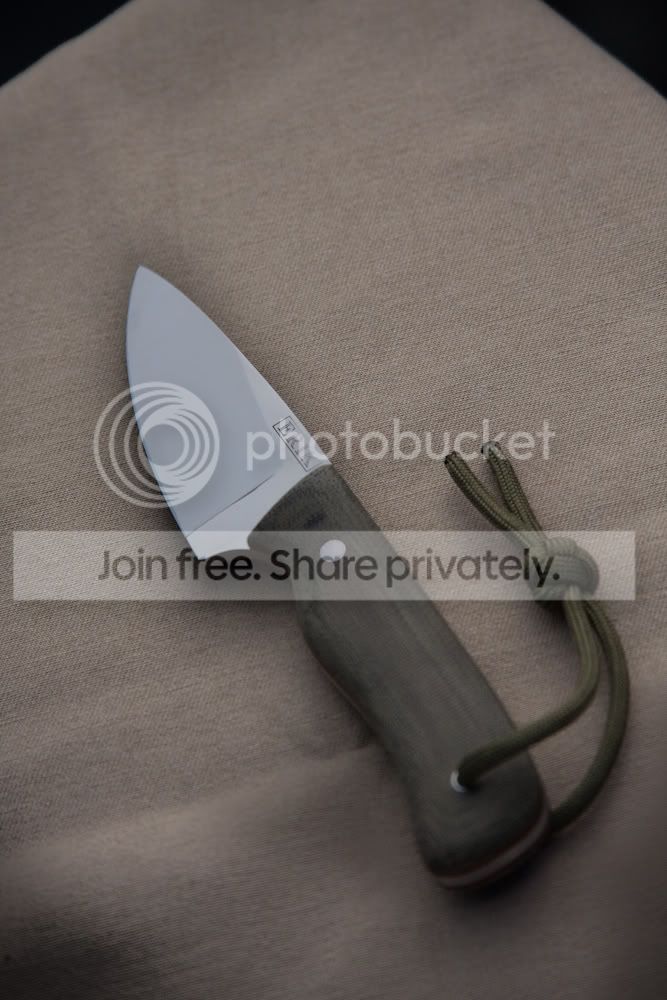

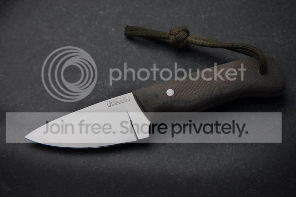

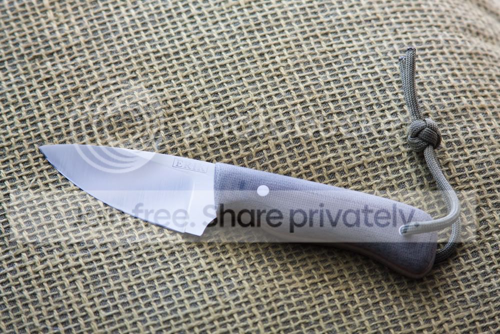

I took a bunch of different photographs of the same knife today. I was experimenting with different lighting approaches to try and find a winning combination. I didn't find one I liked very much and although I used various combinations of artificial and natural light, I shot them quite similarly in regards to the direction of the light sources.
I also tweaked them a bit for exposure and contrast. I'm not showing these because I think any are great or even good examples of photography. They are quite bad considering what I was trying to do. But, they do show some interesting differences. The same knife with different light sources and backgrounds changes color. The machine finish shows, or looks washed out, or might be confused with polished, depending on the image.
Obviously, none of these pictures "pop" the way the pros pictures do. I need to get better at photography and knifemaking.
Some of the professional pictures almost look too good sometimes. I think it can be a fine line, and I think most of the professional photographers know how to walk it. I have seen knives in person that warrant some amazing images.
I have also seen maker's pictures that show an amazing knife and then the owner posts his own snapshot and it looks like a very different knife. The trick that eludes me a bit is getting a photograph that compliments the knife, shows it in the best "light." Not one that makes it look better or worse than it could look in ideal conditions in person.
I will make a light box and see how that changes things. If my stamp looks uneven - that's not a light trick, it is uneven. :)
Hey Erik, I think the photos look great. They are a good example of reflecting light of different angles of the blade. one angle will show the grind line, another shows the depth of the handle. I have found that if you have a good flash that can be moved to different directions. Bouncing it off the ceiling is the best for soft light (Similar to a Light Box). Another thing I messed with while taking photos of Mike Davis' latest knife was to reflect light off the blade directly onto a large Black background to bring out the Hamon.
Hi Erik,
As long as your white balance is set to the proper setting and your exposure is good (not over exposed which will product washed out detail or underexposed, too dark) you should be alright. The idea is to achieve an image that still has detail, or in digital terms, information in the highlights and the shadows (exposure) and to make sure that the color isn't shifted (white balance) A light box, or in photography terms, a soft box will definitely help. That said, a good number of product photos are taken using some combination of diffused light that a soft box produces. An overcast day out doors will also produce very similar light and is probably the easiest answer for you. Personally, I use a flash head with a soft box for most things or a flash head pointed at the ceiling (white ceiling) for quick shots. Hope that helps....

Thanks Ryan and edge. I'm going to keep experimenting. I have always shot with auto white balance - I will play with some other settings, and - build a box.
Erik

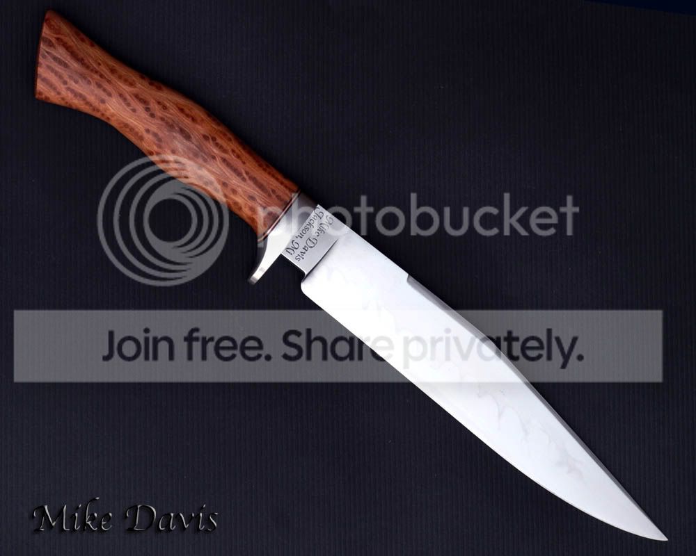

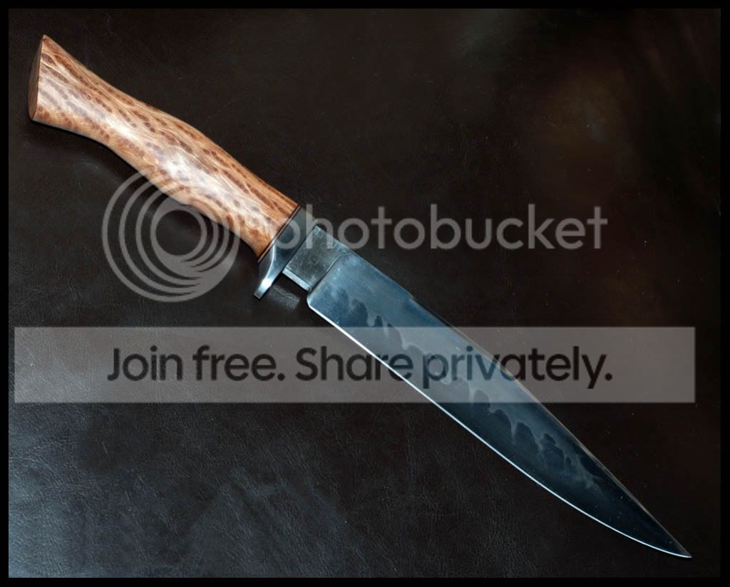

A trick I use a lot is to set up black screen light booth. I take garbage bags and spread them across wooden frames then reflect the light off of them and onto the piece. Experiment with their positioning. It is difficult to explain.
I don't want to hijack your thread, but Rick and I are talking about the same thing I think...
Here are a few examples of what the black (Reflecting in the blade does).
Knife is made by Mike Davis (Hope he doesn't mind)
without the black reflecting on the blade
That's it man! If I bring the frames outside and position them correctly, I often don't even need to have lamps.
