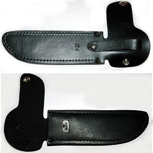

In a recent thread, Lawrence Helm mentioned how his 119 and 124 rattle in their Buck sheath. I noticed this rattle too with my 1970s Frontiersman, so I added a leather tie down, which fixed the problem. For this style of sheath, I simply ran a leather lace through the belt loop and used a small steel ring as a slide. The ring adjusts the tension and it is not necessary to loosen the ring to remove the tie down from the handle. The leather lace simply slides up and over the pommel. This extra step doesn't add much time at all when unsheathing the knife and the tie down isn't bothersome when not in use. It just hangs out of the way behind the handle. The tie down also acts as a secondary retention strap incase the snap is accidentally disengaged. As you know, the swivel sheath offers no retention through friction fit, which is what causes the knife to rattle in the first place. Perhaps this in why Buck changed the design to the Snoopy sheath, which is stitched on both sides. I'm guessing the 124 doesn't rattle in a Snoopy sheath. True?

Thanks Bert. I like that I didn't have to make a permanent modification to the sheath - at least on this style. The tie down can be easily removed, but when in use, it looks very much apart of the sheath. Here it is without the knife...
TAH, A good fix & idea. I've noticed the rattle with my 120 and 119 as well. Mine have the flap over sheath, both are 1980. The fix I did was to fold a leather strip in with the blade and up over the flap then snap it closed. Voila, no more rattle. The leather has slurry applied so it doubles as a strop. DM
