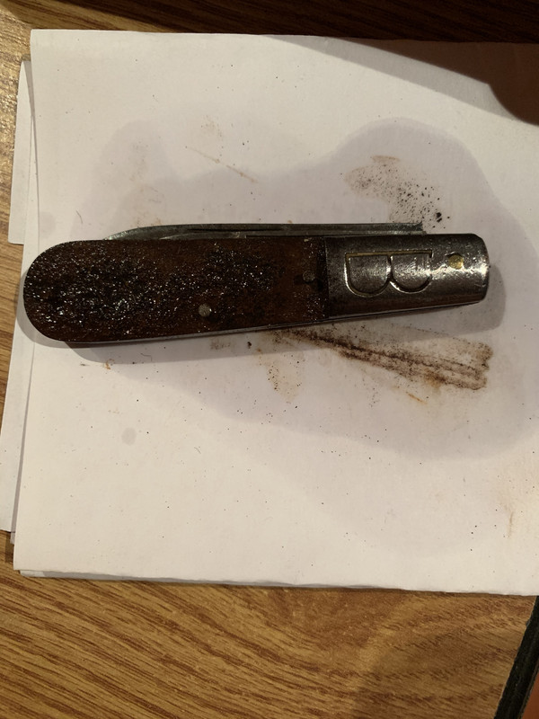

I’m rescaling an old German Barlow myself. As your can see, I have my work cut out for me. My original pins appear to be fine, so I’ll probably just leave them alone and epoxy the scales on.
