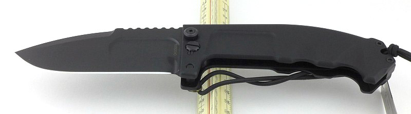

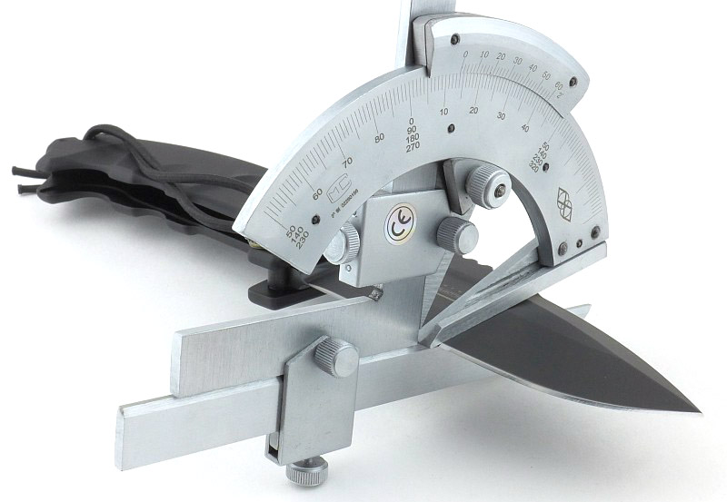

Most knife specifications have a basic description of the blade geometry, but in this section I will be taking a more detailed look at geometry and balance.
Using a set of gauges and precision measuring equipment including a Vernier protractor, callipers, fixed radius gauges and the unique Arc Master adjustable radius gauge (the one that looks like a crossbow).
These measurements have been tabulated and are presented along with a few reference blades (8" Chef's Knife, 5.5" Santoku and the popular Fällkniven F1).
Key aspects such as the primary bevel angle, grind type, blade depth, blade thickness, length, weight are detailed, along with balance information.
The 'Balance relative to the front of the handle' tells you if the knife will feel front heavy, or if the weight is in your hand (a positive value means the weight is forward of the front of the handle). The 'Balance relative to the centre of the handle' indicates how close to a 'neutral balance' the knife has in the hand.
In the case of full convex grinds the approximate centre of the grind is used for the primary bevel angle estimate.

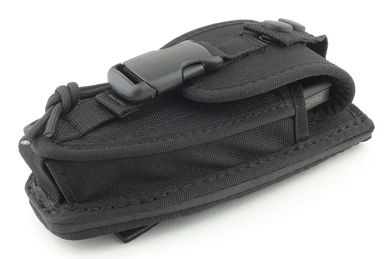

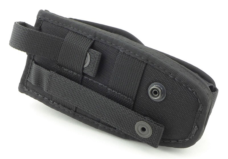

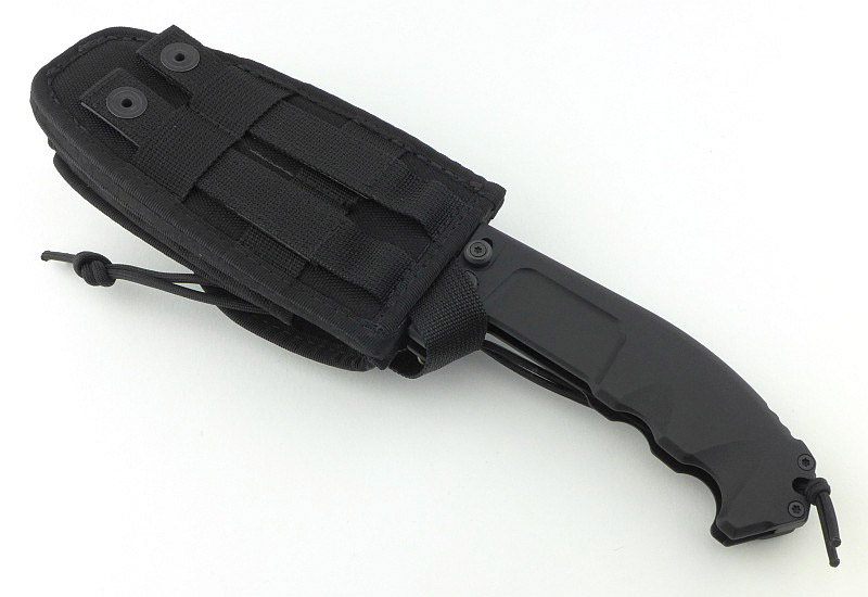

The RAO II arrives in its dual purpose sheath. We need to have a closer look at this sheath before we move onto that amazing knife.

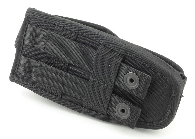

On the back are the MOLLE fitting straps. As supplied they are not woven into the webbing but just held with the press studs.
As with most MOLLE mounts, the fit is pretty tight.
If just using the webbing next to the press studs, the MOLLE straps form a belt loop, which is how I'll be using this for the most part during testing.

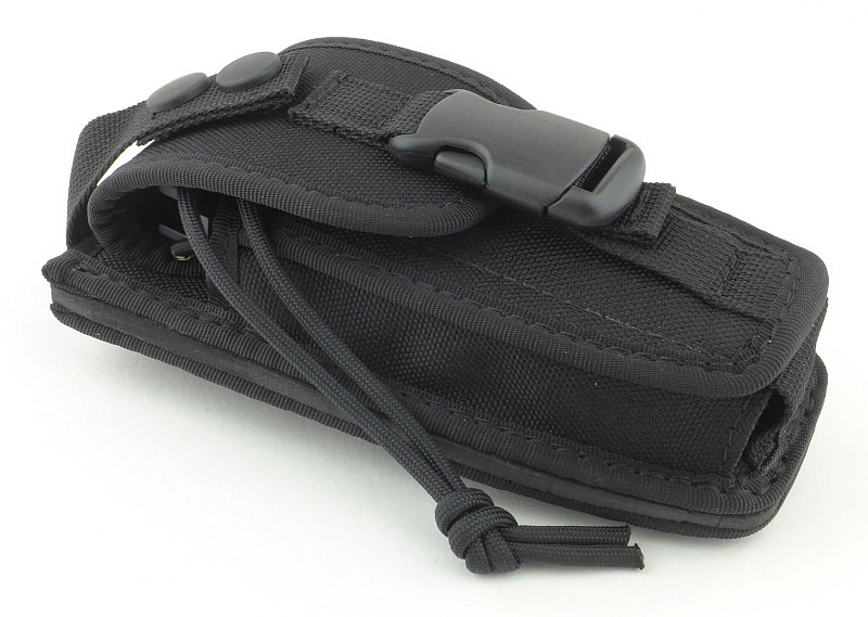

This dual purpose sheath has a large front pocket with plastic buckle fastener holding down the flap.
The flap has another strap attached to it with two press studs. This is the retaining strap for when the sheath is used to carry to opened RAO II.
Releasing the strap from the two press studs and now you can see where the blade of the opened knife is inserted.
Flipping open the flap covering the front pocket and you find the diamond sharpener slipped into a small pocket in front of the main compartment.
This sharpener is a steel plate with a diamond pad on it.

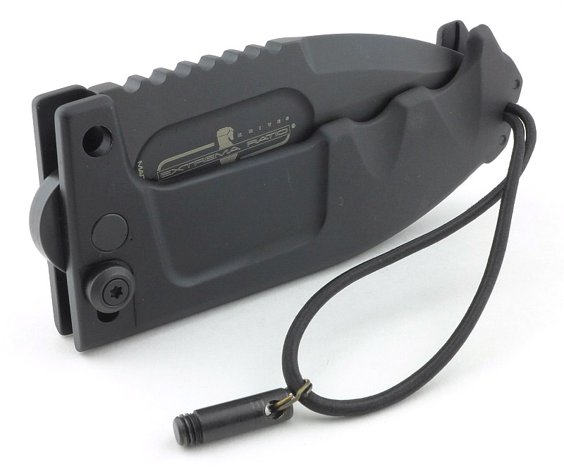

Out of the box, the RAO II is actually locked shut. We'll look at the special locking/safety pin next.

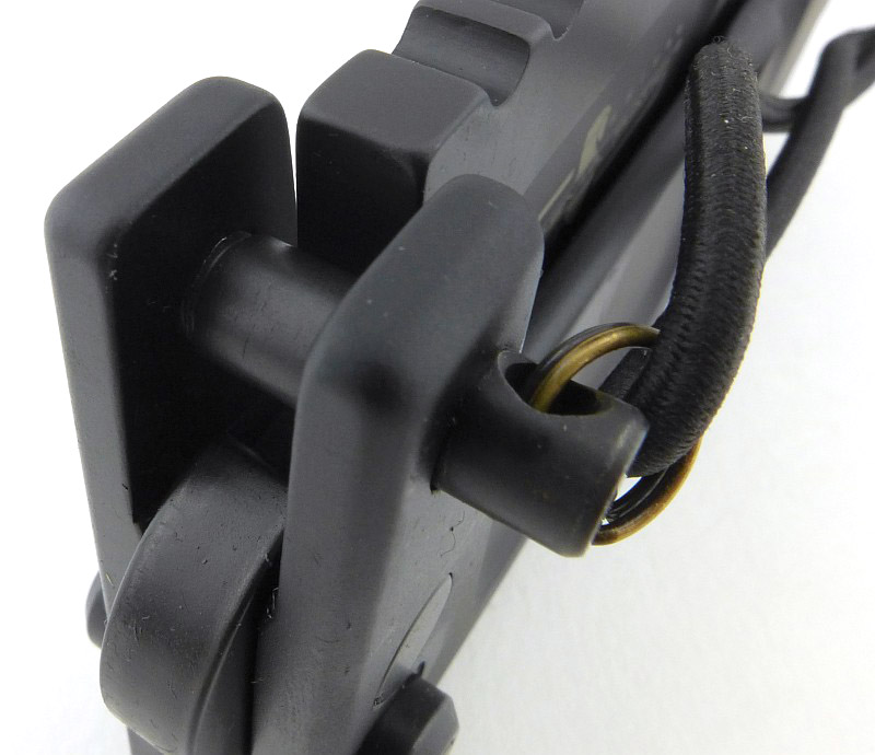

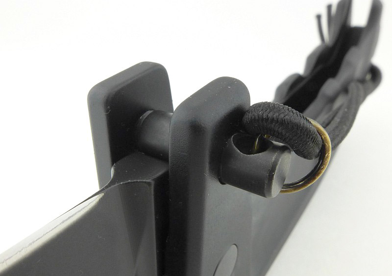

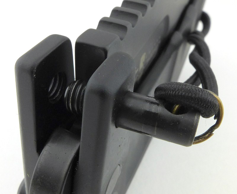

So, one of the RAO II's special features is its safety locking pin which effectively makes it into a fixed blade knife. This fits through the finger guard and can be fitted with the blade open or folded.
One end of the pin is threaded, so it screws into place.
The pin is on a loop of elastic, so once removed it cannot be dropped or lost (unless the elastic cord is cut).
Now the blade is opened, we can put the safety pin back in place to secure the blade in the open position. There is no getting past that pin.

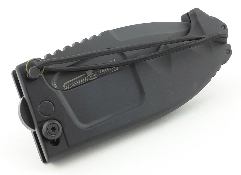

Pivot tension is set using a single sided pivot bolt (the other side is a blank plate). The pivot bolt head has a notched edge which allows it to be securely locked in place using the small screw that fits into one of the twelve notches. With the pivot locking screw in place, the pivot bolt cannot turn at all. You can beat on this knife as hard as you like and that pivot bolt won't come loose.

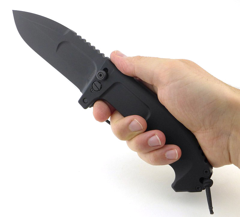

The improved ergonomics are obvious with well rounded edges all round the handle. Extrema Ratio's handle style is recognisable with the first two fingers grip. The RAO II also includes a third and fourth finger grip.

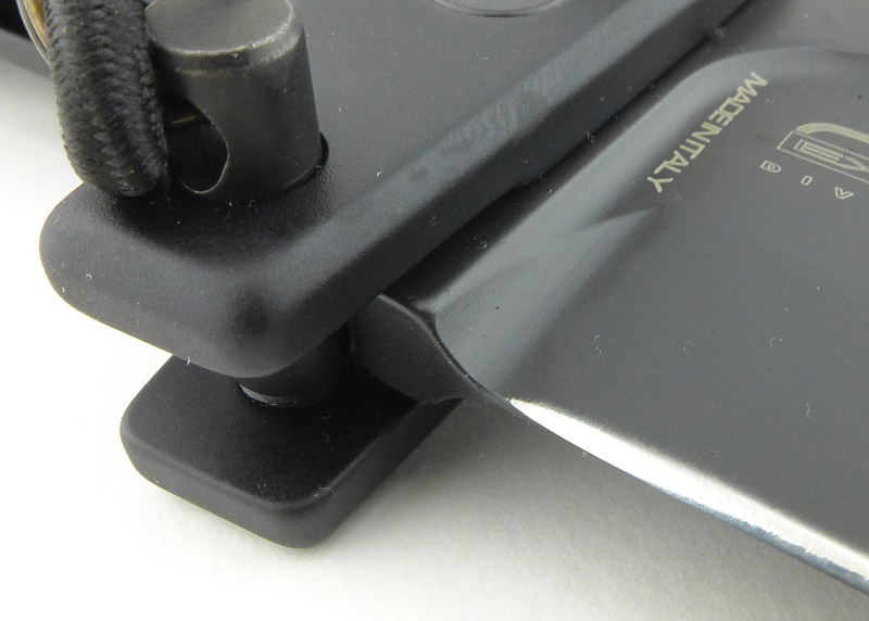

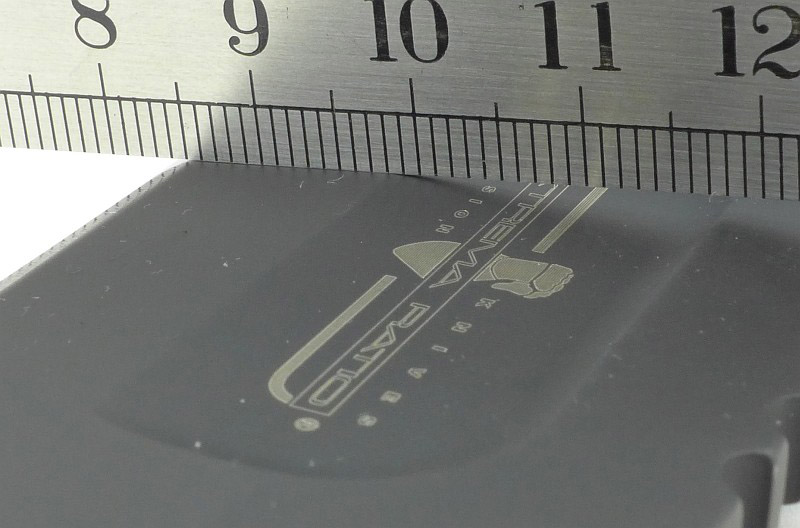

And now onto that purposeful blade. A drop-point with bayonet grind, the RAO II's blade is very deep. The area where the logo is printed is thinned slightly from the full thickness to provide a grip for opening the blade with.

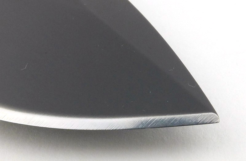

A close look at the blade tip and edge bevel.
The plunge line is well rounded to maximise strength. The slight double-plunge effect here is caused by the primary bevel meeting the blade opening grip and its different radiusing.

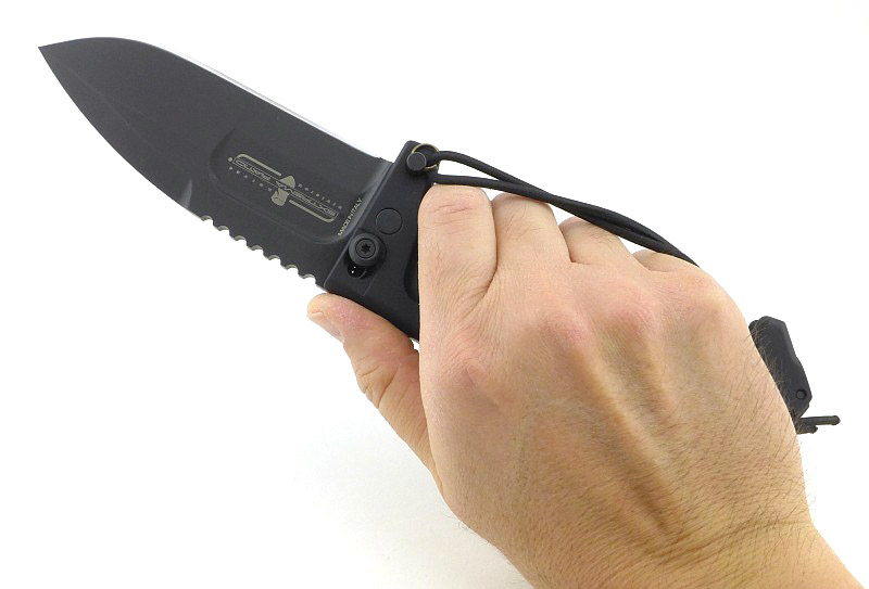

If you ignore the pivot bolt and bolt lock button, the impression of this knife is not of a folder, but of a chunky fixed utility knife. In a bare hand (I take XL gloves) the finger grips are not quite in the right place. With gloves on they are a better match, but are definitely a better fit for large gloved hands.
It's big, but somehow seems perfectly reasonable once you pick it up. However, that handle is a significant size and the blade very deep, just look at the next photo.
