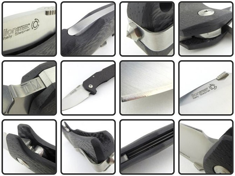

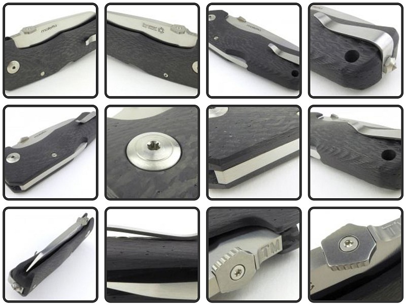

A good look round the Lionsteel TM1 CF - Things to look out for here are:
There is a lot to see on the TM1, so keep an eye out for the handle contouring, clip and glass breaker, ramped thumb opener, crisp finish and other design details.

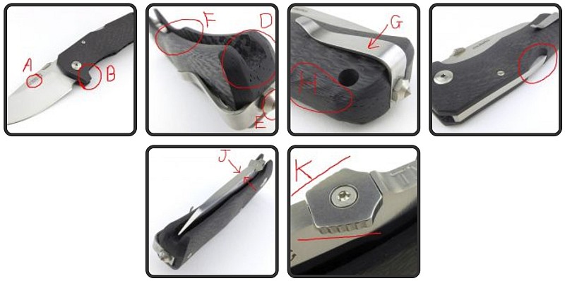

Explained by the Maker:
The reasons for certain design choices may not be clear when simply looking at an object, so this section is intended to give an insight into the thinking behind a design by speaking to the designer themselves.
I had the good fortune to be able to consult Mik Molletta about this knife...(Only available in the full version of this review.)

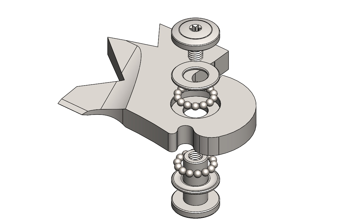

In case you were wondering how they fit those IKBs bearings...
(This image is from Lionsteel's TM1 product page.)

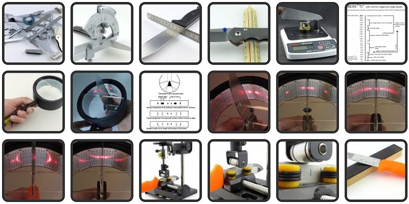

The Blade and Handle - Detailed Measurements:
Now even more detailed!
Taking things far beyond most knife specifications, in this section I will be carrying out a detailed examination of geometry, balance, edge bevels, factory sharpness and structural edge testing using the industry leading measuring tools.
These measuring tools include a Vernier protractor, callipers, fixed radius gauges, the unique Arc Master adjustable radius gauge, Edge On Up's BESS Certified PT50A and SET tester along with CATRA's Hobbigoni LASER Edge Protractor.
The BESS 'C' scale of sharpness (Brubacher Edge Sharpness Scale) will be used to verify the sharpness of the factory edge and allow the knife to be brought to a minimum standard sharpness before testing a blade's cutting performance.
The measurements have been tabulated and are presented along with a few reference blades. The 'Balance relative to the front of the handle' tells you if the knife will feel front heavy, or if the weight is in your hand (a positive value means the weight is forward of the front of the handle). The 'Balance relative to the centre of the handle' indicates how close to a 'neutral balance' the knife has in the hand.
(Table only available in the full version of this review.)
The blade is made from Sleipner 60-61 HRC steel.
The TM1's factory edge has an average BESS 'C' sharpness of 342. This was acceptable as it would slice 80gsm paper, but not to the level I like so I brought the edge to 15 degree per-side and 200 BESS for testing the knife.

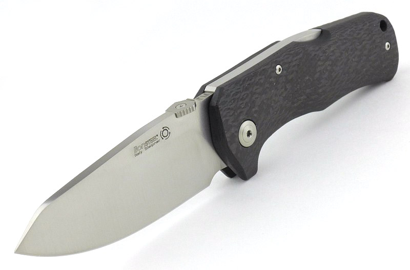

What it is like to use?
Lionsteel's TM1 is a pleasant contradiction as it is a 'heavy folder' yet at the same time it is a 'lightweight folder' (for its size) thanks to the carbon-fibre handle. Although the blade is a substantial 4.5mm, making it massively strong, and the handle is matched to the blade perfectly, the TM1 is light and easy to carry.
Thanks to its one piece sculpted handle and back-lock, the grip is excellent for a folder. A fully integral finger guard makes the grip super stable and more than a match for that powerful blade.
Opening is silky as the blade swings out smoothly and effortlessly on those ball bearings. If you hold the handle and push the lock bar in fully, the blade actually becomes completely free to swing (without the lock bar pressing on it) and does so with no resistance at all. Not being a flipper I had wondered if it was worth using the ball bearings, but it is - the opening is just so slick. The thumb opener has been shaped into a ramp and gives a larger contact area for your thumb than studs do, and this makes it quite a bit more comfortable to use.
Then there is that snap of the lock; so crisp, precise and solid, and so satisfying. It makes you want to keep on opening it up. (Warning - you might annoy your family or work colleagues with this knife.)
This is the first 'reverse-tanto' blade I've used, however the principle is not far from a clip-point, just a smaller clip, keeping the tip very strong. Slightly odd looking, it has proven to be highly usable. No issues with the tip's puncturing ability even though the point angle is 71 degrees. The tip looks extremely strong, but as yet I've not had a reason to really put this to the test (no car doors have jumped out at me and needed cutting into).
So 'Sleipner' in a folder? I was a little unsure about this choice with the reports of corrosion, and the fact it is not a stainless steel having only 7.8% Cr. I decided that during the course of the testing I would not use any oils or other blade protection, and have been using this knife for around six months for a variety of tasks, including with foods, and with one in particular that is normally very harsh - banana! Opening and fishing about in boil-in-the-bag foods so getting a good dose of heat and steam, pocket time, handling and at best a little wipe down.
It is possible that the blade has been lacquered but I can't see any evidence this has been done, and I reground the cutting edge bevel, so I know that is bare steel. To date there has not been any sign of corrosion. I had expected to have to intervene and remove some spotting as I haven't been caring for the blade steel. This is not the same as specifically abusing it or really trying to get it to corrode, but the testing has been normal use with little to no attempts to protect it beyond a wipe from time to time.
I'll have to say I'm still a little wary that this might need more care than I'd like, but so far I've been pleasantly surprised that it has not been noticeably susceptible to corrosion. It is possible the specific heat-treat Mik mentioned may have improved the corrosion resistance of this steel.
You might have spotted the relatively small looking clip, and like me assumed it was not going to work well. I found I was eating my words though. When I pocket-carried the TM1, that clip had enough clearance to get onto the pocket edge and enough flex to slide into place, yet enough grip to stay put. I had dismissed this clip as an afterthought, but was wrong, it works. The clip can also be removed and refitted on the other side.
