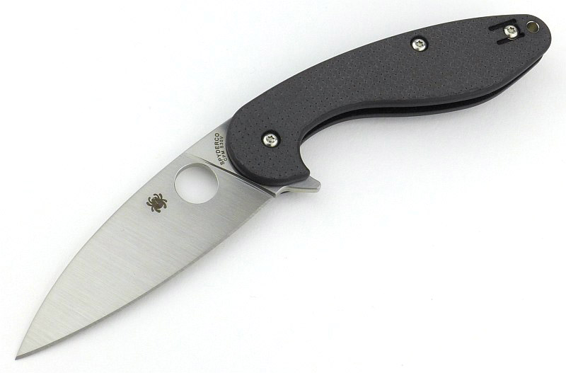

The Spyderco Sliverax is a design by automotive engineer and knife enthusiast Paul Alexander. It is the first production folding knife to combine a flipper opener with Spyderco’s Compression Lock mechanism, and is Paul's second collaboration with Spyderco. Sleek lines and a pronounced positive rake to the blade give the Sliverax a distinctive and purposeful look.

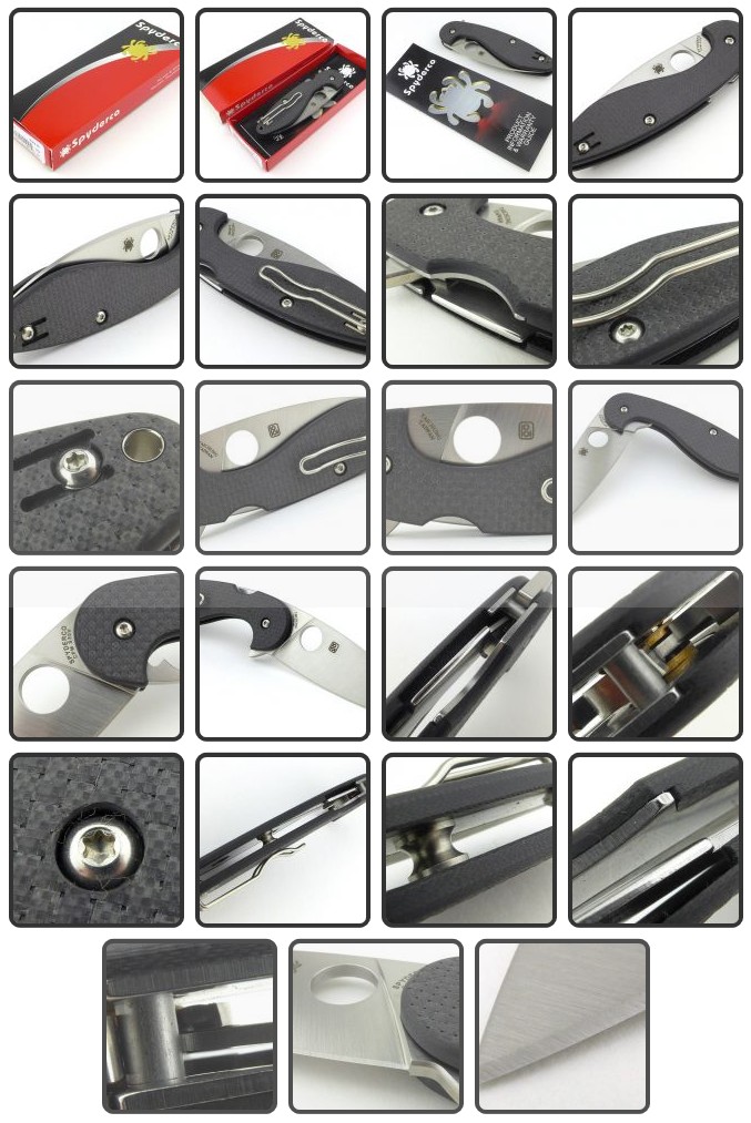

A good look round the Sliverax:
Things to look out for here are included in the image captions.

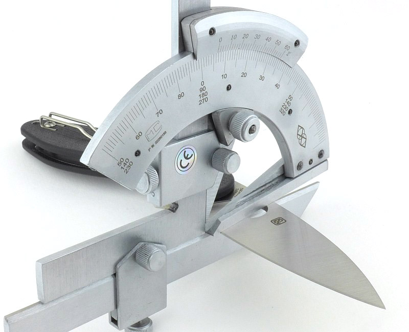

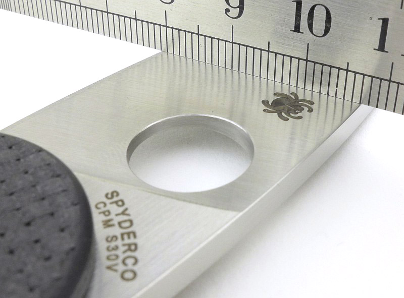

Using a set of gauges and precision measuring equipment including a Vernier protractor, callipers, fixed radius gauges and the unique Arc Master adjustable radius gauge (the one that looks like a crossbow).
These measurements have been tabulated and are presented along with a few reference blades (8" Chef's Knife, 5.5" Santoku and the popular Fällkniven F1).
Key aspects such as the primary bevel angle, grind type, blade depth, blade thickness, length, weight are detailed, along with balance information.

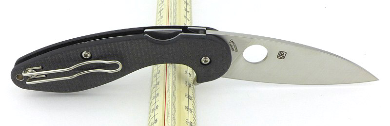

The 'Balance relative to the front of the handle' tells you if the knife will feel front heavy, or if the weight is in your hand (a positive value means the weight is forward of the front of the handle). The 'Balance relative to the centre of the handle' indicates how close to a 'neutral balance' the knife has in the hand.
In the case of full convex grinds the approximate centre of the grind is used for the primary bevel angle estimate.

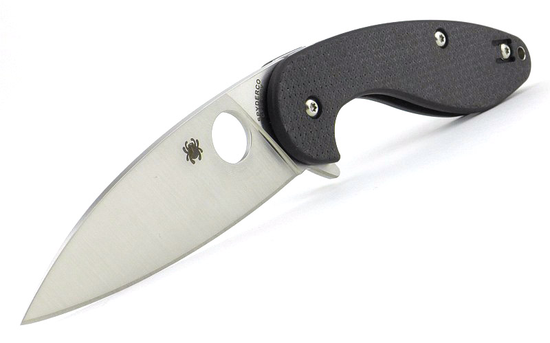

The Sliverax's factory edge has an average BESS 'C' sharpness of 186. This is yet another super sharp factory edge from Spyderco. A figure less than 200 is really good and easily shaves arm hairs and falls through 80gsm paper.
What it is like to use?
What struck me on initially handling this knife is how the Sliverax differs from conventional folders with its organic lines and purposeful downward angled blade (positive rake).

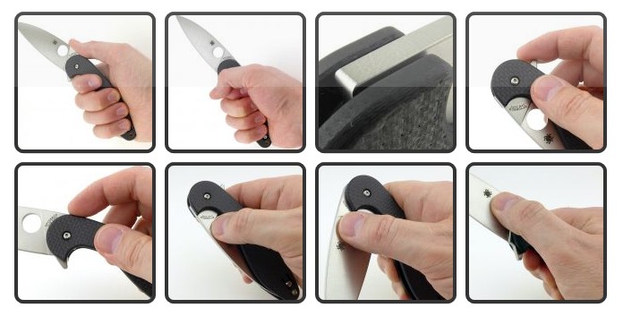

When folded it is almost like a worry stone in its pleasing feel and curvy shape. Opening is lightning fast with the flipper, and this speed is in part due to the blade's positive rake, meaning the blade only has to rotate 160 degrees to open, instead of 180 degrees. Of course the pivot's captive ball bearings also guide the blade with virtually no resistance at all.
Having a fully exposed opening hole from both sides makes it very comfortable and easy to thumb-open with either hand. The clip can be fitted to either side, so the Sliverax is truly ambidextrous. The only aspect that is slightly handed is a one-handed close. I certainly found it easier to unlock the compression lock one handed using my right hand.
For the opening hole to be fully exposed, and to not have a Spyderco 'hump', a lot of the handle has been cut away making the handle at the first and second fingers very thin. As well as accentuating the rake of the blade further, it also makes a full hand grip a little awkward as the fingers don't have much to hold. However it does provide a deep finger guard so the chance your hand might slip forward is very low.
I tend to prefer thumb-opening blades for several reasons. In fact, in the UK where I am based, flippers are too close to switchblades for comfort, so a nicely controlled thumb-open goes down much better. This leads me to make an observation about the compression lock which I also noted on the Sharman. As I open the blade, my first finger tends to lie over the lock itself, and the lock bar often gives me a little nip as it snaps into place. A minor complaint and easily avoided (if you remember) but mentioned here as an observation.
Despite being a smooth finish, the Carbon Fibre/G-10 Laminate handle has enough texture to provide positive grip even when wet.
Even without the 'issue' of appearances in the UK, I am personally a bit tired of the flipper. A mechanism where you have to compromise your grip on the knife to be able to press on a flipper tab to literally flick the blade open. Flippers can and do fail to fully open or lock, so much like the fixed blade is your most reliable partner, the two-handed open or the properly thumbed-open blade that is positively taken all the way to the locked position, means you know 100% it is there. If safety and security are your primary aims, then open the blade by manually rotating it all the way.
