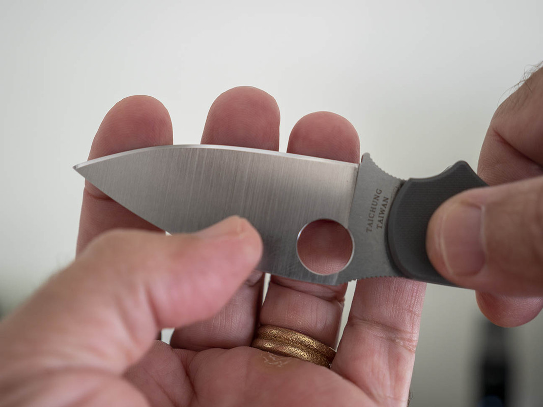

For me, touch is the most reliable way to detect a burr. For example, to check the show side of the blade, hold the knife in your right hand, blade side up, and lightly stroke the bevel with the pads of your fingers, going from low to high. Like this:
If it feels scratchy, you have a burr. If you're in doubt, flip the blade over and compare to the other side.
