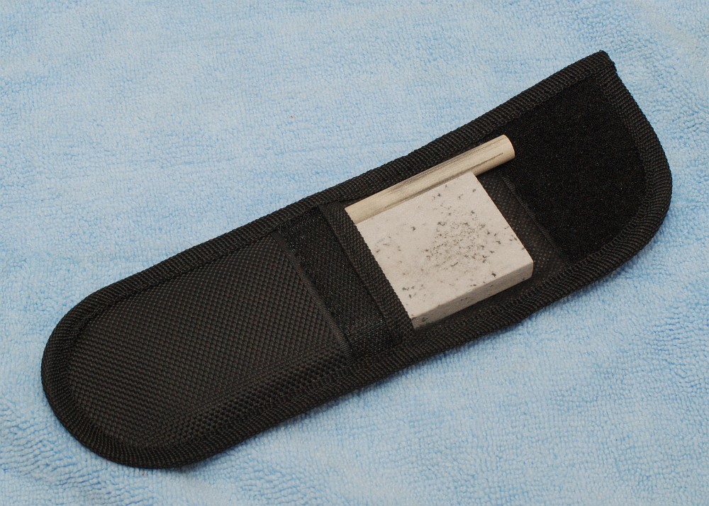

This is the sharpening kit I carry when backpacking. A small Arkansas stone and a ceramic rod. I can do just fine without it, but it only weighs around 4 ounces and does a nice job. A leather strop could have been a nice addition, but the small gain in fine sharpness is not worth the extra clutter and weight.

To describe what you're looking at, the stone is 1.5" X 4" and the ceramic rod is 3/8" X 4.5". Total weight for the set with the pouch is 5 ounces. Holding the stone or rod stationary and stroking the knife blade across, I can only sharpen a pocket knife or small fixed blade with these. But if I use the stone or rod to stroke across the cutting edge of the blade, I can easily sharpen a large machete or full size axehead. So I really don't see a need to pack anything larger and heavier. And like Owen said already, you rarely take metal off in the field. I could in fact get by with the little rod alone for almost everything I need out there. The stone is mostly for axes and a 'just in case' piece of gear.
