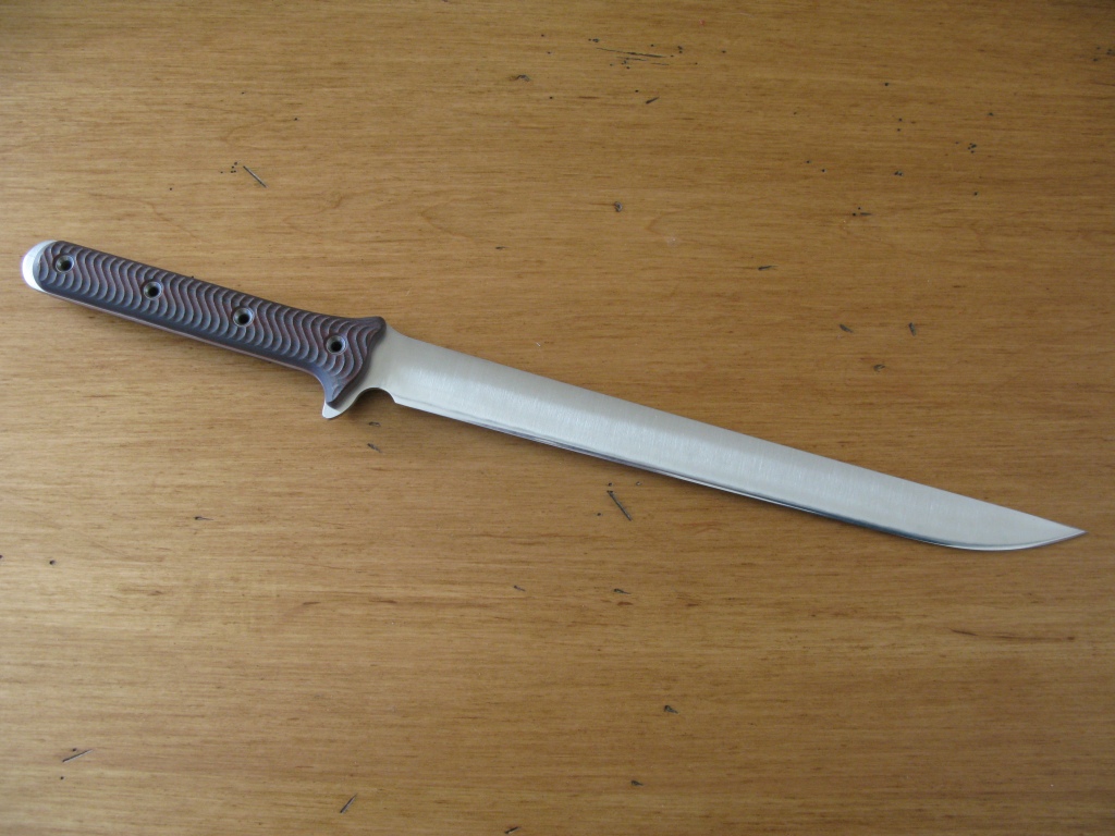

I know little to nothing about sharpening my blades. I just go to a local restaurant supply shop that sharpens knives. They do a good job but I don't think they can do what I have seen represented on here. I suppose I could just buy one of those high end sharpening systems but I would like to get a mirror finish on my LE AMS. Do you hogs know who I can send it to? Thanks.
You could always send it back to Busse. They do custom jobs. You'll gain the ''Custom Shop'' mark which makes it even more bad ***

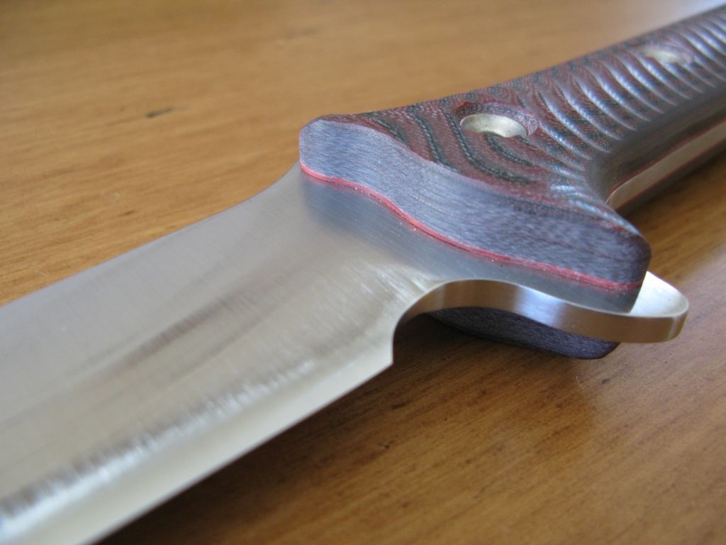

I can highly recommend knifemods.com
Nate did one hell of a job on my Rucki; satin finish, zero convex, penetrator tip and red liners.
The edge on this one will split atoms:eek:
