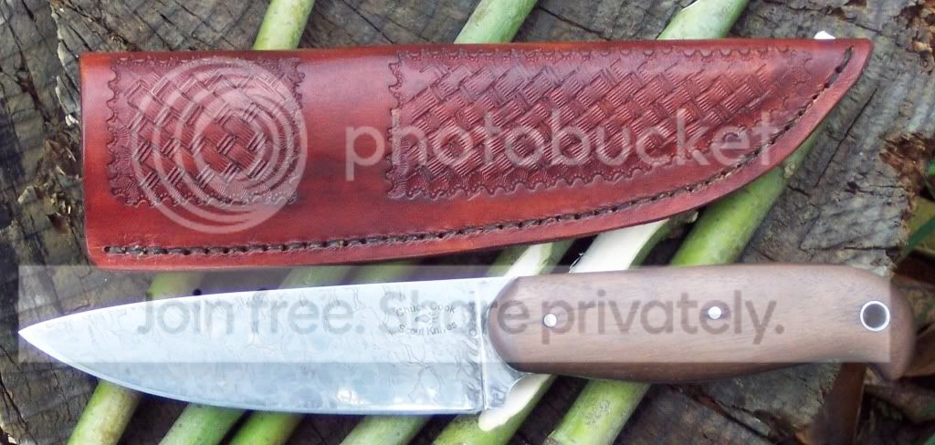

I took up knife making to make just such a knife as you describe. Five years and thousands of dollars later I finally figured out that there are too many compromises necessary to make the perfect mutiple purpose knife. Still, you can come close...
Here is my take on what you are asking about, 9/64" o1 ts with walnut handles and mustard patina. The blade is just under 5", the edge is set to 20 deg. One thing is the grind gets a little thicker as it runs to the point to keep it stronger, were a true kitchen would get very thin (in my eyes).
I have it in the WSS bushcraft build off (linked below), it has been called a kitchen knife, but it works.
