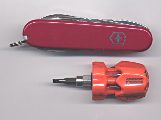

Hi,Does anyone know where I can find a tool(s) to take apart folders & move the pocket clips?I have about three different allen wrenches,torc wrenches..etc,but the screws on most pocket clips are way too small for these.I've been in & out of hardware stores & Home Depot's & can't find anything that fits.:grumpy:

I picked up a Canadian-made Picquic Teeny-Turner multibit screwdriver for $4.99 at Fry's Electronics. In addition to the small straight (2) and Phillips (2) bits, it comes with T5, T6, and T8 Torx bits.
This one from RadioShack has a T6 bit that will work on your CS folder. :thumbup:
Hey Truthseeker,I know this thread's probably dead,but I just wanted to thank you for the tip.I just picked this one up today & it works on all my folders.Thanks to everyone for all the tips:D
