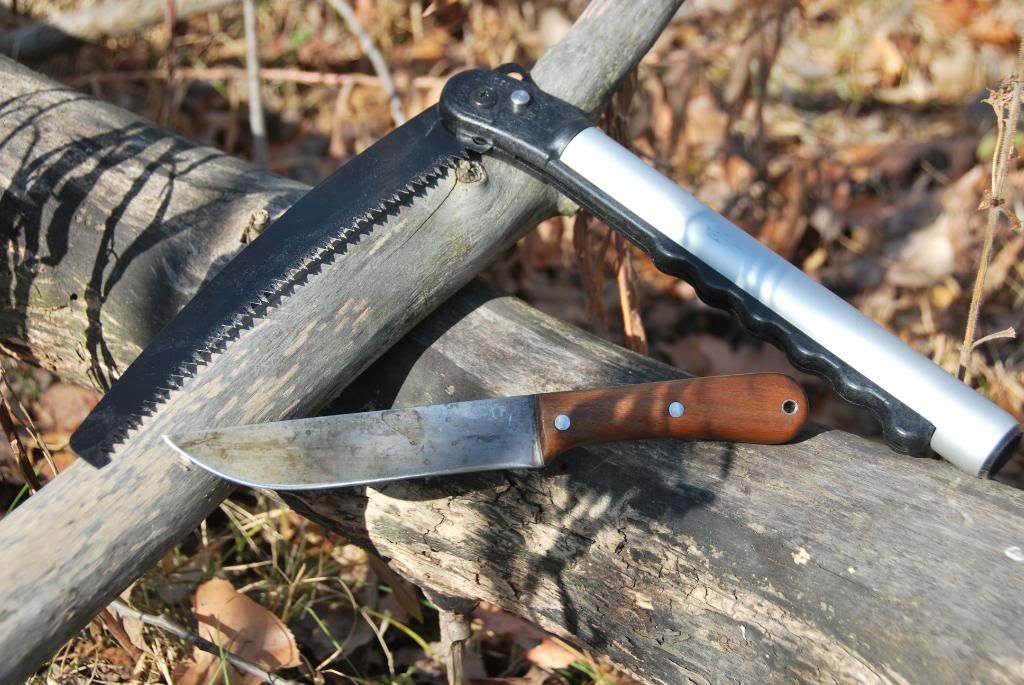

Btw Kgd..Did you get that foldable saw from Lee Valley? Either way, how's it holding up? I wasn't sure about all the plastic:(
