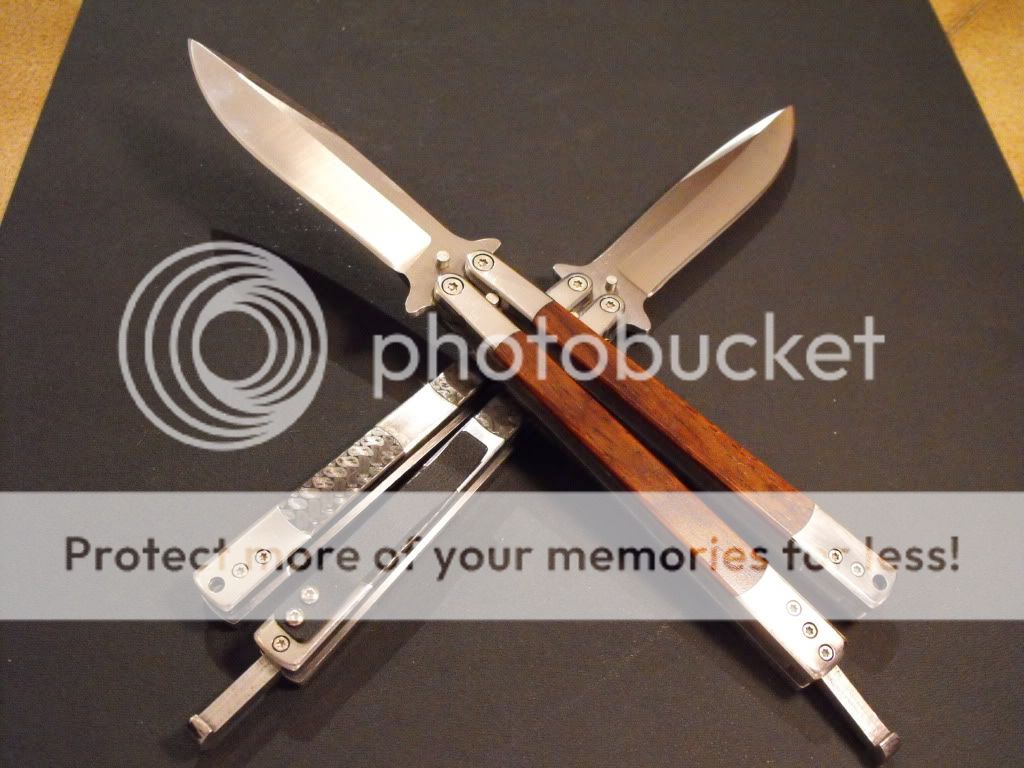

Hy guys, here I present you my two first Typhoons, made entirely with hands free electric tools, by me:
I first made the CF model, than the cocobolo, they have this features done:
-guards reprofiled, for aesthetics nothing wrong with the originals
-mirror polish handles, spacers, latch & screws, the polish on the CF model has a little bit too scratches, as it was my first model (learning experience:p)
-PB washers:thumbup:, bought separately, a ton better than the plastic ones that come with the kit:thumbdn:
-blade sharpened by me, the kit came with the blade totally unsharpened (trainer configuration)
-I have rounded the back of the blade (as in the BM Morpho 32)
-kydex clip (prototype phase) I would made a normal stainless steel clip, but drilling SS with a free hands electric drill was extremely difficult, even with a template (and cobalt bits, cutting oil, low speed) so I came with the idea of a Kydex clip, for now it works wonderfully and it has a great spring effect, it also allready survived a few drops with no damage; the clip was installed with longer screws bought separately.

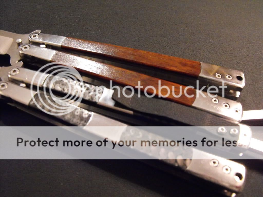

-I modded the handles of the cocobolo model for the long inserts configuration, IMO a lot nicer than the short ones

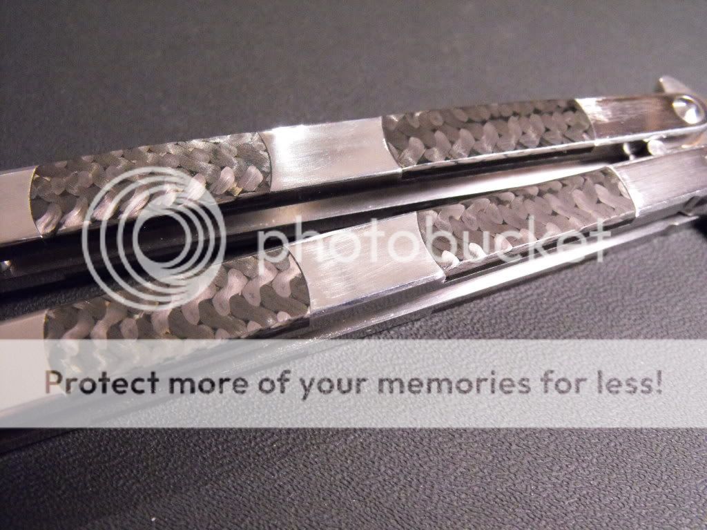

inserts finish, (CF & cocobolo also came from knifekits, really good stuff:thumbup:)

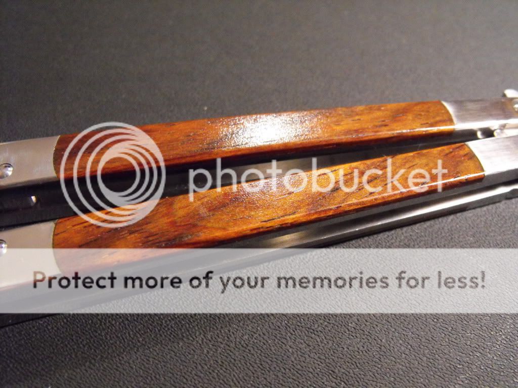

Both CF & cocobolo were sanded down to fine abrasives, then polish with compounds and the cocobolo inserts were than sprayed with a transparent spray paint for protection.

What do you think about the ones that I made?...:D

I used the glue UHU plus 300kg, it is a 2 elements epoxy, really strong and reliable, it is also transparent;) (excellent glue:thumbup:).
I prepared the surfaces before gluing, all cleaned with acetone (acetone is better than alcohol) and scratched with a sharp pointy nail.

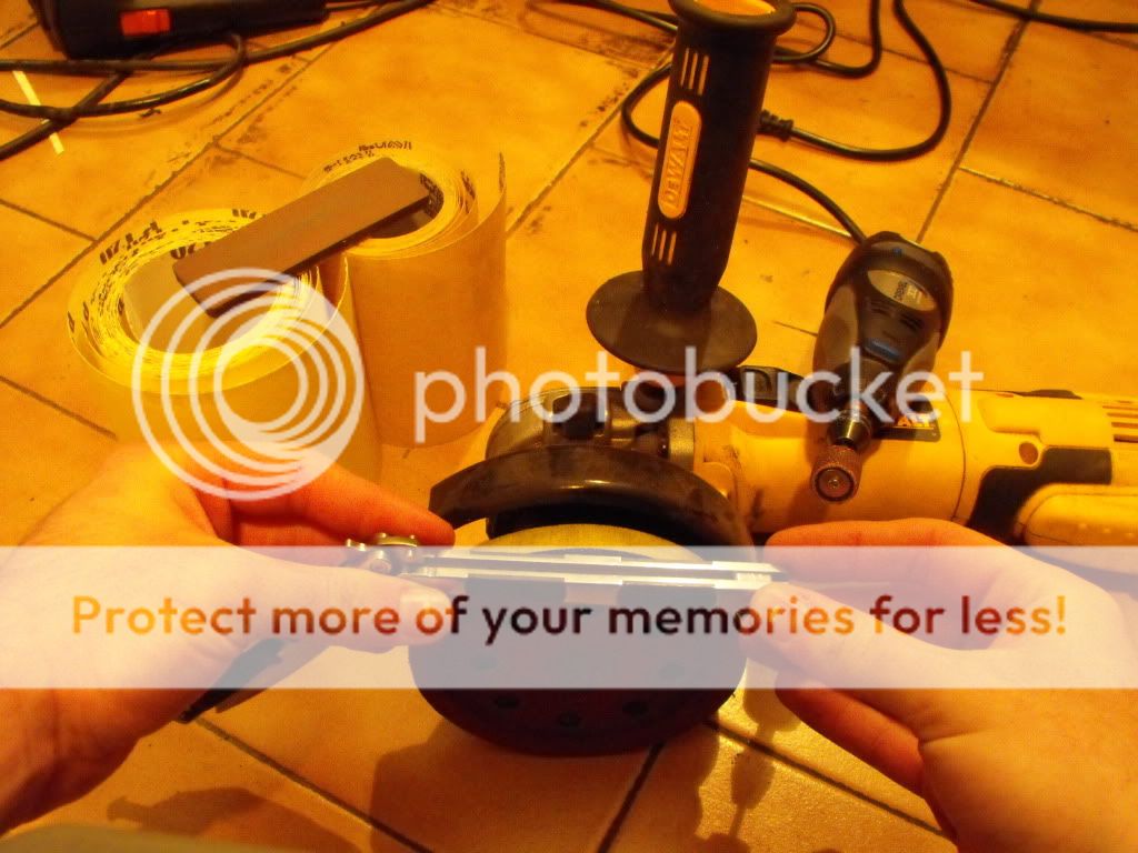

I have used mainly these tools:
-angle grinder (main tool) to grind & cut the inserts, I have a model that let me choose the speed (complete choice between minimum and maximum speed), really a loveable feature;) for easy of use and safety
-Dremel for detail grinding and polishing
-drill
-heat gun for the kydex clip, also used to clean better the handles before gluing
All the job was challenging, but trust me with a good basic manual skill and the know how on the web, it isn't too tough; just pay extreme attention in safety sector:

A tip is to center the inserts vertically and leave material to the sides, than you glue the inserts, then (after the glue is dry 24 hours) you grind the sides of inserts and level the faces of the inserts to the handles.

I used the grinder with an aggressive sandpaper disk (80 grit) to remove most of the steel from the handles, using the external part of the disk, then I used the Dremel to flatten the handles and for final levelling I used the DC4 with sandpaper (120-320).
During the grinding with the angle grinder I used water drops on the handles to keep them cool and not ruining the heat treatment.
When using the grinder I went with low pressure ("let the tool do the work"), medium speed, and no hurry at all (it took several hours), it is important to pay attention to safety.
For grinding-finishing the inserts I used the angle grinder sandpaper disks (80 for carbon fiber 120 for cocobolo, carbon fiber is a lot more tough to grind than wood), than hand sandpaper (120-320-1000), than compounds and finally only for the cocobolo the transparent spray paint.
