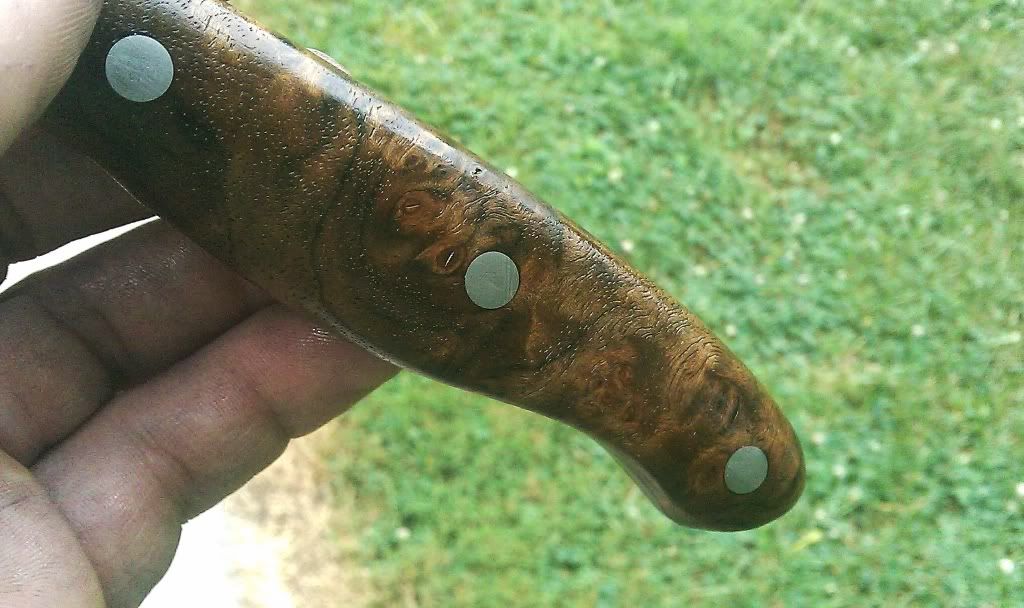

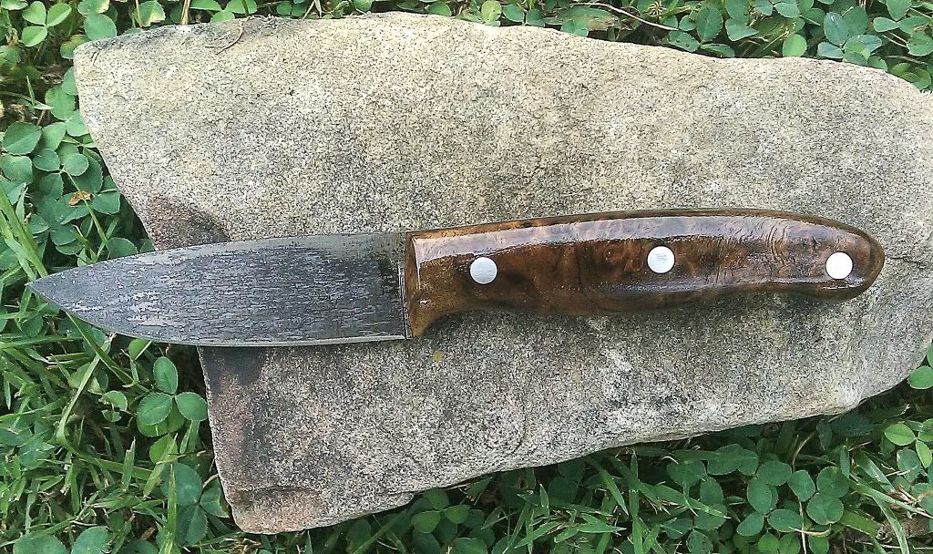

Here it is Matt, still have to do multiple coats of oil to bring out the figure and close the grain. Hope you enjoy it, I did.

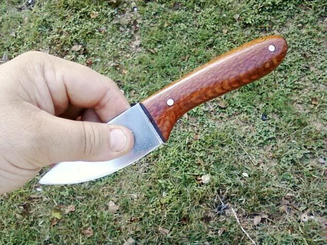

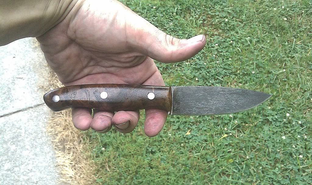

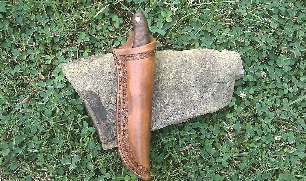

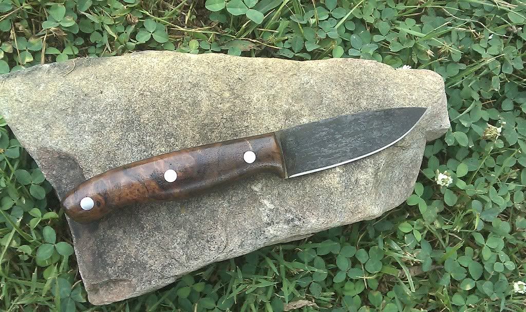

Pics added. Hope you like it Matt
Awesome!! you have no idea how long i"ve wanted to do that. Been dying to see it all day. I appreciate the schooling for sure KFU. i can't wait to get my hands on it and put it to use this sept. im thrilled man. thanks again for sharing the knowledge. Its one thing to own a nice knife, i know now its altogether different to have a hand in creating it. im hooked....:D

Glad you like it man. I used that walnut burl you thought was cool, not the crotch. I have a ton of it and have never used it. Its killer! Itll take a little more work due to the voids in the burl but man when its done! Pics don't even come close to showing how nice it is. So are you saving for a grinder yet???;)

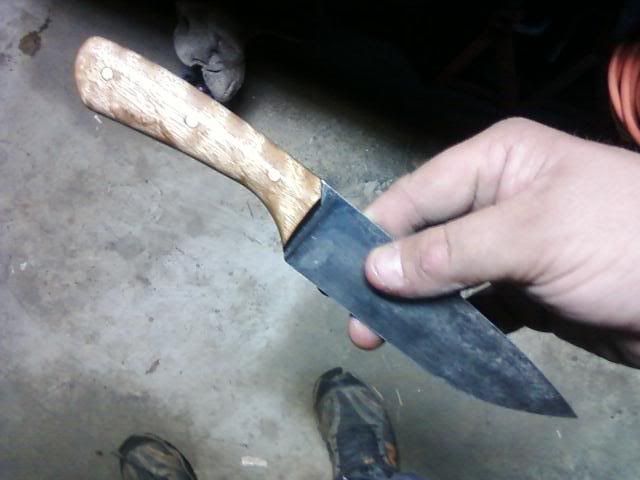

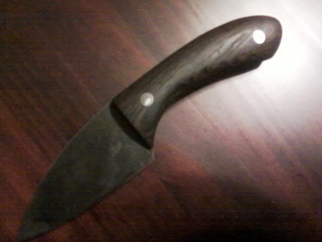

ok these are by no means the quality of kfu and ba's knives, but heck im trying here. Its just fun to do. So fun the fiance is now rolling her eyes every time i head out in the garage!!!
That old machete turned out good man, looks like my Parang! Bring em over and we will sharpen them up real good. I hope that Wenge turned out nice.
Chris, a simple woodworkers trick for filling small voids in open grain wood is to "wet sand" with the first flood coat of oil.
This fills the pores without actually concealing grain if you use a wet dry paper in the same grit as your final sanding before you start with the finish.
Matt - nice work, looking forward to seeing how your work progresses with time.
Thanks Vik! I actually did that after the pics but I like to leave a little open grain on handles for some reason. Ive done it alot on old rifles that Ive refinished over the years. Ive tried grain fillers but good old wet sanding does the trick better, but takes alot more time! I bet I put 20 or 30 coats of Truoil on those stocks.

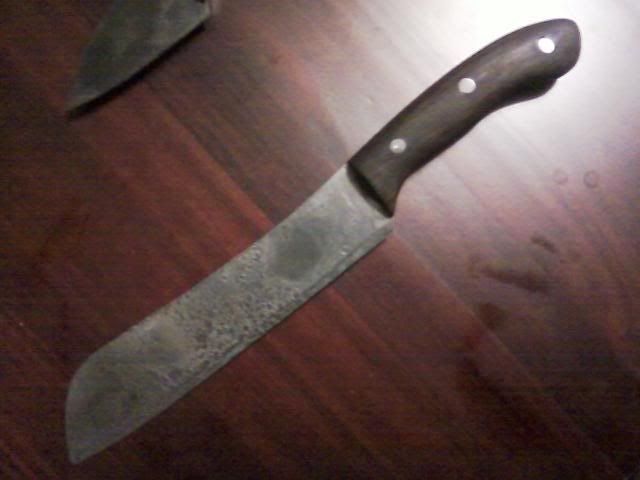

been playing a little more here.
what do ya guys think? been just using what i have. i don't have all the right stuff yet. but i gotta start somewhere....since kfu got me started that is. :D
