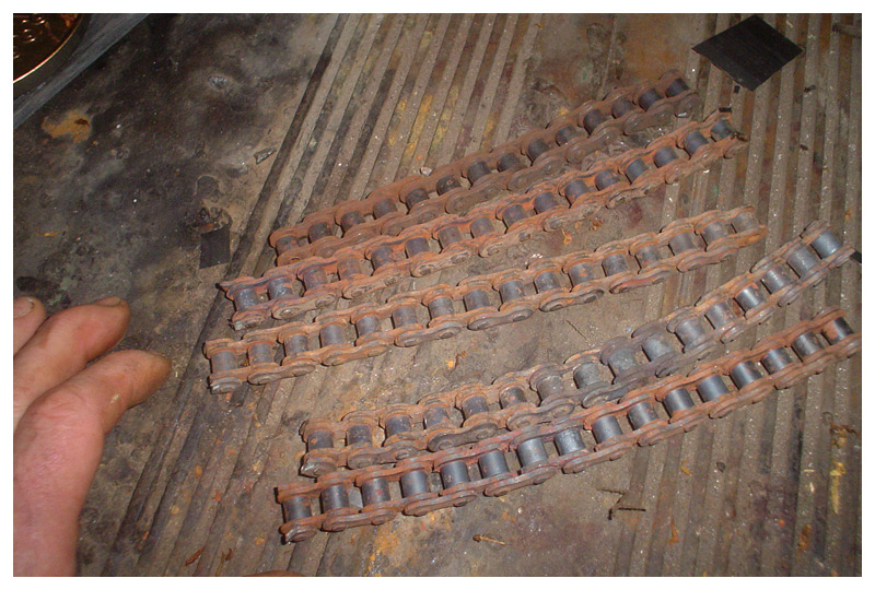

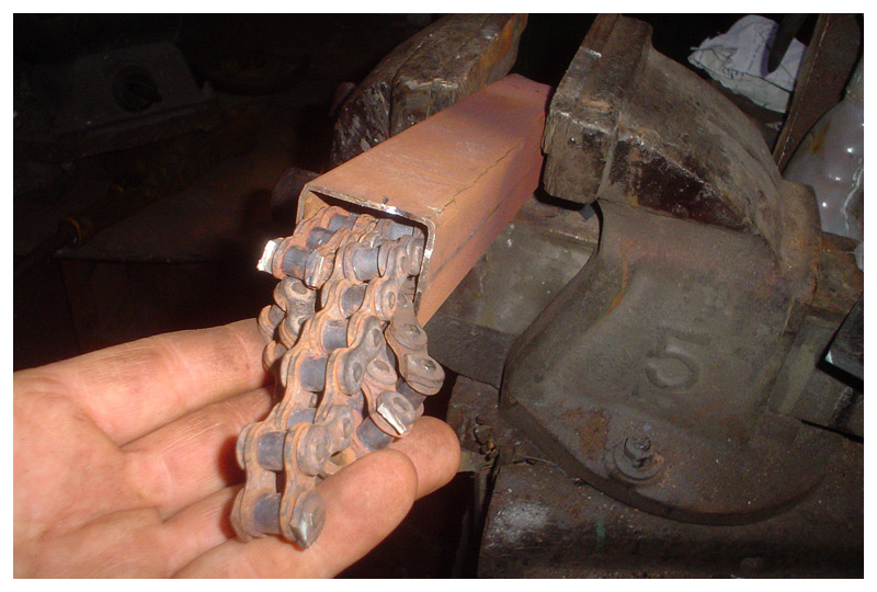

I start with some rusted motorcycle chain.

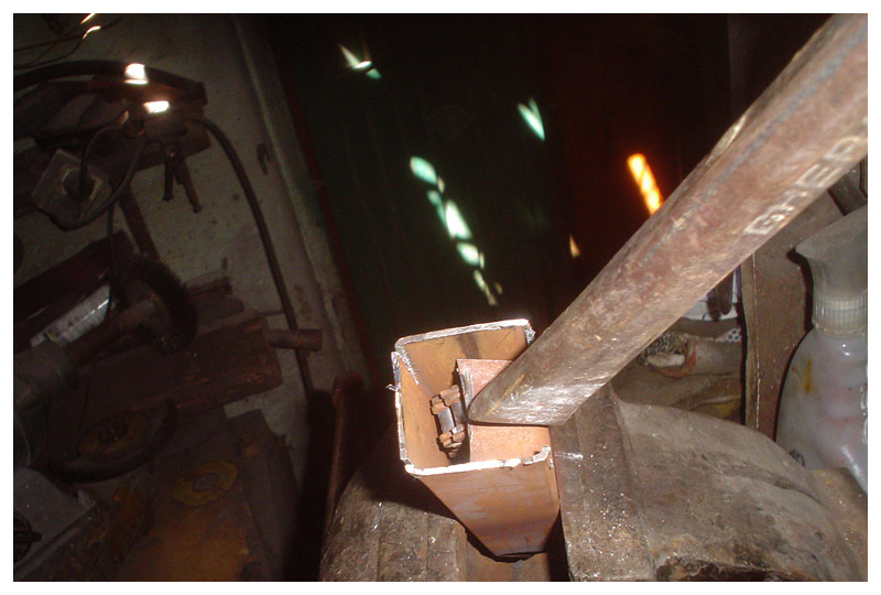

I place it inside a square section pipe.

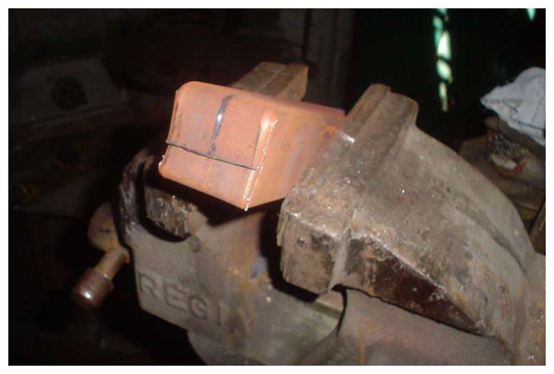

Then I cut the ends of the pipe so I can close it.
Closing it.
Closed it.

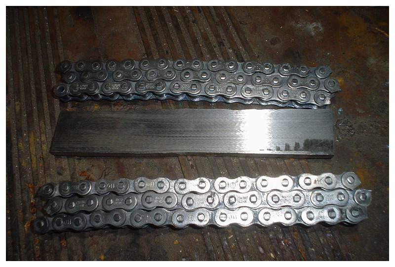

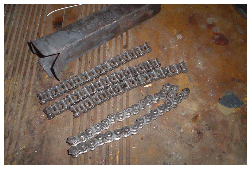

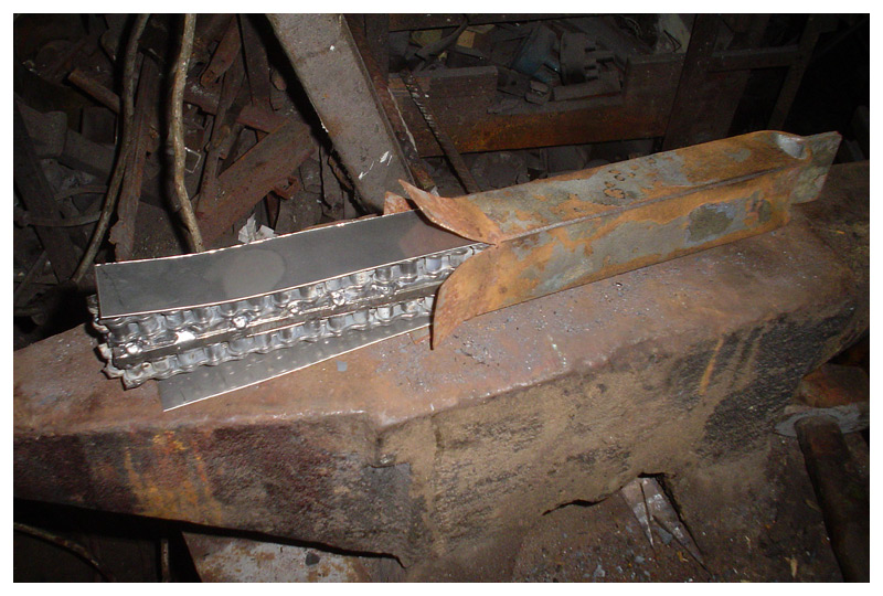

Pipe opened with de rusted chains.

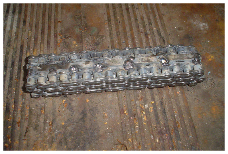

Said chains with a 1/4" 5160 plate.

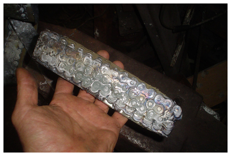

Chains welded to the 5160 plate.

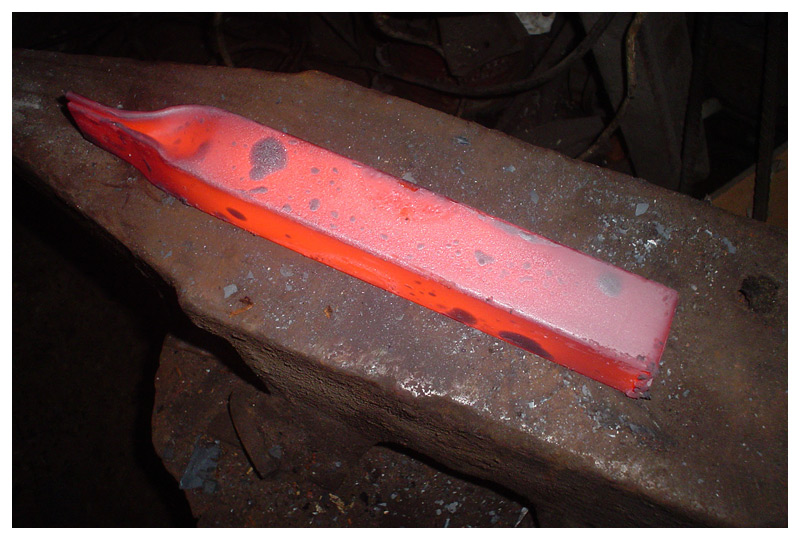

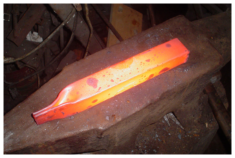

Placing it inside the pipe with added stainless 304 strips so the damascus doesn't weld to the pipe.

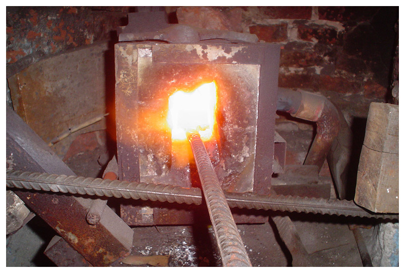

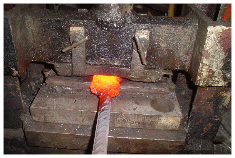

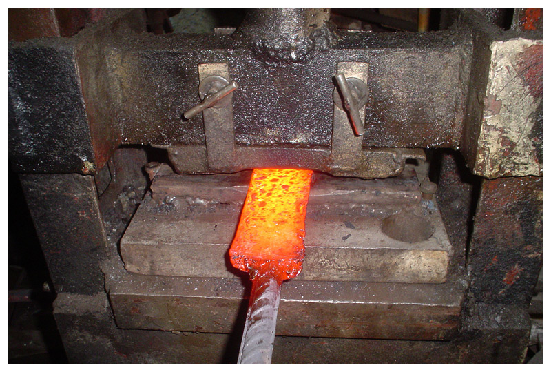

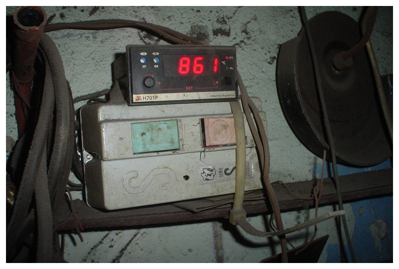

Putting it on the oven at 1300C for 20 minutes.

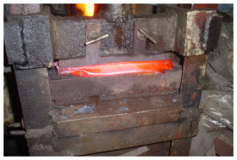

Pressing the pipe.

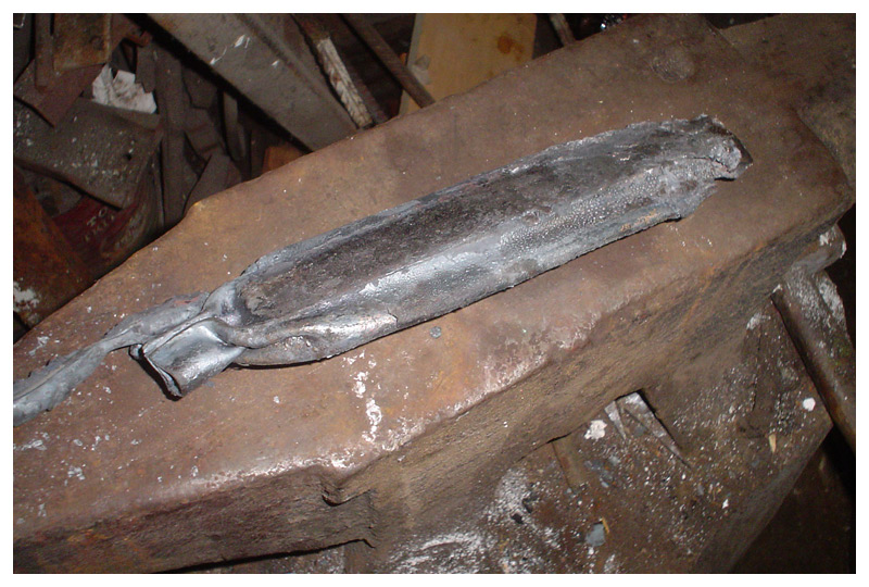

After pressing it.

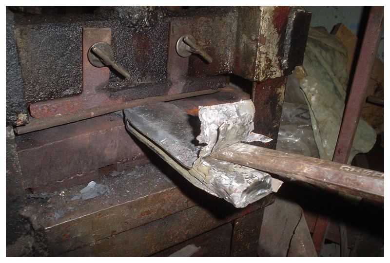

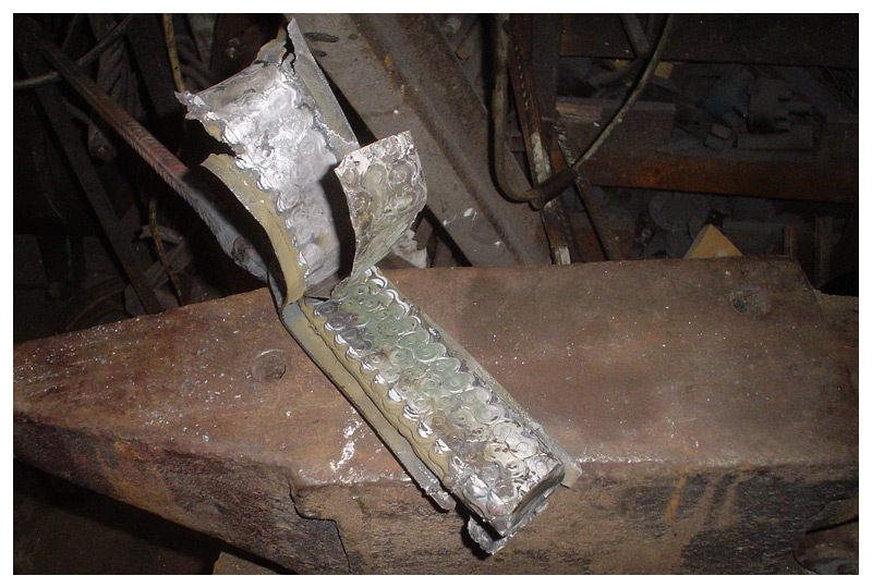

Separating the damascus ingot from the pipe.
Thanks to the 304 strip this is an easy job.

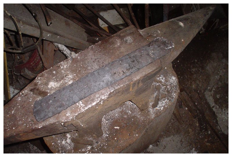

Damascus ingot ready to be worked on.
Pressing it to 5/16"

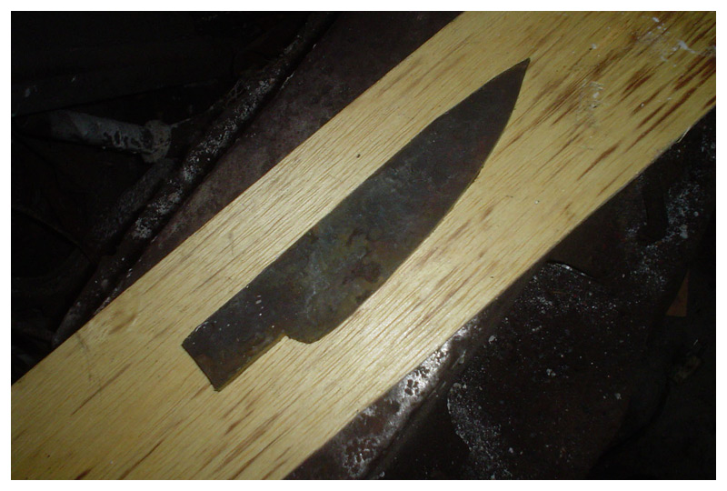

Damascus plate ready to be cut to shape.

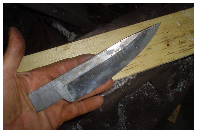

Cut blade shape.
Ground blade.

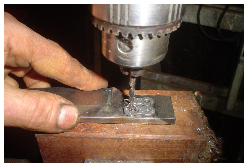

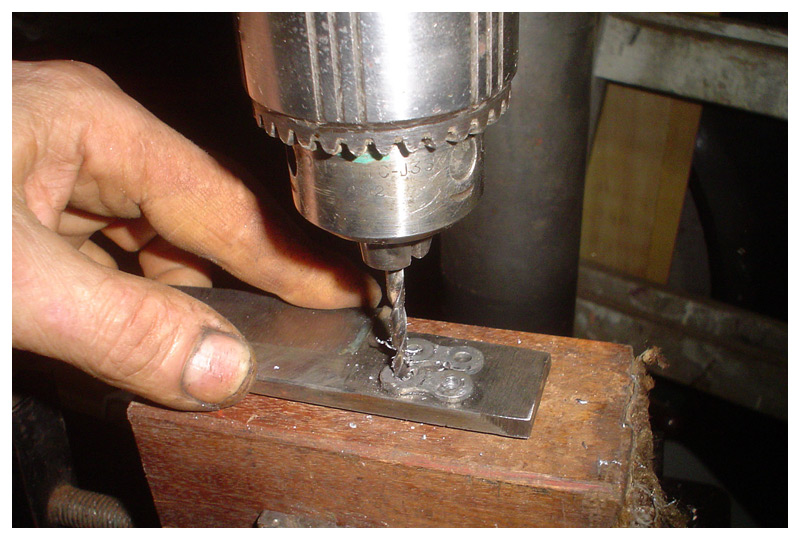

Drilling for the rivets to secure the handle.

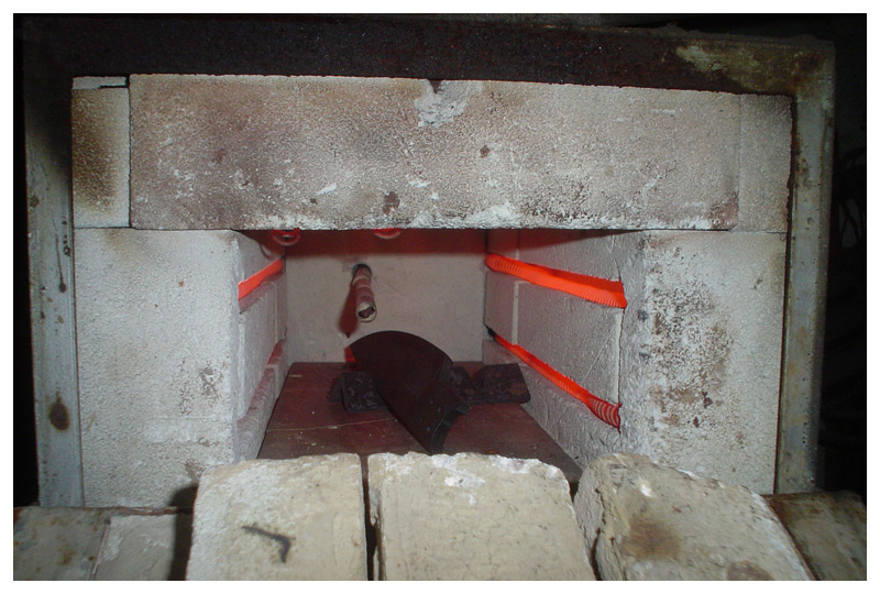

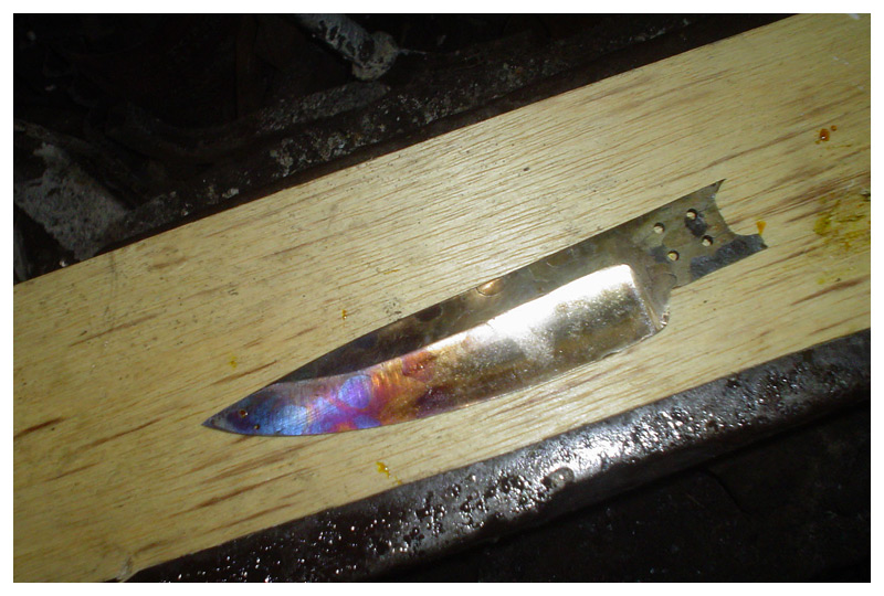

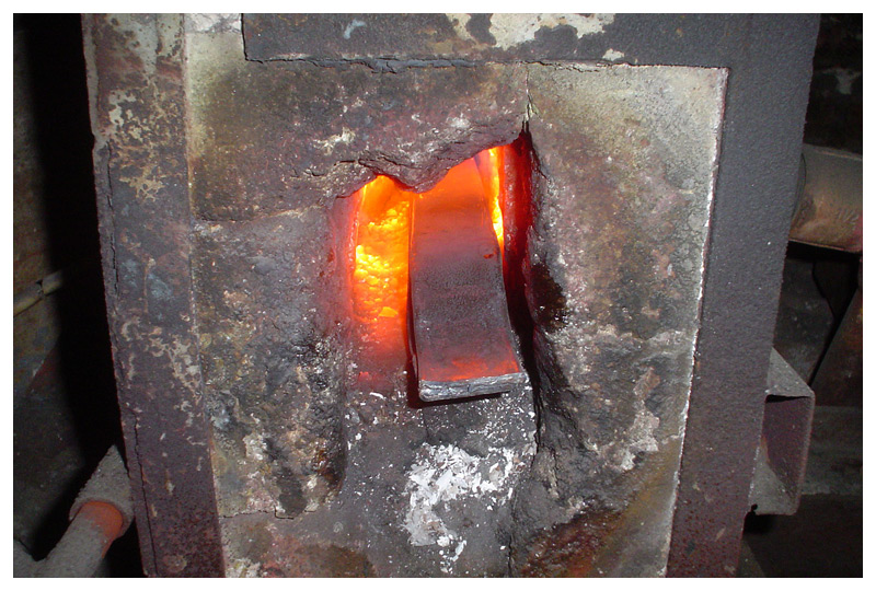

Tempering oven.

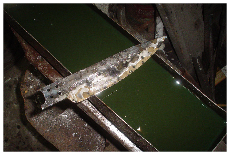

Quenching in oil at 80C
Second heat treating.

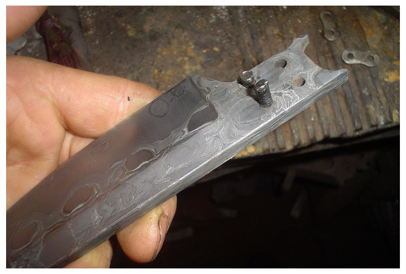

Placing the rivets to secure the chain handle.

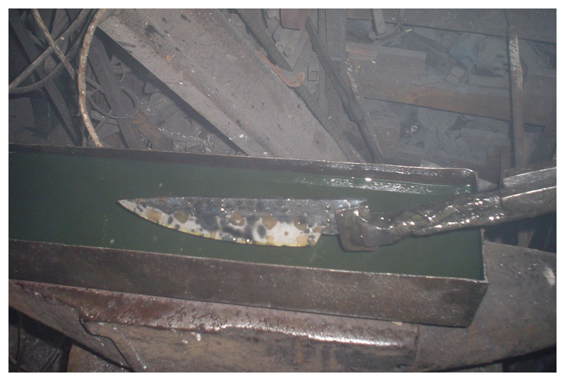

Blade is already etched, for a tutorial on etching a damascus blade, please go here: http://www.aescustomknives.com/docs/tutorial13.htm

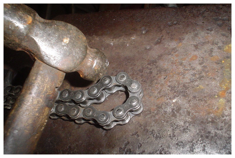

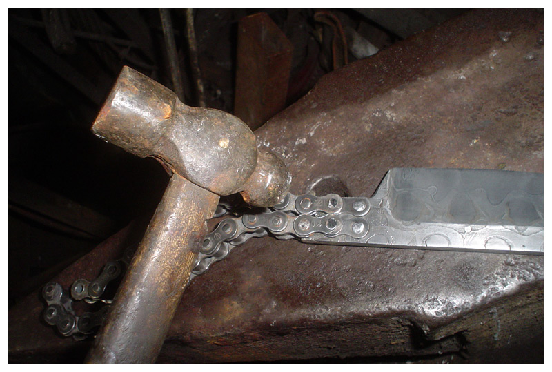

Hammering the rivets to fix the chain to the blade.
Blade secured to the chain.
Hammering each rivet after placing the chain in the desired handle position to secure it in place.

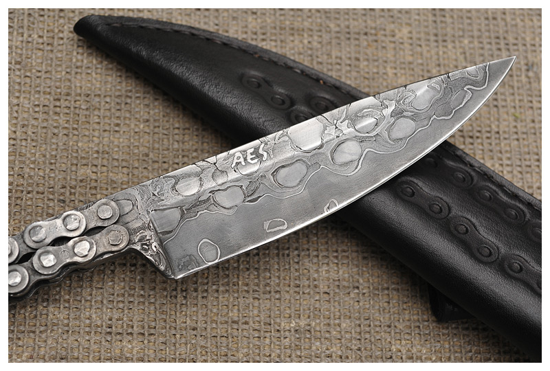

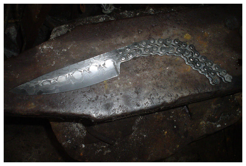

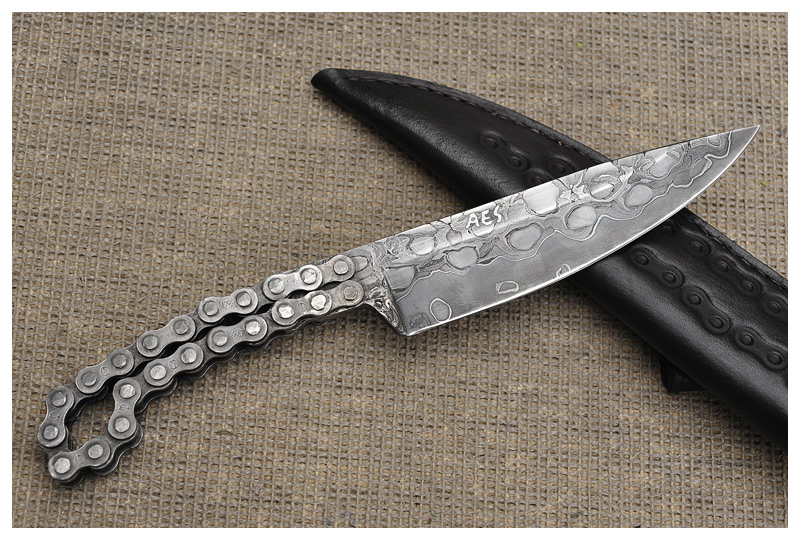

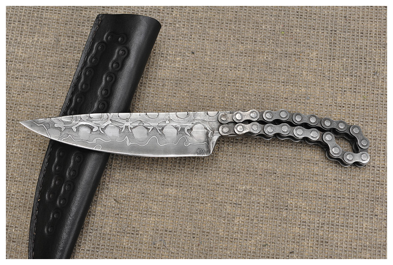

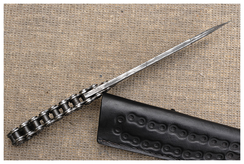

Finished Integral Motorcycle Chain Damascus Knife
Motorcycle Chain San Mai damascus with a 5160 core.
5 7/8" edge, 11 1/4" OAL, 5/16" thickness.

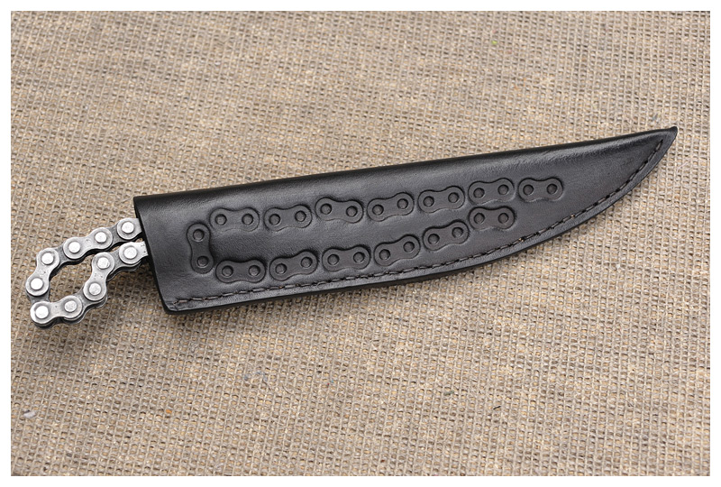

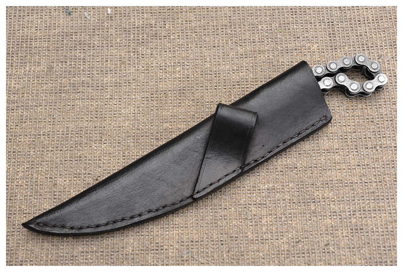

Heavy duty hand made leather sheath.
