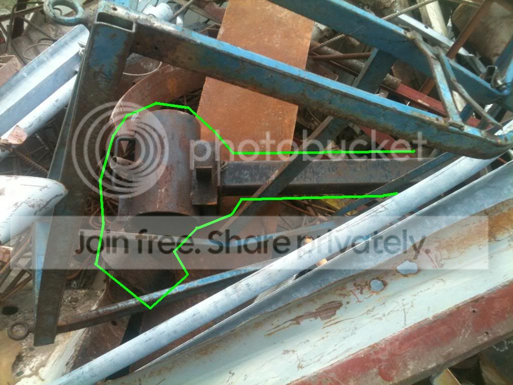

Hey Brett, I was just at metal recyclers in fwb off of beal by the mc donalds, cvs and tomb thumb. Think the cross street is green acres. in the pile of scrap on the right as you drive in there is a ready made forge. All you would have to do to it would be to line it with insulwool or refractory and put a burner in it to have a gas forge. It even has a door. I'll post a pic of it when I get home. if you go up there, talk to Lisa and she can point you to where it is. The only thing is, if they pull it out of the pile for you, she will expect you to buy it. If you pull it out and decide you don't want it, just put it back. Just guessing, it might weigh 40 to 80 pounds, maybe more. I think they sell stuff at .20 cents a pound? If you want a forge, this thing is perfect. The only reason I didn't get it is because I didnt have the cash on me.
It's a good looking forge from what I could see. The base looked to be about 3/4" steel plate (not in the picture). The upright is tube steel. In my opinion, it looks great. Hopefully there is nothing wrong with the other side. I was thinking about it all day today while riding around. I almost went back a couple of times to see how much it weighs and would cost. I had to keep saying " I don't need it, I don't need it." I have a book on how to build burners you could borrow if you wanted. I'll email you with my phone number. Call if you want and I'll tell you how to get out there if you don't know.
Edit: couldn't send you an email. you don't have it on your profile.
Oh man....good find Rob. I will be in that area tomorrow morning so I will go check it out. I'm pretty sure I know exactly where you are talking about. Hopefully the other side is in good shape. Thanks for the heads up. I'll let you know how it is. BTW.....email is rowlock@hotmail.com
