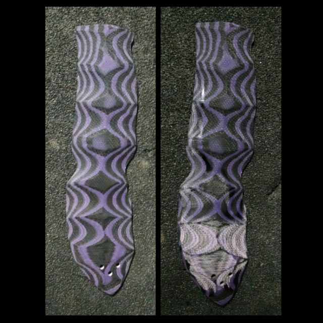

Hope this is the right place. I purchased this a few days ago: http://www.knifeworks.com/benchmade710-1401-M390.aspx
Haven't had a chance to really use it yet, but i do like the size, fit, and so far the sharpness. I carry it clipped in my pocket, which also has my keys and a zippo.
I took the knife out to admire it (why lie lol) and saw that it was already looking pretty worn. Now, as a daily carrier which i planned on doing, this isn't a deal breaker. Though, i am worried if it's wearing this fast. Will i soon be holding just a skeletonised frame? Does anyone else use/carry one of these and have a similar issue? Thanks!
Residue from the lighter maybe? G10 is pretty tough stuff, don't worry about wearing those scales out! Very nice knife by the way.

Guess this residue might be some random thing flaking on the keychain. Just glad it's not the knife. :D
G10 is extremely durable. It will last you a long time. Any pics of the knife after the WD-40 ?
G-10 is funny stuff. I have had mold growing on knife scales before, and it was surprisingly difficult to get rid of it. WD-40 does do wonders for it though.

havnt heard the WD40 trick I use those "Magic Eraser" sponges you get at any HD. Just get one end wet go at it then used the dry end to soak up this is in fact how I clean all my g10 has worked like magic every time
Magic eraser is great for getting dirt off g10. Apparently you can find it sold as melamine foam at a much cheaper price.
The wd40 is for when the g10 gets dried out. I tested some lighter fluid on a piece of g10 and it did turn white so I'm convinced that was the issue.

G-10 is a laminate and what you are seeing is the laminate turning white due to rubbing it with something harder. Same thing happens when you sand or drill it. I prefer rubbing a bit of light machine oil (3-in-1) on it with an old tooth brush. Shines it right up and looks as good as new.
Could be, but it takes more than just a light rub against something to do that. Can't imagine the scales got that beat up just from sitting in a pocket. Maybe a combination of both. Easy fix anyway.
Here's a scrap piece of g10 before and after lighter fluid:
Looks a little bit like G10 dust, don't you think?
Either way, (dust, scratched or dried out) any oil will restore a more vibrant finish to the G10 and rubbing alcohol is a great solvent for getting stuff off the G10 (including the oil).
