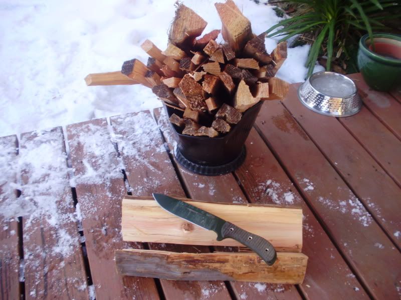

Full tang helps but it isn't necessary. I'm mixed. I've batonned all the knives I have bought. Actually the knife I used to own, but gave it away (in tact) that saw the most batoning was a hidden tang buck 119 special. That was when I first joined here and I spent that summer forgoing an axe in favor of the knife to see if it could be done. Over that summer I gained a lot of confidence in the technique.
Another thing that I learned that seems counter intuitive is that thicker is not necessarily better. Basically I find 1/8" to be about optimum but I've used 3/32" without problem and also use 3/16" readily enough. If find that the amount of force you need to pound on your knife is proportional to its thickness, at lease for tough to split wood. So 1/4" knife, while very strong, also has to suffer very hard hits in order to sink that fat bevel into the wood. For many of my knives, 1/8" thickness seems to be a really good compromise between rigidity and ease of batoning.
I also prefer a full flat grind plus convex edge for batoning. I don't have enough experience with full convex grind knives of different thicknesses to really compare this to full flat + convex edge.
Longer knives are easier to baton that knives that are just slightly longer than whatever it is you are batoning. I think that one is obvious.
Finally, batoning requires common sense. Some types of wood will split readily. Other pieces can be highly knotted and be extremely resistant to splitting. Just because you commence batoning a piece of wood doesn't mean you have to finish the job. If you are pounding away and not getting anywhere, rather than stepping up your force consider abandoning the task. Do you really need that piece of wood?
P.S. I have found that wood that is difficult to baton is also difficult to split with an axe. If you really need to split that stuff than a wedge and maul is the best way to go.
