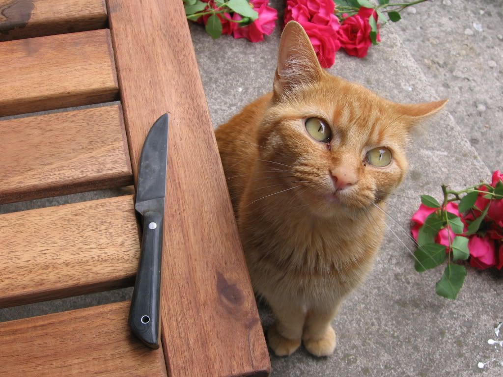

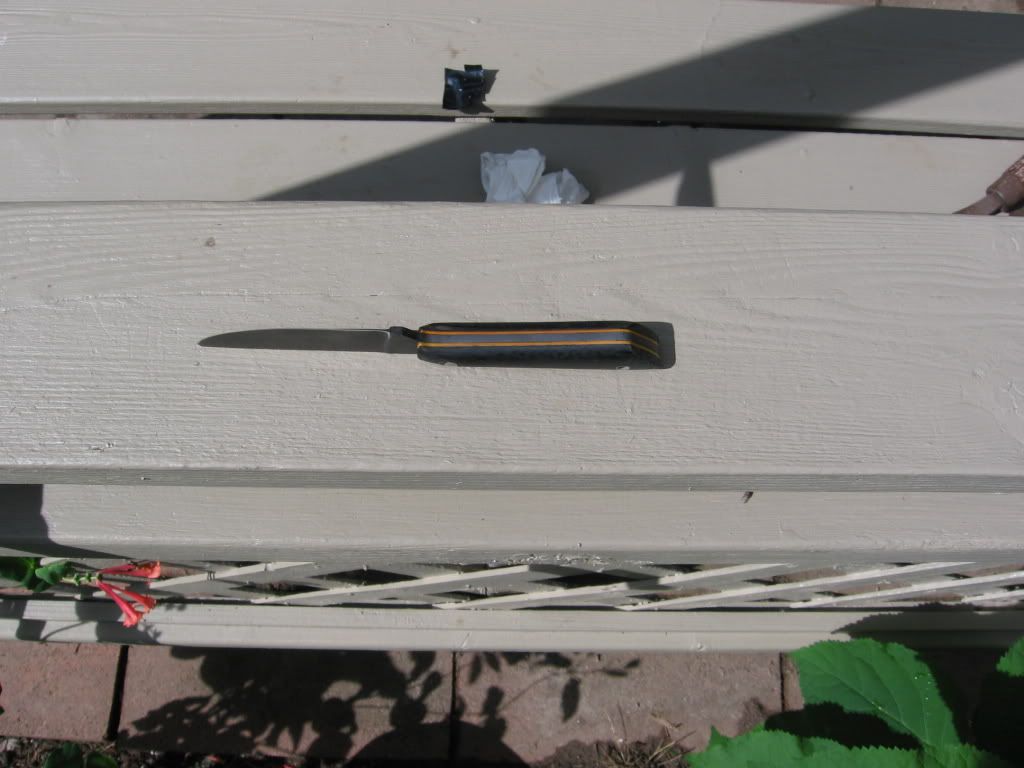

First up, my Opeongo eating knife. (And a Kitty)

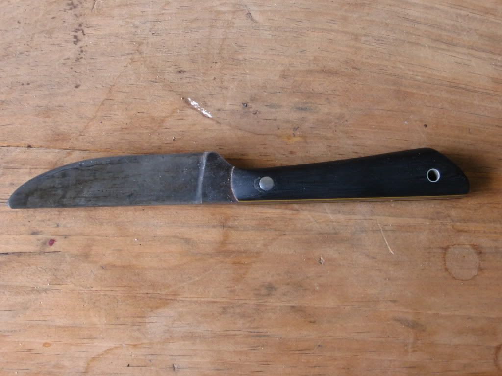

In the past I have found that cooking and eating were the two main uses of my small camp blades. I made this one in mind of that, working towards a sharpened butterknife shape.
OAL is 6.5 inches with a edge of 2.75 inches. Handle is black linen Micarta with Yellow liners, stainless steel pin and aluminum tube. Cracked one scale while hammering in a pin.
I broke the grind on the spine early on doing the bevels, but I continued on anyway and ground it as thin as I dared. Its a wicked little slicer, and has just a tiny bit of flex.

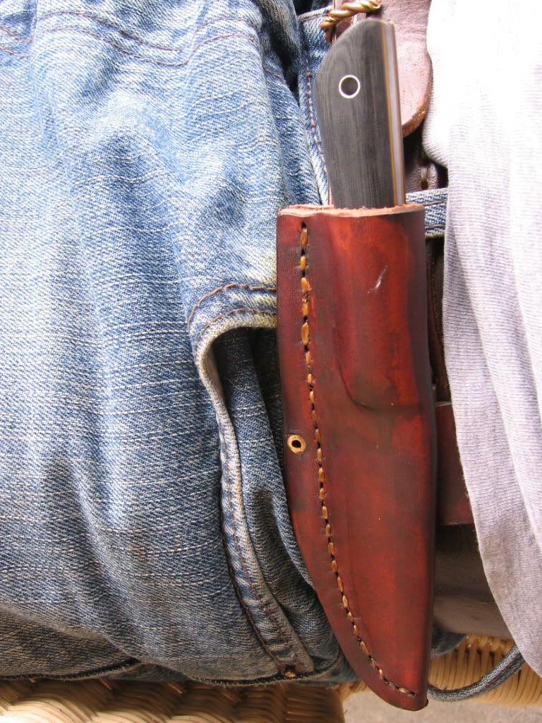

Made up a simple horizontal sheath, and it sits just left of the belt buckle. Piss poor dye job and no wax finish.
Here it is now.
