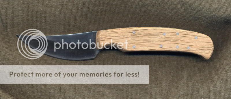

Here's a knife (brother made from a kit) using wood from a barn my Grandfather built.
