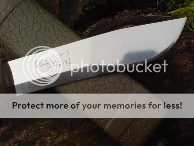

I've been thinking recently about a knife I'd like to have. A knife that would be big, around 9" of blade, full tang.
The best, to me, would be full convex grind, but with a few inches scandi at the bottom. Just imagine something like a serrated RTAK, but instead of the serrations, it's a thin scandi grind for precision work.
Are there many knives that have different grinds depending of where you are on the blade?
I know of some Mora:
And the Tracker:
If it doesn't exist, guess I'll have to refine the design and get one custom made.

Kiku knives have multiple grinds, the one I had was hollow ground next to the handle, convex near the tip and a smooth transition between the grinds. very cool.

Actually the M2K has only one grind,just one part of it is wider,and the grind of the tip is narrower,because the tip is really thin :)
I've been setting up my machetes like that for years. It is a very useful mod IMO but you do have to be careful when chopping not to impact the scandi portion if you can help it. A machete has a softer heat treat than a Leuku and you can roll the edge if you're not careful.
I've thought about modifying my BK-7 to have a scandi grind at the base. I just don't have the tools to make it look professional. I do the mods on a $6 machete with a file mainly and I don't want to do that to the BK-7.
The scandi grind at the base of a machete allows much greater control over the angle at which the cut can be made. It allows you to make precise cuts inside of notches and tight spaces. You can also thin the edge at the base and convex as normal so the blade will cut at a lower angle.

The bottom four or five inches on a machete edge stays sharp forever mainly because it is rarely used when chopping. Because it stays sharp that portion of the edge gets used all the time for non chopping knife tasks. Optimizing the edge there for those tasks just makes the machete more useful.

remember that some knives have multiple grinds without it being visually obvous at first- many scandinavian knives will have a variable angle grind as you go through the blade, often more obtsuse near the tip, more acute in the belly and front of the blade, and more obsutre again near the handle.
One way to work on this that would be fairly easy would be to 'deepen' one side of a convex or scandi grind for a 3 inch or so section near the handle. this would raise the edge a bit (giving you a defined section of new grind) as well as give a more chisel-grind like cutting geometry.

Take a longer blade Scandi and just convex the forward part of the blade. I have done this with a few of the 127 Mora's.
I kinda did this with my Becker 7. The first 3-4 inches near the handle is much thinner and has a more acute grind and I left the front part more obtuse for chopping purposes. Works pretty well.
