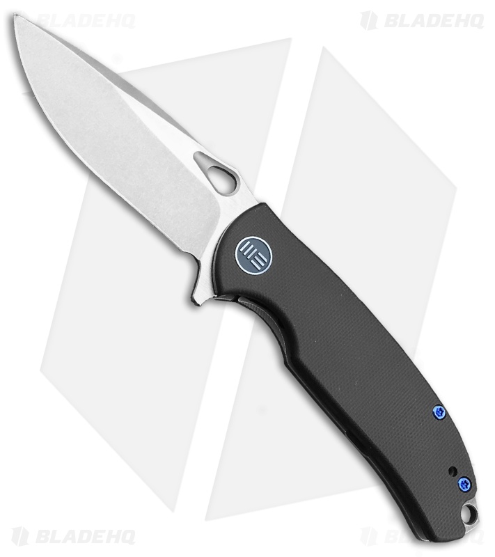

I was also thinking if this hole would become weak point of the knife, but as I see that many other knives, like We Rectifier, have similar holes, I guess it won't be a problem unless I abuse the knife.
