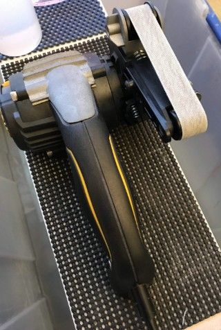

I've been reading up and watching videos on the KOWS because I wasn't satisfied with my results.
Based on the @bgentry youtube video, I removed the guides and started freehanding.
But I wasn't a fan of holding the knife vertically, it seemed like horizontal would have been more comfortable. I have an 8 month old at home, so money for hobbies has gone to diapers and such. So no blade grinding attachment for me
I saw another youtube video, and I can't find it so I can't attribute this to that person. But what he did is cut a notch so that the cassette would lock in place at a point of your choice.
That's what I did and now I'm able to grind horizontally, just like with the BGA.
NOTE: when cutting the notch (I used a dremel) do not make the notch too wide. If you do, the cassette will pivot a little, thus messing up your angle. Cut out a little at a time, and when the cassette clicks in snugly, you are good.
You can set your angle at whatever you feel comfortable with, I put it at about 15 degrees below horizontal so that I can hold the blade flat. It's up to you.
Think of it as freehanding without having to move the blade up or down the stone. You need to figure out the angle for each blade on your own.
Got my 0562 sharp enough to slice words off of a piece of paper...
