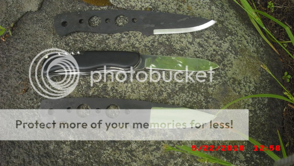

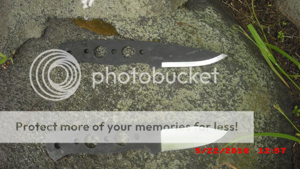

Howdy folks. As most of you know a while back Dan Koster was looking for people to review his new prototypes psk/bob style knives...These are down and dirty knives with no scales or sheaths... I got mine on saturday I opened the package and there was on scandi, and one hollowground version. Both where basic scaleless sharpened blanks (what you would expect in this style of knife)
they both shaved out of the box but after quick stropping where hair
popping.Here's the handsome couple:
These where designed I believe to be Compact knives that someone could inexpensively acquire and throw in a survival kit or BOB they have a short Necker style blade and a full length handle
Here they are next to a locking sak for perspective

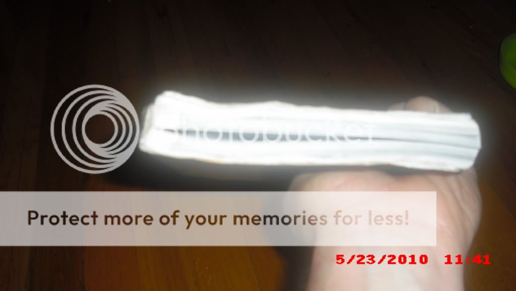

Just some perspective on how flat the blades are without a handle wrap or scale.. they could easily be stored between items in a small survival kit or bob

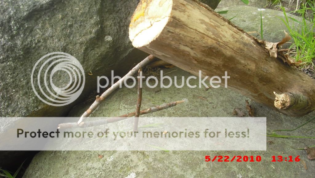

First thing I dod was use them in equal turns to carve a fig. 4 deadfall an easy skill but one that requires precise notching.. Both knives performed admirably with no real difference between the 2

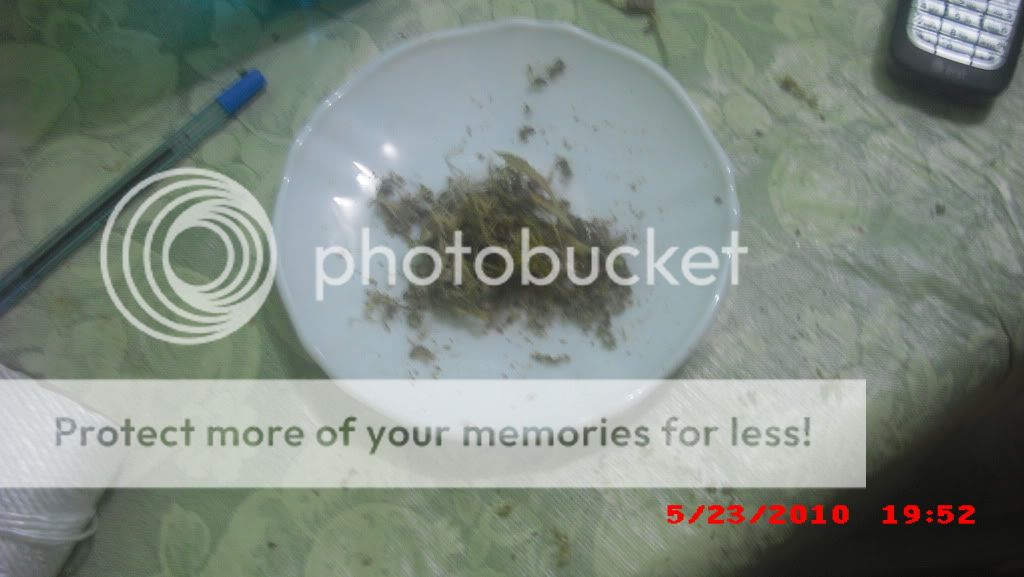

The Spine and the jimping on the thumb ramp are also great for scraping fine tinder fuzz from bark
scraped up a good amount

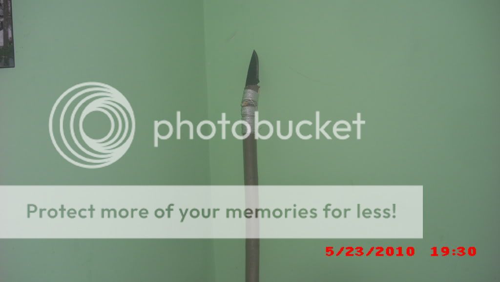

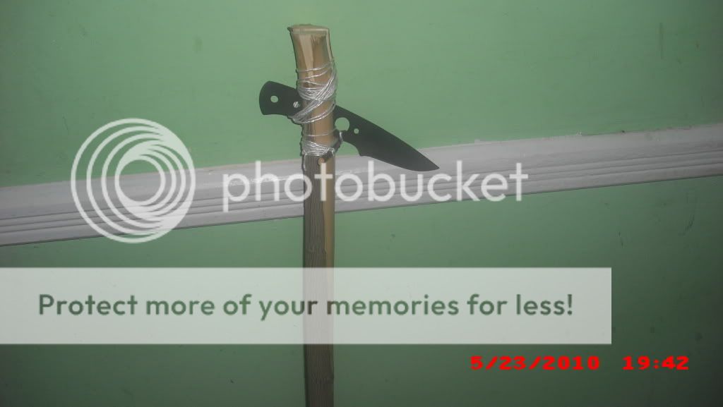

When used to split a partial section of a stave with a little lashing you can have a formidable spear as the flat scaleless design can easily be lashed in the space of the split
Or even a very secure Gaff for fishing, or harvesting edibles from the tops of trees

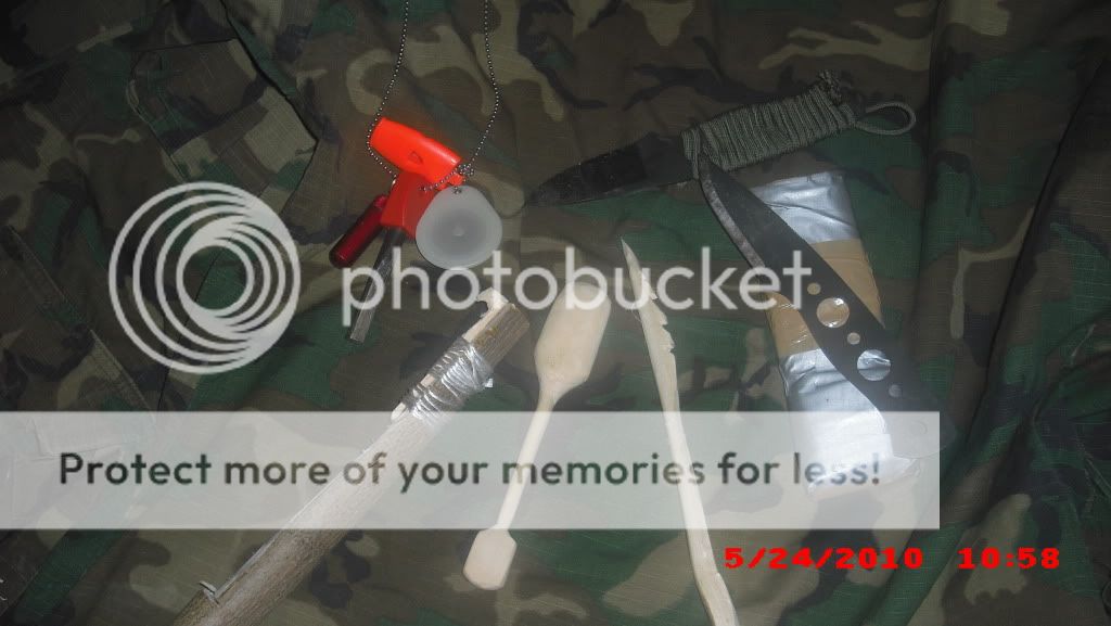

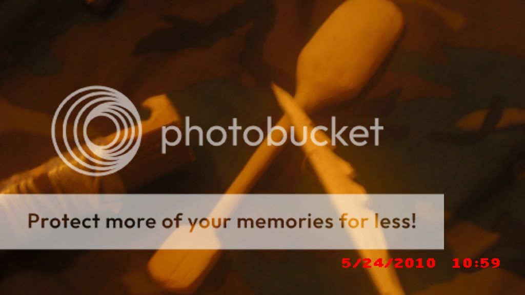

although it is easily lashable I'd preferably use it to carve a spear which brings us to the next aspect...carving I used them both equally to carve a spoon a harpoon point for fishing and to make a hook which I lashed to to a quicky atlatl
Both knives performed admirably with know real difference in "carvability despite the variances in edge geomoetry.
