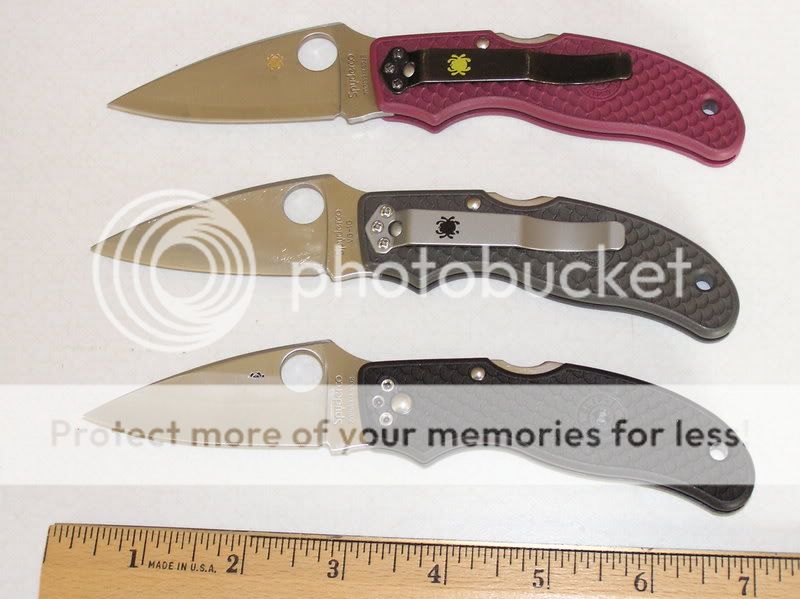

I use a Dozier Grinder with fresh belts for my regrinds.... that and lots of dunks in the water bucket!
Tom
And about 30 or 40 years of experience probably. Here is a comparison:
Stock on top, my regrind in the middle, Kreinage on the bottom. My dear wife looks at my attempt and asked if an angry beaver got ahold of it. Very funny. It might be ugly, but it works pretty good. But the one on the bottom works better. I leave the stock one for cutting through tanks and breaking up cinder blocks. ;)
Move along Sal, nothing to see here.... :D
