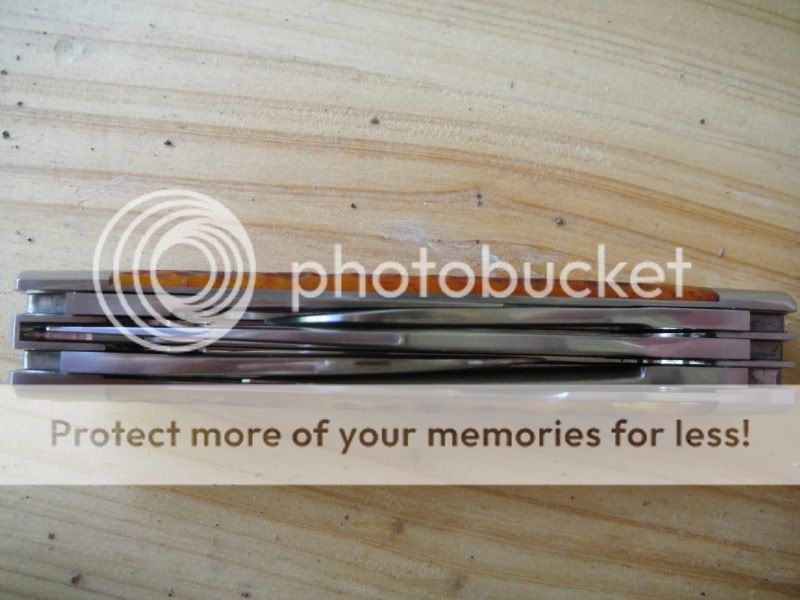

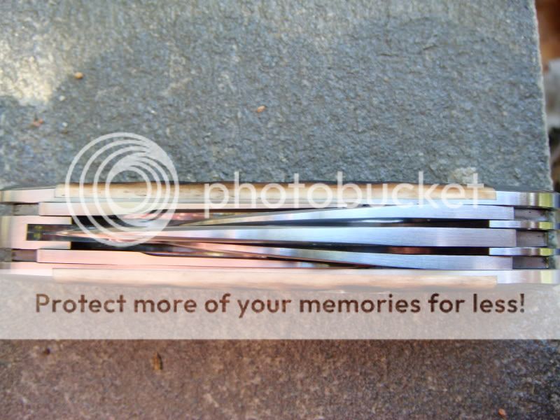

OK, now I'm confused - which is easy to do. I'm seeing two different things here.
The two blades on the left have small relief cuts to allow for the adjacent blades.
The two secondary blades on the right are deviated toward the master blade, again to allow room for the adjacent blades.
Which one is a 'krink'? And what is the other called?
