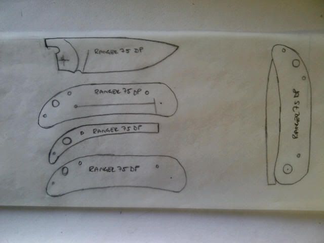

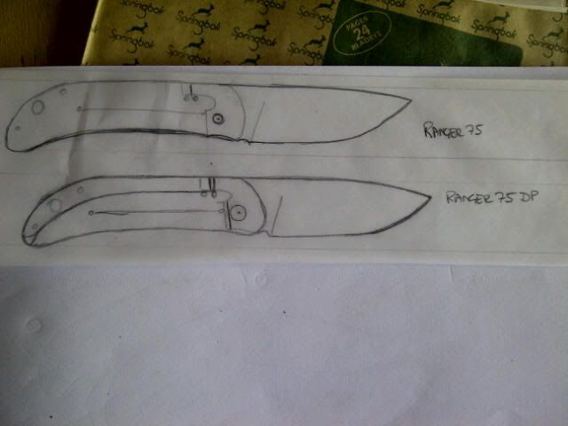

Design stage:

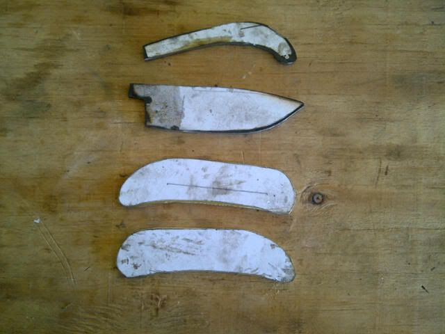

I chose the bottom of the two designs, with the point of the blade dropping more

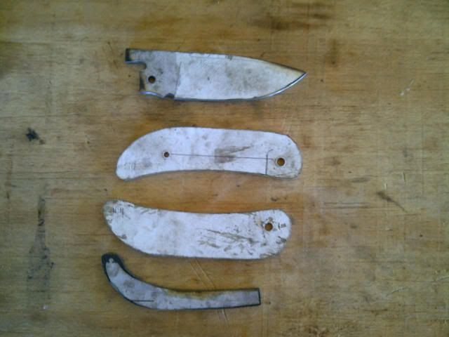

Drawing out the templates. I did a quick mock up drawing of how the knife would look closed, and I like it - simple, nice low profile, will fit the hand well in the closed position too:
Cut outs, rough:
Profiled, pivot hole and rear hole for lock drilled:

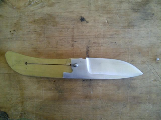

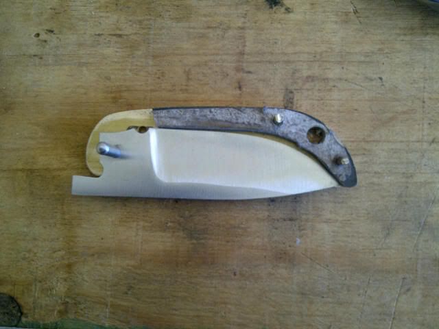

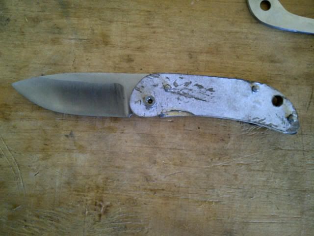

In this series the knife is initially shown with the initial grind done, an just initial fitting, later on the HT had been done, the final grind applied and more detailed checking for fit - you will note that in the first pics there is for instance no lanyard hole drilled and later on there is, as I progressed:

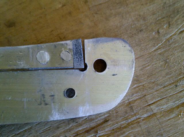

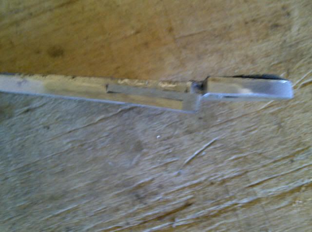

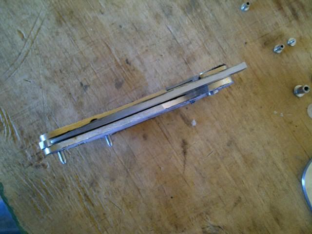

Once I was happy everything fitted well together, it was time to do the short, end cut, on the lock.
On this lock I decided to take a different approach than on the Ranger 90:
- On the 90 the lock is pure brass which I believe will give many years of good service, as proven by the likes of Camillus, Camco, Imperial, GEC etc etc with their brass liner locks - while it is softer than steel it is very "slippery" and wear resitant. In addition to this, the liner lock is assisted by a full friction folder tang, to take a lot of stresses off the liner.
- On this specific WK 75 there is no full length FF tang, so the lock will be absorbing more of the stresses. I have also been reading up on the problems a good many seem to be experiencing with especially Ti frame/liner locks, with wear etc causing lockrock and or binding/galling. So on this one I did a steel insert on the end of the lock.
- The steel insert is N690,l but not hardened. The thinking here is that you are going to get wear over time, no matter what, and having two hard surfaces wear on one another would probably result in the same amount of wear over time as one harder surface wearing on a softer one. AND, if you have to have wear, rather have it on the insert, which can be replaced when needed, than the blade, which is a lot more difficult to replace yourself. In the pics the insert is simply riveted on on production models it will be removable.
Please bear in mind when these pics were taken everything had just been "rough" assembled and will still be worked off quite a bit more:

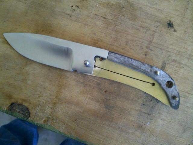

The insert:
This one is riveted on, on production models it will be removable:

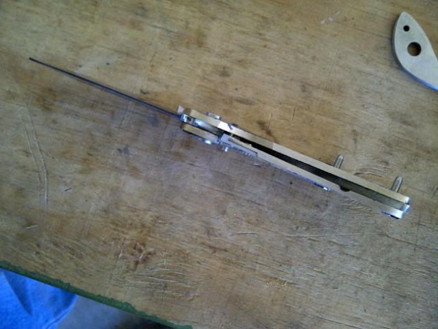

Knife open:
Closed. If anything appears slightly off center, please bear in mind that the knife has only been "pressed" together and isn't tight yet - and there is quite a bit of sideways pressure and torsion from the lock:

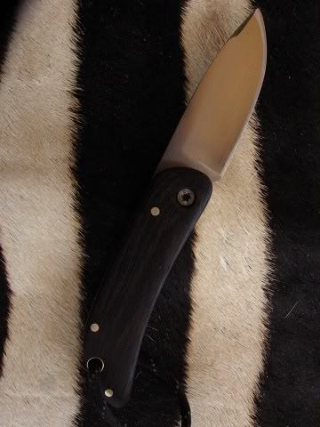

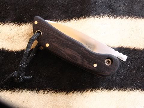

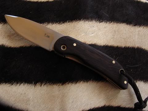

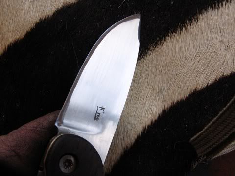

And done:

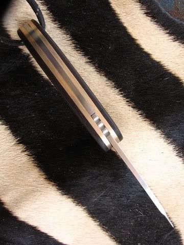

As can be seen from the pics, I cut a false edge/swedge on the front of the blade. On production models this will be optional.

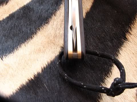

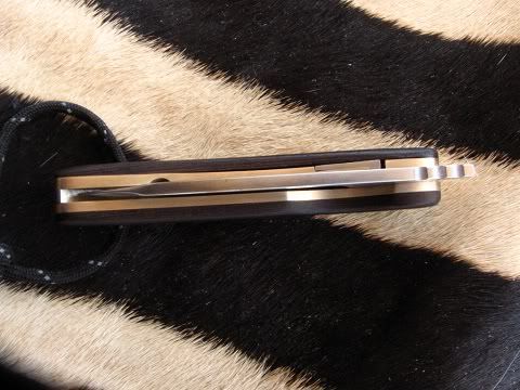

I added a little jimping to the tang, to assist with OHO:
False edge/swedge seen from the business end:
From the top:
Blade is handrubbed to 600 grit satin - this will be the standard on production models too. Finer grit finishes will be available as optional extras.

It is a proto-type, built mainly to see how the big 90 works out when scaled down a little - and I am very happy with it. There will be small changes to production models, like removable inserts etc, but essentially this is the knife.
Blade, in this case, is 3.25mm N690, as is the back strap. Brass liners and fittings, with an N690 stainless steel insert for the lock, Wenge scales.
