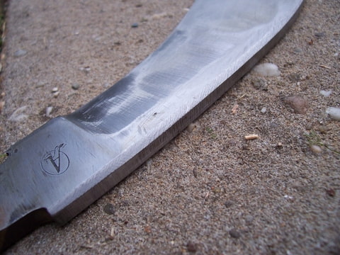

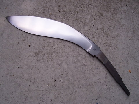

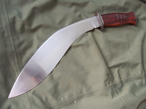

Here's a Kukhri I'm working on. It's my first and must say that it was quit a challenge to forge properly. Simple things like checking for straightness are a bit more difficult because of the shape with all the "waves". It is a very fun type of knife to make, the size and the feeling that you get when you hold it (I want to chop at everything within my reach) are great.

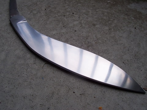

The first section of the blade from the ricasso is a flat grind which ends in a zero edge for fine cutting. The belly of the blade has a convex grind for chopping.
Ok here are some pics:

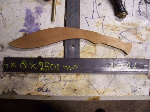

blade steel 1.5026
Template + steel

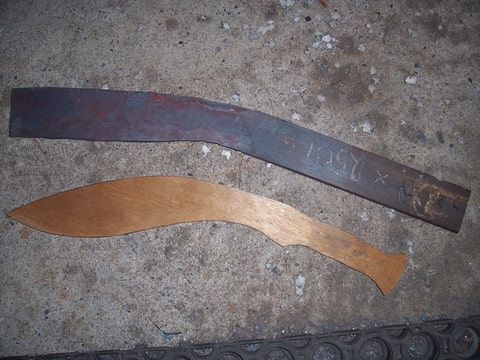

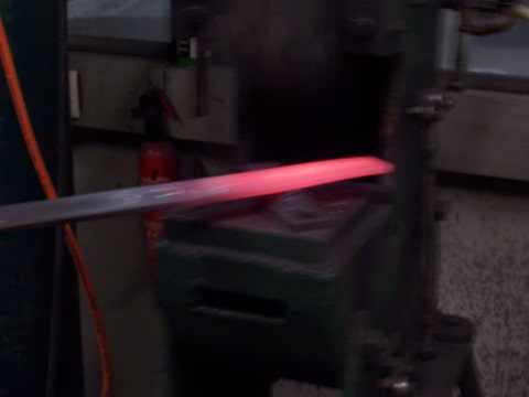

Tapered the steel and started the curve

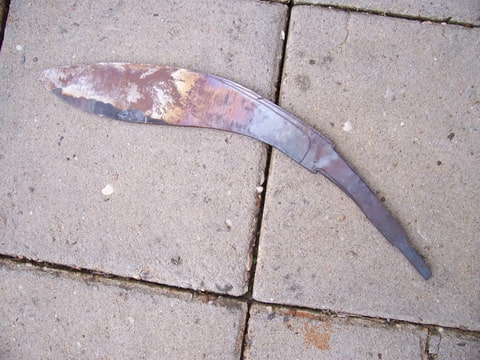

ready for heat treat
this was the blade before heat treat with the markings for grinding.

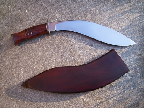

The blade finished with stones up to 600 grit

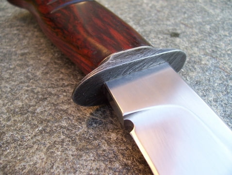

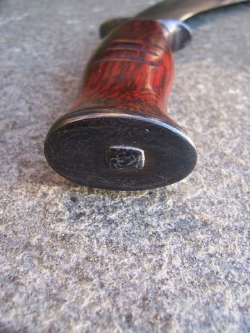

and here it is with the cable damascus guard and pommel, cocobolo grip and nickel silver spacer. It is ready for gluing and peening.
