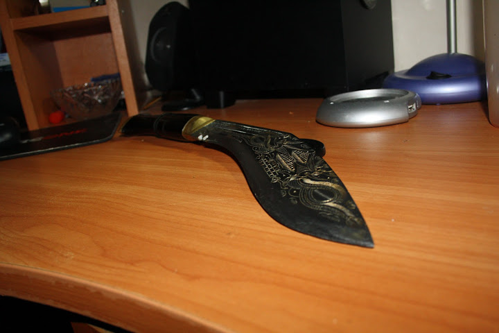

Many months back, I was chopping some small, unsightly trees at my summer cottage. I, being unaware of the right way to chop with a kukri, chopped with the tip section of the blade, and accidentally hit a rock. The edge rolled, and I spent hours with the karda, sandpaper, a file and a dremel, trying to repair it. The edge looks kind of better now, but it still has a small rolled section and lots of crappy grind marks.
Also, kukri pr0nz. :jerkit:
By the way, I don't have a strop, if one is necessary to repair this, could I use a leather belt and metal polish?

OK, I'm filing it with my Leatherman Blast right now. What grits do you think are best, and are the grit values international? How would I polish the bevel, just regular metal polish?
Convex right?
If so I wouldn't even worry about the file and just start with some 120 grit sandpaper.

Yeah, using the dremel was pretty stupid. Could I get just 120 and something really fine (Such as?) and polish the rest of the way? Also, can I use sandpaper intended for wood, and when sanding, I can just sand the front section, right?

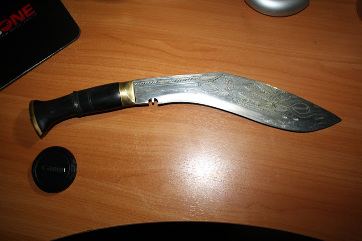

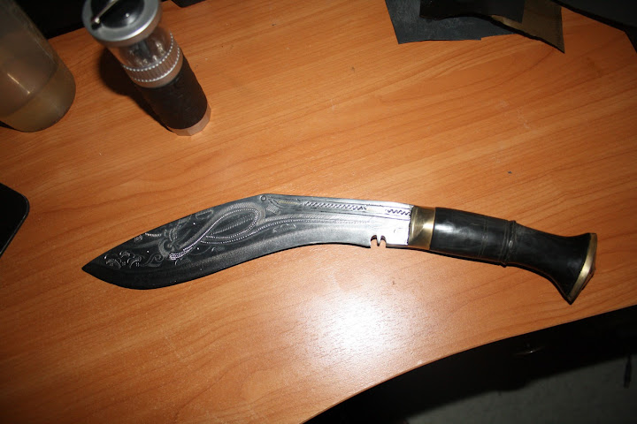

So. I sanded the blade with 800-grit wet paper, sharpened the blade with the karda, scrubbed the entire knife with lighter fluid to clean the engravings, polished the blade and the brass bits and oiled the whole thing with MPL-20.
You can still see some scratch marks from my cameras epicly well focused pics and if you look close enough, but this is good enough for me. I can still sand it some more if I want since I just used a little strip of sandpaper, but this is good for now.
