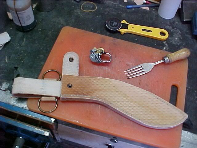

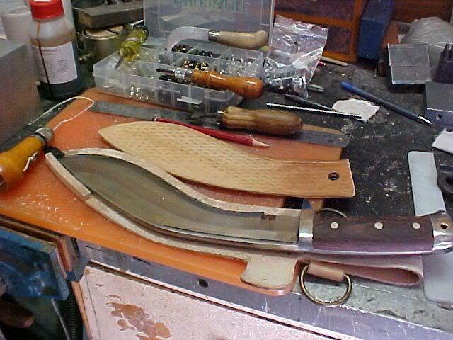

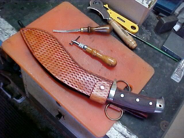

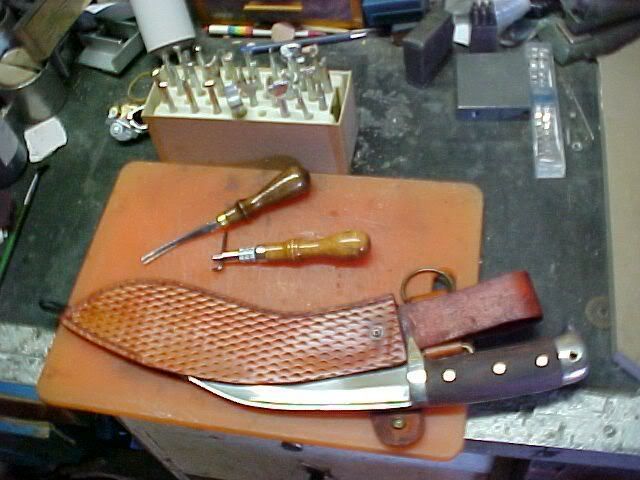

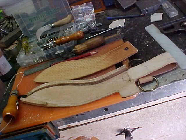

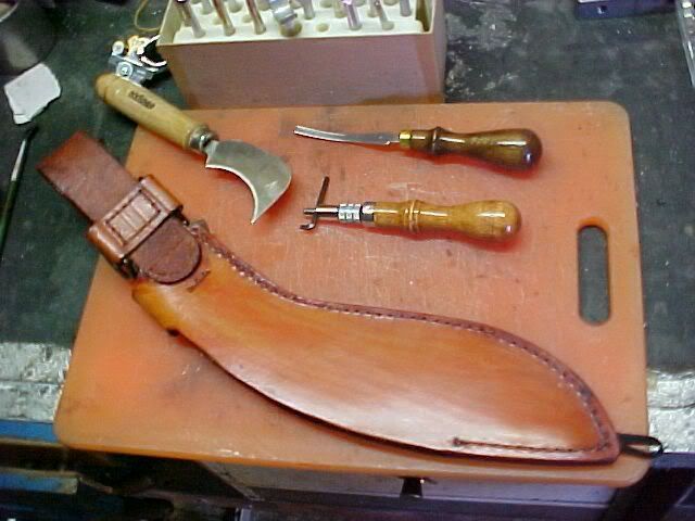

Hi, A few pictures of my first quick draw sheath.
I may still have to make a over shoulder strap if the customer wants one, I fitted the "D" rings and leg loop so he can tie it to his pack.
Don't look at the knife just yet, it's in for a complete make over.
+ - comments welcome as usual.
Richard

Thank you for your comments guys.
Any one care to guess how the pattern was put on the front panel.
Richard
Give the man a star.
Richard
Good idea to use as a stamping tool, do you use anything else that is different such as broken bits of concrete etc? When I suggested the rasp I though that it would be hard to line up and get such an even pattern. Very nice work.
I have pressed the wet leather onto a very course sand paper it gives it a nice texture, with this one I just used the kydex press to get the pattern
