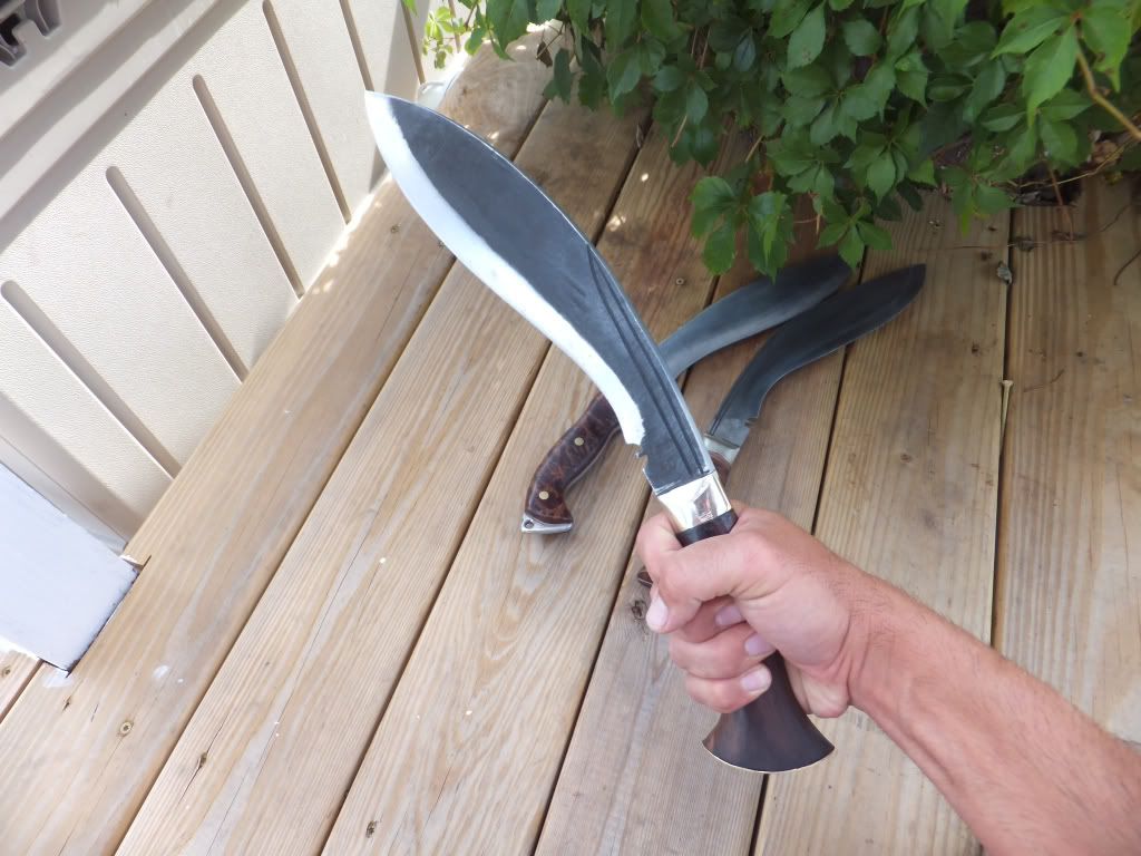

mine is full tang, custom khukri from Dragon Forge, hand made in USA! this beast is named "THE BOSS" and it powers through wood

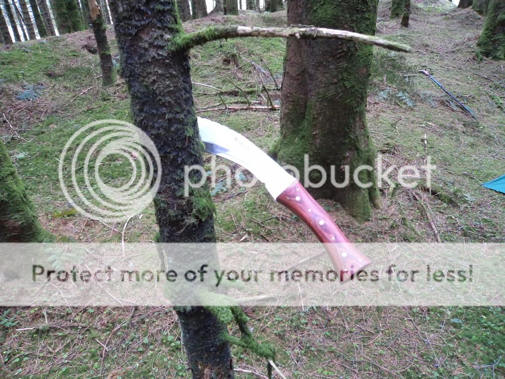

I think this litte bugger is around 12" and it has a full tang.
It's a true sharpened prybar.

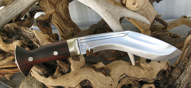

It really depends on what brand of khukuri you are talking about. Traditional Khukuri manufacturers will offer both, due to tradition.
Modern manfacturers producing KLO's will usually only offer hidden tang due to ease of manufacture.

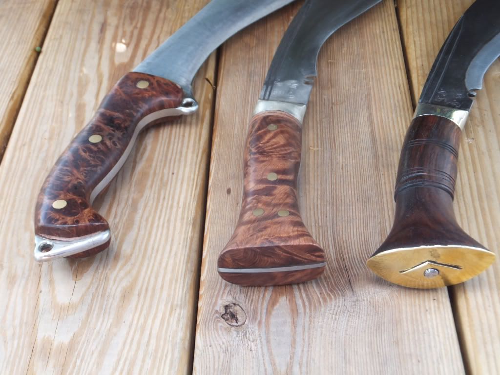

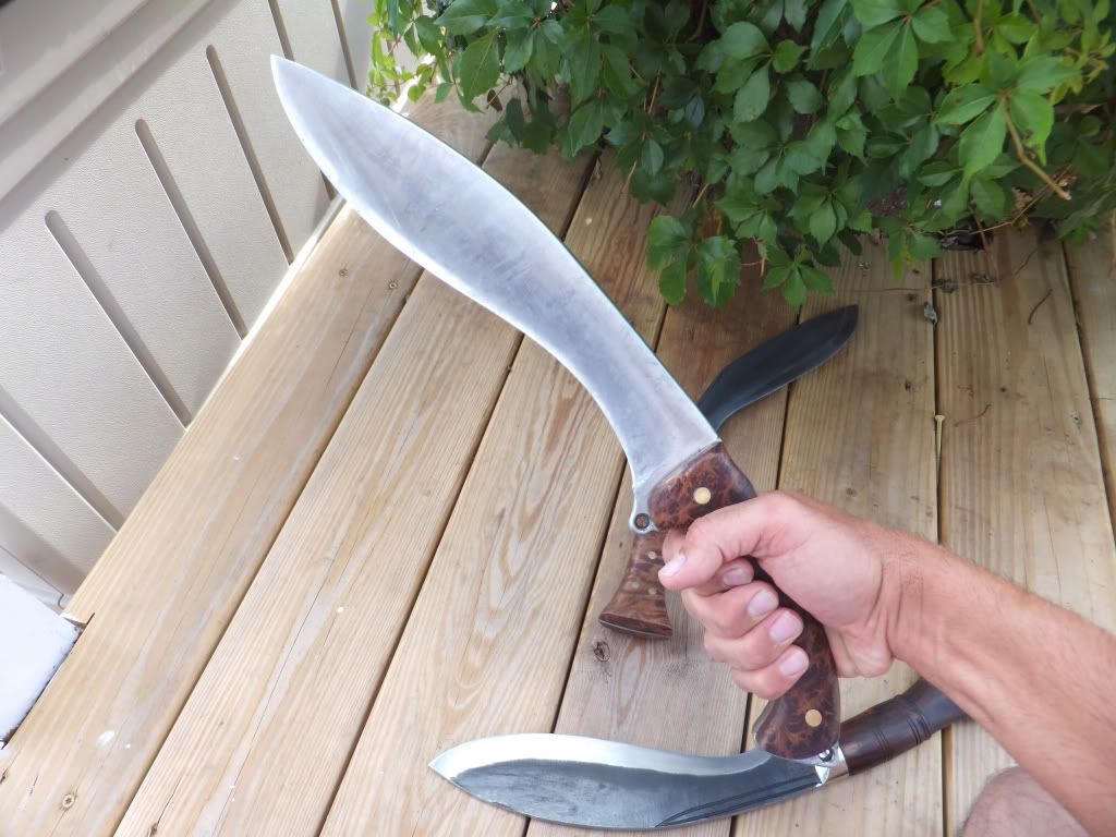

It sounds like your question is why are some khuks made without a full, handle width tang. First off, historically khukuri were made with a partial tang extending only part way into the handle. The reason for this is unknown to me, but could've involved saving steel for the area it was needed most, the blade. It could also be that it gave the best balance for it's use. Around WWI, as far as I know, we started to see the full length "stick" tang khuks made. Why? I don't have a clue, but would guess it could've been the English influence as the British issue Mk. I may be the first large scale production full length stick tang khukuri. The Mk. II seems the first khuk made to any degree which had an actual full sized tang and slab handles. It came out during WWI and continued into WWII, where it was replaced with another full sized tang, the Mk. III. This khuk still see some use in the Indian Army I believe, but the Brits went back to a stick tang in the 1960s (?).
The traditional partial tang seems plenty strong to people who use them regularly. Simon, of Tora Blades, stated the full sized tang was actually easier for the kami to make as it's simple to attach slabs of wood, as opposed to making a long narrow hole to fit a curved tang. Hopefully, I'm quoting him properly on that. His problem with this is that he says it ruins the balance and slab handles are not as secure and tend to become lose sooner than a stick tang. I like a full sized tang, but I think it makes a tougher blade overall. I can also replace handle slabs if need be. A stick tang is beyond my skill level, but is not an issue in Nepal. My personal belief is that the full sized khuk tang is a British invention and it seems to have been unpopular with Gurkha, as well as many others due to balance and weight issues.
It seems a full sized tang feels best to many if it tapers from bolster to pommel. A stick tang can be full spine thickness. How that affects strength I can't say. I can say I had several HI stick tang khuks X-rayed and it would take some real force to break or bend them. I don't question the strength of mine one bit. I've beat one in particular pretty hard and it handles heavy use very well.
So, it's not ease of manufacture nor is it solely tradition which keeps the stick tang alive. Many regular khuk users just prefer the stick tang and I can't argue against it, other than myself preferring extra "insurance" and being able to repair/replace a full sized tang/slab combo easier. Take care.
