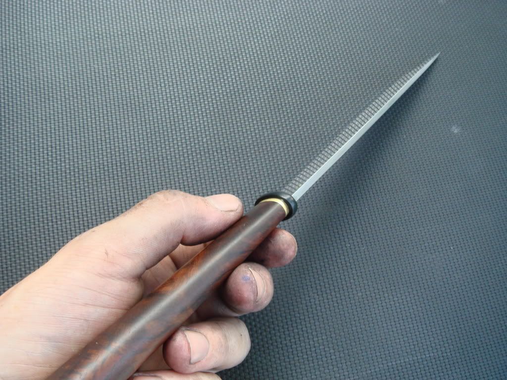

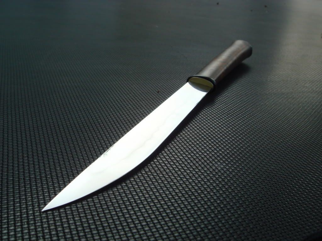

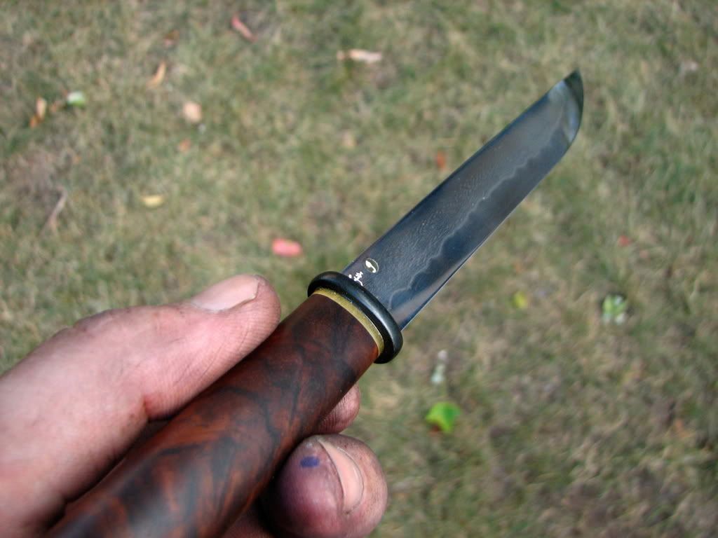

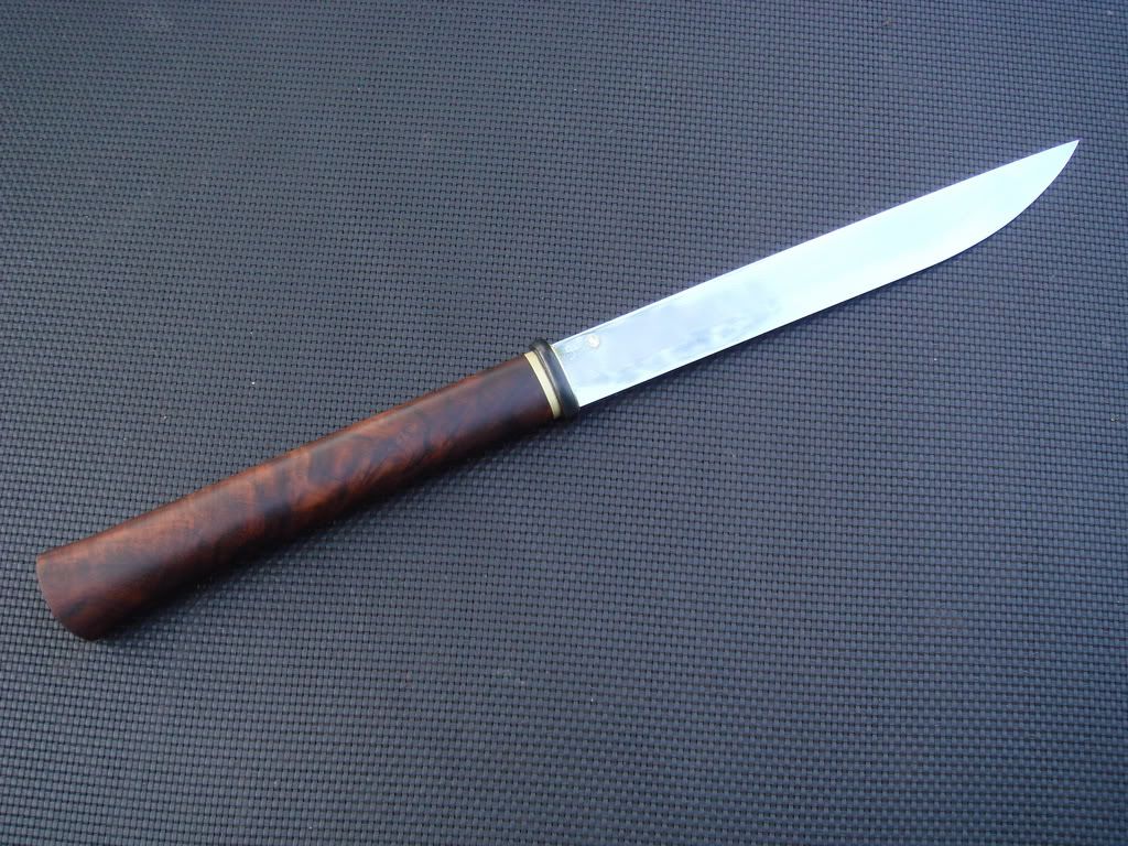

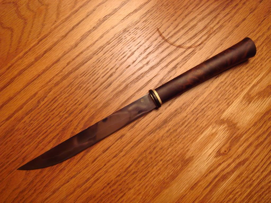

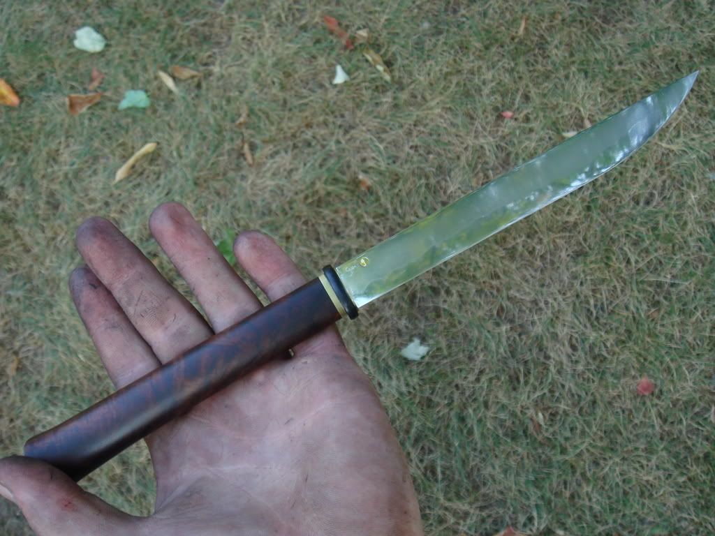

okay this was one of those projects that i just had alot of fun doing. i was designing a knife with a freind of mine. we were trying to make something small and delicate but no nonsense. but it needed some... bite. and here is what we came up with. she helped with the designing... and i did the work. i made the blade and all the hardware yesterday then i finished the handle and polished the blade today.
the blade is 1095, with a grenedillo handle brass and micarta hardware and i clayed the blade and tried out my Parks #50 turned out good.
i think i will prolly do some more of this design.. so comments would be appreciated.
thanks for looking!
~Chris

You did good with that hamon....nice polish. :thumbup:

thanks guys... heh.. i admit the pictures came out pretty good... oh but you have to hold it. it is my favorite so far. the blade is soooooo alive feeling... but specs... we need specs

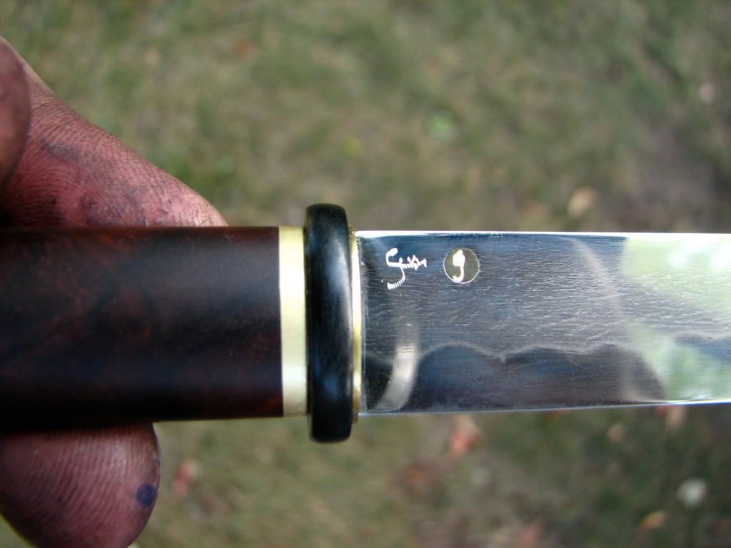

1095 clayed blade
Parks #50 quenched
double tempered
polished to 600 grit then buffed
light FC etch
Brass seppa and spacer
Micarta "tsuba"

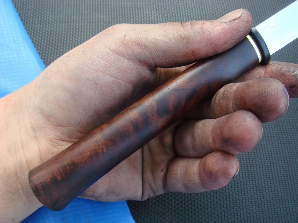

Grenedillo burl handle one peice (that is just oil on the handle..)
almost full length, hidden tang
11 3/4" OAL
6 1/2" blade 1/8" thick distal tapered

oh and quick note on the designing...
we kinda worked through the designing process together... but my freind had the final say. in the end we worked of an existing design... but i don know who made it... i dont think it was joe blow... anybody know who made this knife so i can give them credit for it?
we designed handle fittings and hamon.. blade was done like in the pic... turned out good. very gracful

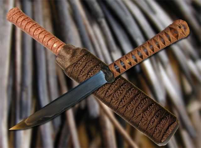

the clay is drying on it as we speak. i forged a knife from the come cable.. it is about an inch longer but a tad beefier. thicker and wider. i Told Grace (the girl who helped me) that is was the guy version.
but i was planning on a slightly bigger gaurd... but not much. i got the idea of this style fittings from here:
its a sword made my walter sorrel.. and i liked the look of the small tsuba. but it will be a tad bigger on this next one.
