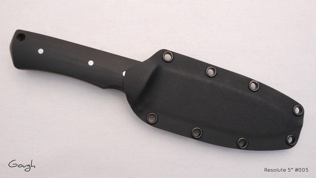

I'm quite happy with the construction of my Kydex sheaths, except for the belt loop designs. Previously I had made my own belt loops that attached via a chicago screw like so:
(note the photo only shows one loop, as it was the photo which showed the loops the best, there would be 2 supplied)
I wasn't happy with this, so yesterday I tried a tek-lock as a replacement. Basically the tek-lock is attached to a sub-plate of kydex, which is in turn attached to the sheath using chicago screws.
I didn't mold in any space between the sub-plate and the sheath however and I found that the tek-lock screws pushed against the sheath and made the blade bind. I'm sure this can be fixed by molding in some space, but it still seems a little less than ideal to me.
Would anyone care to make any recommendations for belt attachment methods that they're happy with, either on their own knives or those of others? Photos would be a great help!
This is what my sheaths currently look like without any belt loop system attached:
Thanks guys!
-Aaron
