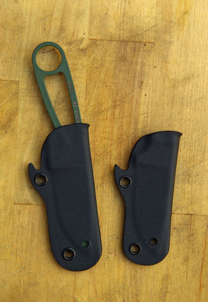

Another
The left one is a bit quicker to draw.
I leveled the outline with a little piece of leather I cut to size and taped to the knife.
The right one has the snap. I only put a thin piece of masking tape on the blade to create a litlle bit of room.
I like to use a layer or two of masking tape but keep the tip (maybe 1/4") exposed so it doesn't rattle around.
