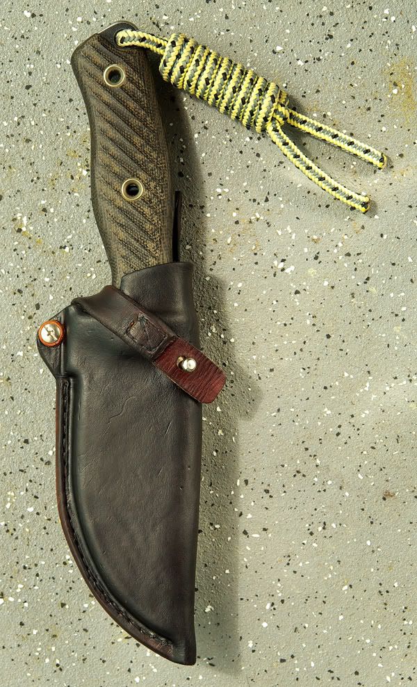

My mission was to improve some stuff that I was not 100% happy about on my Ratweiler Sheath ( http://www.bladeforums.com/forums/showthread.php?t=553532). And to see if I was capable of doing that kind of sheath again.
Improvements:
For the rest it is the same as the Ratweiler sheath.. Its very comfortable to use..
Hope you enjoy the pics..
Improvements:
- Retentionstrap has got a hole of very tough lappleather, which is more resistant to wearing out, and will last longer.
- Retentionstrap is easier to attach to the riflebutton.
- Screws are inserted during wetmolding, so the screws are sunken into the leather and there´s no space between leather and kydex.
