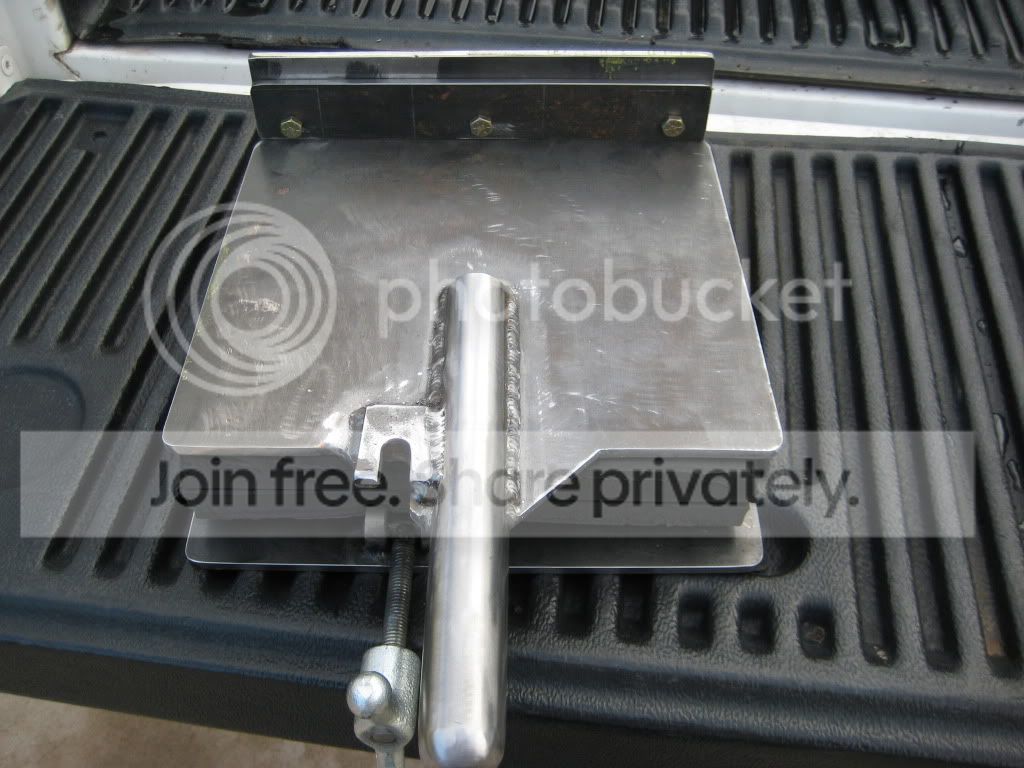

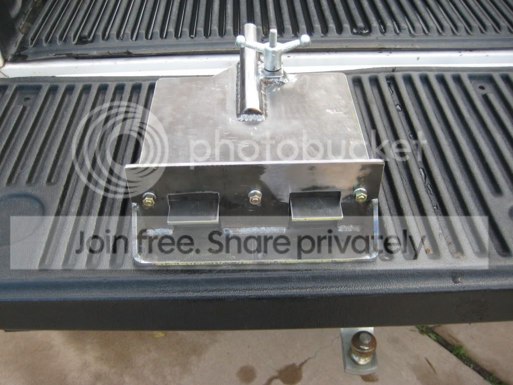

If you are looking for ideas on the design I made one up a while back, A few people here and on the spydie forums very generous in helping me gather info before I built mine and I don't mind sharing my design, I also use the USA knife maker foam and it seems very durable. I was not very happy with the plywood vise method, pretty time consuming the few times I tried it, easier for me to flip it and lock it down and retain as much heat as possible I thought. The back plate on mine comes off and I made a couple others to adjust the height, I found when doing handguns its nice to have a little adjustment, also for varying foam thickness, again could just be my preference. One thing I really like about it is its very rigid and I can really cinch it down tight with the lock. I did paint it black before I put the foam on more permanently with velcro. If anyone has any questions you think I may be able to help with feel free to PM or email me.....
