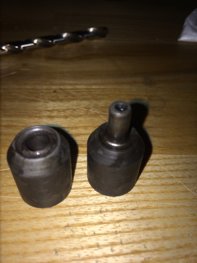

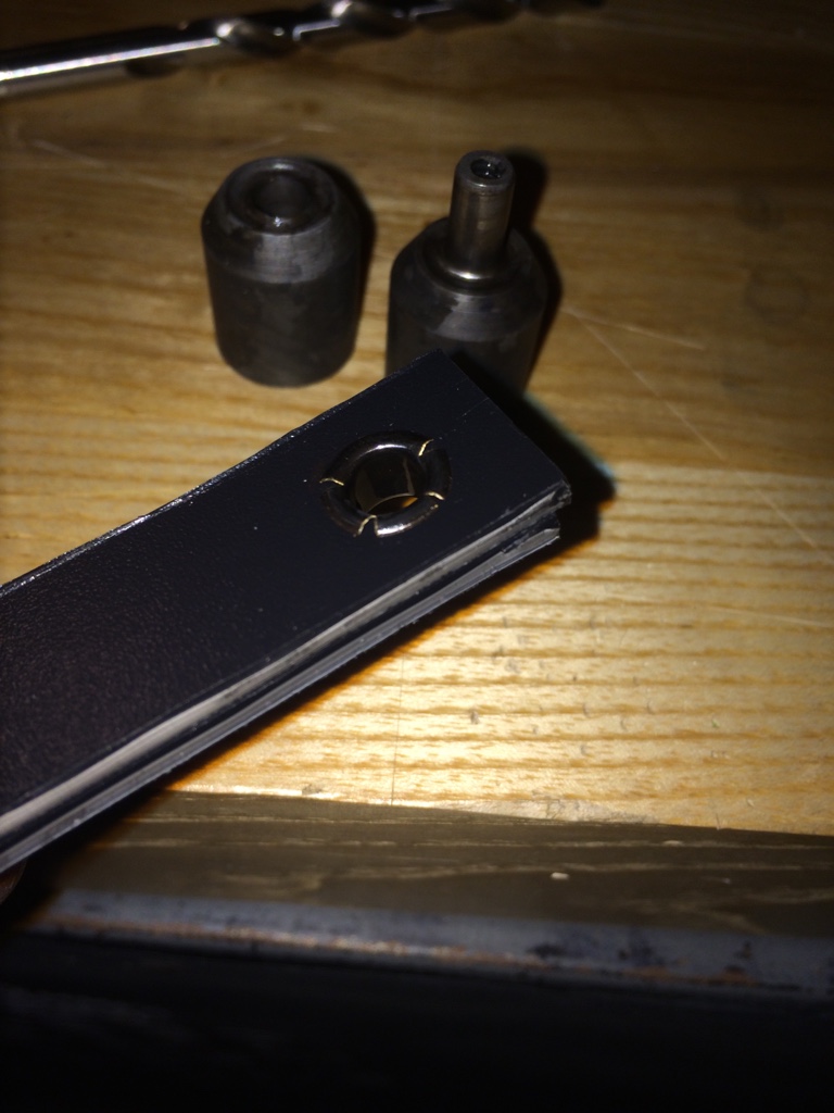

Hi so I'm trying to make a kydex sheath and using 1/4 eyelets from usaknifemaker. They sell a die set for setting the rivers but it's almost 50 dollars. So as a frugal machinist I figured why not make my own. So I made these that look like I imagine theirs to be. However this is the result I get. The eyelet rolls over cleanly but tears at a couple spots around the circumference. I was wondering if anybody had any thoughts or ideas. Aside from stop being cheap and buy the die set of course.
My best guess would be that the flaring area is too wide. The geometry is pretty touchy. I can shoot you a close up of my USAKnifemaker dies this weekend if that'll help.
Could be a few things
Kiah is spot on about the geometry 1st off.
If you are pressing more than a 100 or a 1000 eyelets the dies are a great investment.
Also you may look at these things
The eyelets can be hardened too much ( I have had this happen in a few bad batches of eyelets)
use a little oil
Steady pressure works better than quick and fast strikes.
Polished rolling area is best.
Yeah, I got a batch once that split every single time. Turned out that they had been ran too thin.
