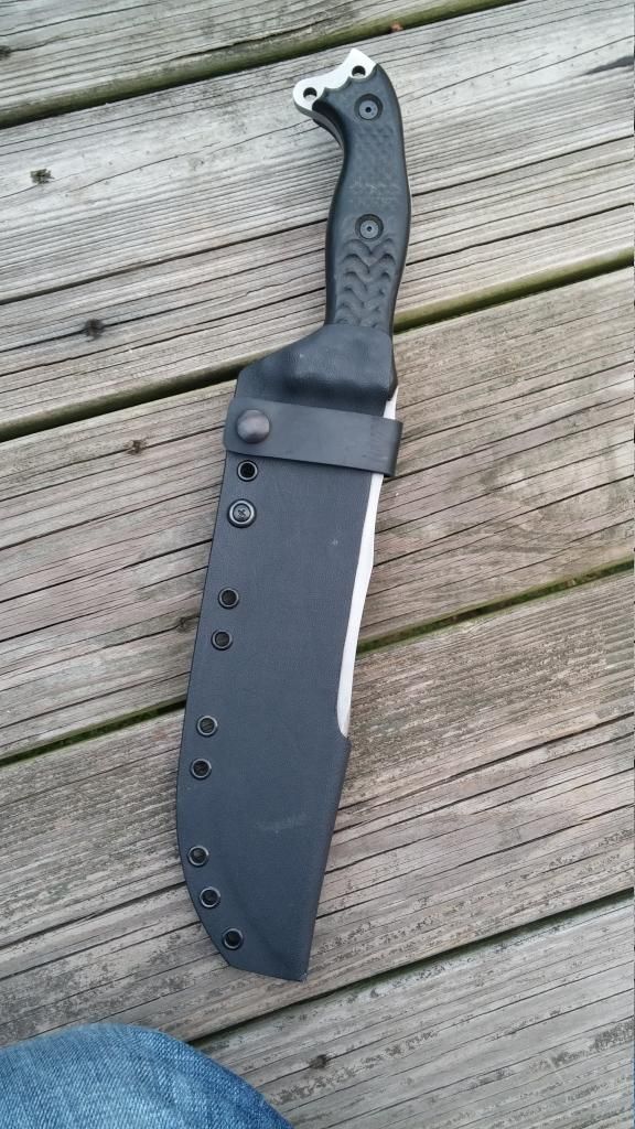

Pics or it didn't happen :)
Large:
Small:

2 Questions:
1. Did you bend those yourself?
2. Will you craft me some?
OUTSTANDING!
1. Yes, they are mine. Still need to refine my skills for consistency and finish.
2. Wouldn't mind doing something for you,just because I've enjoyed your posts through the years. But, 1, I'm not in the business,just yet. And 2, my job that pays the bills, keeps me busy 60 hours a week. Haven't made the time to sheath all my personal knives.
