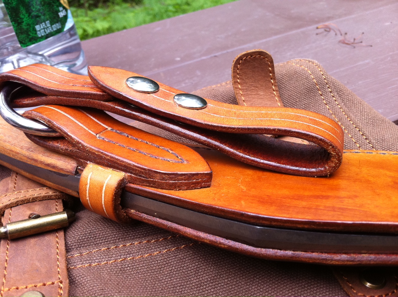

So that's about $85 total. And you can skip the dye, burnisher, maybe the awl if you're really pressed for cash. But with that you can make some pretty decent quality stuff. I did this without too much more in the way of tools and supplies:

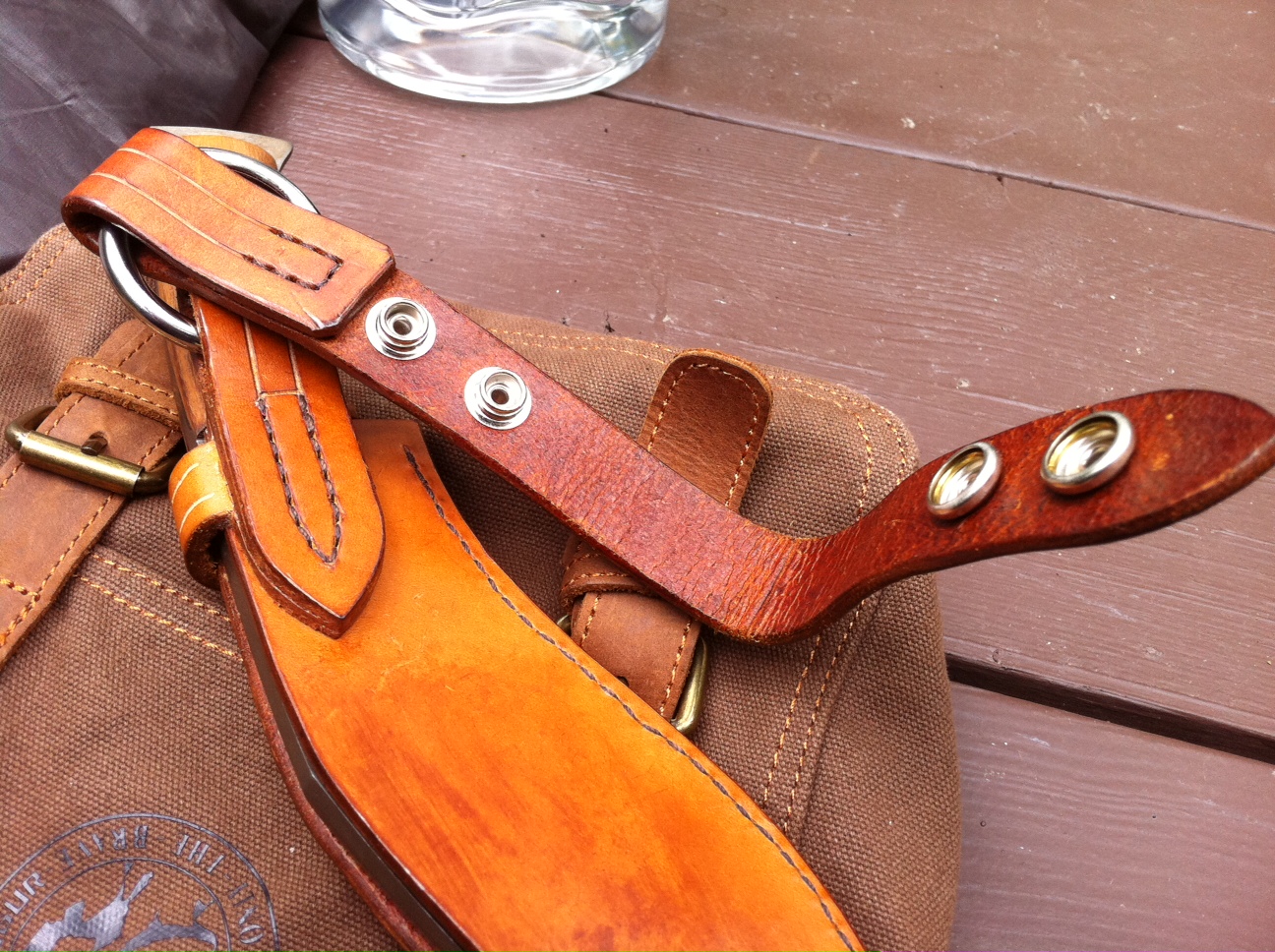

I may be a bit confused (been doing taxes and my head is a bit fuddled), but you're gonna wanna rivet or use screw posts to attach the loop to your Kydex piece anyway. If you screw the leather straight to the sheath it's gonna flop around and annoy the crap out of you due to how low you have to attach on a Kydex sheath. I guess you could stitch it, but I certainly wouldn't wanna drill all those holes myself. If you're talking about the top loop of a setup like WK posted, then stitching should be fine there, though posts or rivets are easier IMO.

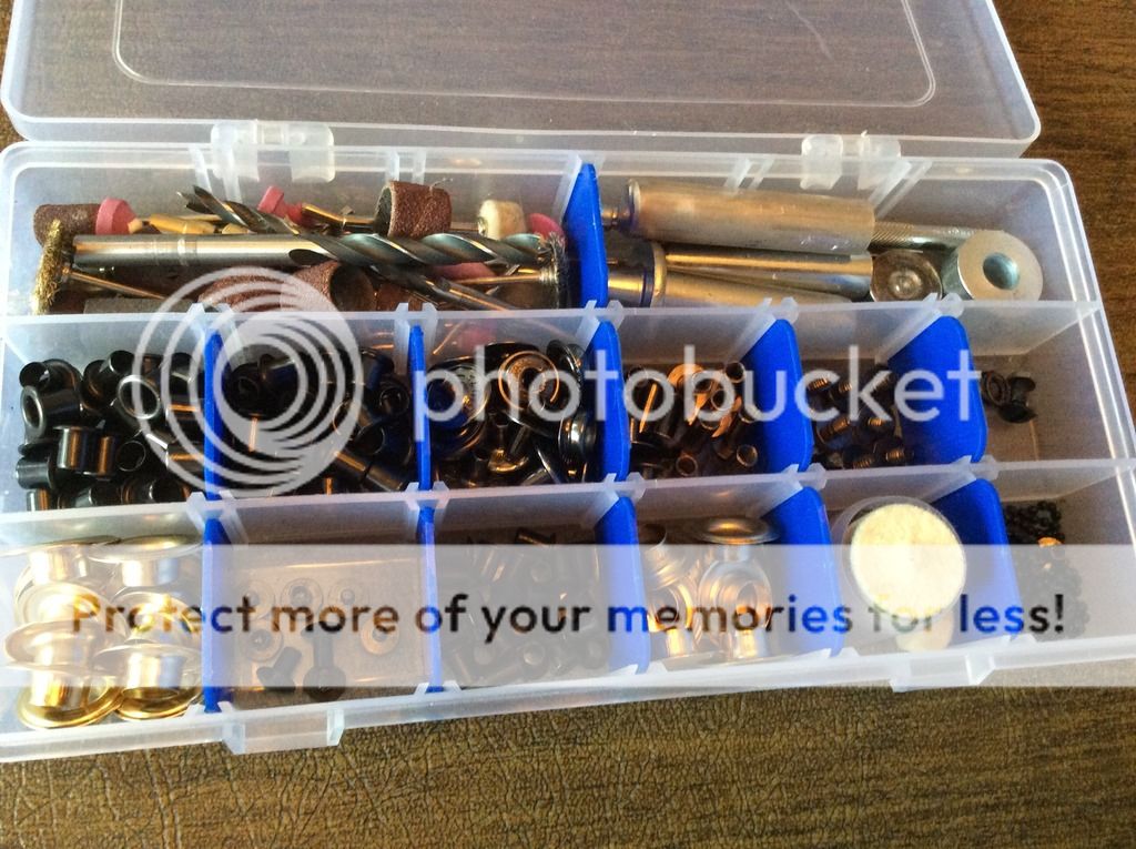

Can I just use standard 1/4 kydex rivets for .080 thickness
Ah, I think we're having a conflict of terminology. You're talking about what I call eyelets, I was thinking more of double cap rivets or such. Eyelets might be alright, but the #8-8 are gonna be too short.
If you just want a straight loop, I'd just grab some screw posts and be done with it. If you're looking to do a two-piece, the rivets or stitching will look a bit better on the top section, but I don't see any advantages beyond that. You'll still wanna take WK's advice on finishing and such if you wanna make it look nice. Just commenting mainly on the Kydex attachment part. The loop in my pic isn't leather, it's coated webbing, but the sheath attachment part should be similar.
So what would I need to do these "rivets". As not sure how good I'm at stitching
Just look on YouTube for "setting double cap rivets" or such. You should see the process and the few things you'd need. Tandy sells their "rapid rivets" with the setter for like $10. You'd need them long enough to reach through your leather and Kydex if you go that route.
